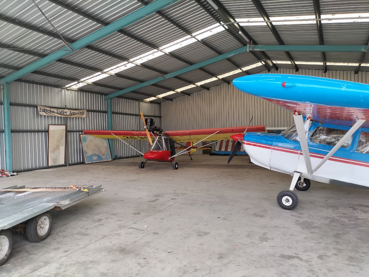

BrendAn Posted December 4, 2021 Share Posted December 4, 2021 One step closer. Wings on at Latrobe valley airport. Inspection and rego next. Then the fun will begin 4 Link to comment Share on other sites More sharing options...

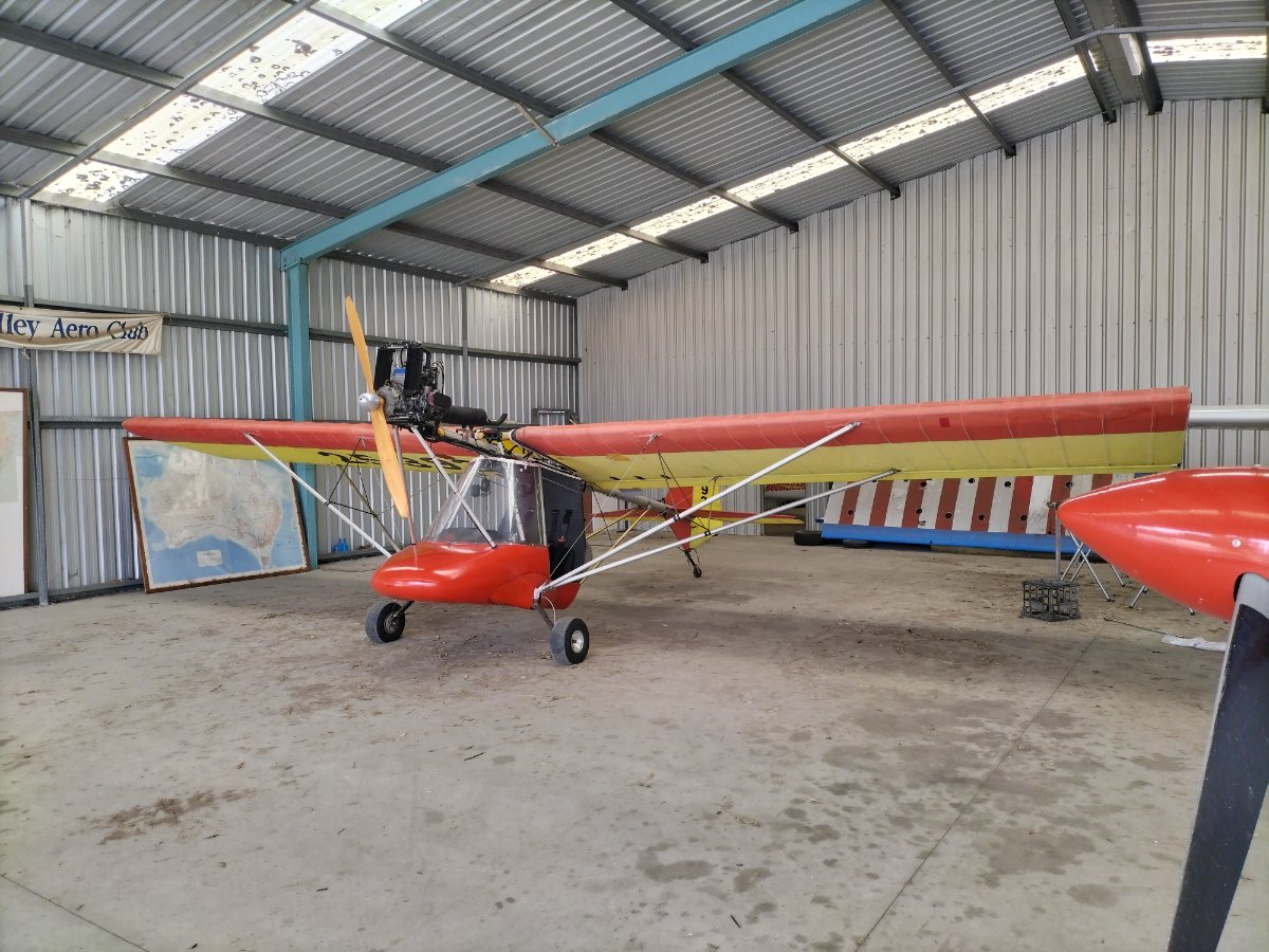

BrendAn Posted December 5, 2021 Share Posted December 5, 2021 16 hours ago, Methusala said: Looks very nice! What diameter is that prop? The pod looks good from a distance. I did a terrible paint job but it can wait . I just want to fly it . Link to comment Share on other sites More sharing options...

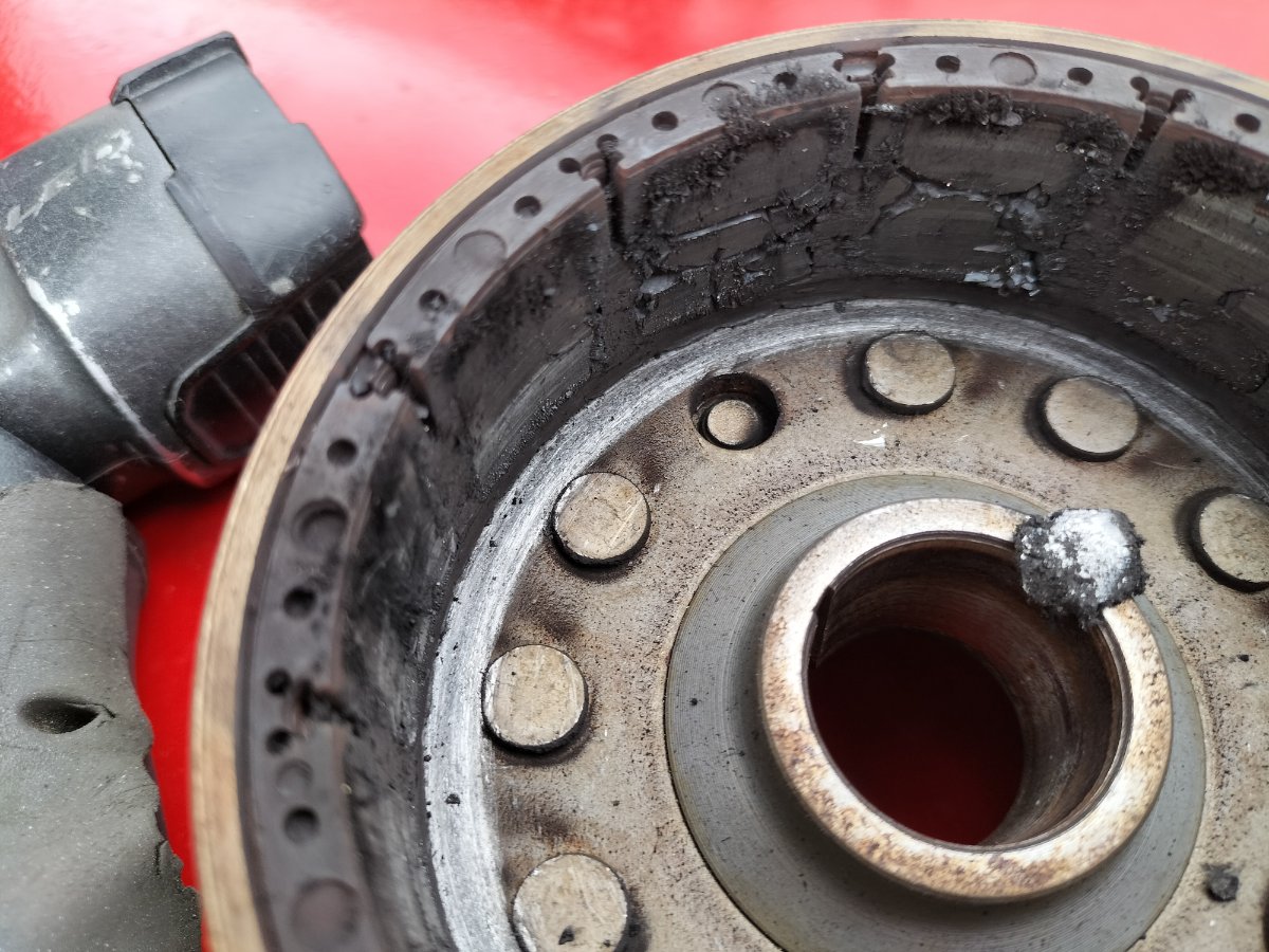

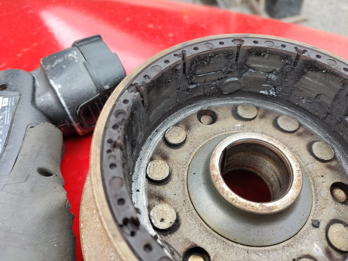

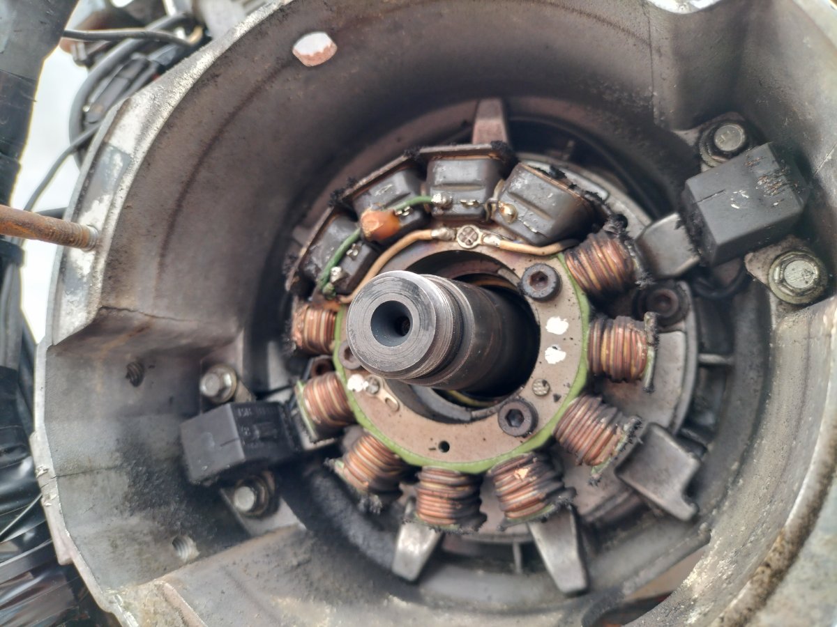

BrendAn Posted December 11, 2021 Share Posted December 11, 2021 Minor setback. We ran the engine up yesterday before the test flight and a piece of magnet or stator broke off and destroyed the flywheel magnets and stator. Should have the new bits this week. What's funny is it still ran perfect . The lame picked up by accident when he wound the prop by hand we could hear something rubbing. 1 Link to comment Share on other sites More sharing options...

BrendAn Posted December 11, 2021 Share Posted December 11, 2021 I have seen outboards do the same thing. Most go forever and some don't. The flywheel was a mission to get off without the right puller. They really lock onto the taper. Link to comment Share on other sites More sharing options...
jackc Posted December 11, 2021 Share Posted December 11, 2021 My Dingo digger with a 23hp Kohler V Twin motor did the same, no reason. $1000 in parts to fix……. 1 Link to comment Share on other sites More sharing options...
BrendAn Posted December 11, 2021 Share Posted December 11, 2021 35 minutes ago, jackc said: My Dingo digger with a 23hp Kohler V Twin motor did the same, no reason. $1000 in parts to fix……. I got lucky. Just got given a good flywheel and stator . 1 Link to comment Share on other sites More sharing options...
