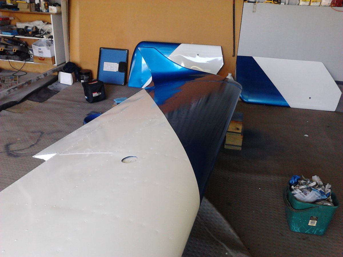

skippydiesel Posted September 21, 2021 Author Share Posted September 21, 2021 (edited) Bruce maaate no longer true - we have water born 2 pack now (at least 7 years) and high volume low pressure (HVLP) application. Larger droplets, less nasty thinners, dont require a clear coat, can be relativly (to old stuff) safely sprayed using the appropriate filters on your mask & a full cover disposable overall (talk to a good paint supply shop). Try and avoided getting any paint type on your skin - water born can be washed off immediately after spraying. You should always have a good in flow of fresh air and an exhaust/extractor fan - not the other way around, as strong air current will have negative impact on paint delivery. I used a cheap Chinese industrial pedestal fan as my extractor and home made plastic shroud, with air in flow through air-conditioning filer panels, to reduce dust/insect impact on my paint job. 2 pack will require a minimum temperature over a stated time for best cure (eg min 22 degrees for 24 hrs) - I used an old reverse cycle window rattler ($40 on Gum Tree), and digital fridge style thermometers (with min max recording function). Air con at floor level , several thermometers at "work" level - set air con when you get a reasonably consistent target temperature - worked like a charm! HVLP gun will need a high volume compressor - not so easy to find, as most are high pressure, relativly low volume (many dont even quote volume). Depending on paint you will be spraying as low as 22 - 30 psi - very different to the old 60+ psi guns. The old systems/guns created very high levels of ultrafine toxic aerosols. HVLP produce larger droplets and much lower levels of fine aerosol. More paint "hits" the target and less floats off into the environment and your lungs. I also understand that paints such as Gasurit 68 are very high in "solids" making it much easier to get good coverage with minimum passes/application and therefor weight. I have used the Stewart System (certified for aircraft) to very good effect/result - never used Glasurit. hence my questions. Why not use Stewart again - cost and no need. The Stewart was used because it was compatible with the fabric/composite airframe. The aluminium airframe I am now looking at doe not require the same level of care/protection. Don't know if true but have been lead to believe, all Australian sourced external/vehicle paints are high in UV resistance. Edited September 21, 2021 by skippydiesel 1 Link to comment Share on other sites More sharing options...
kgwilson Posted September 21, 2021 Share Posted September 21, 2021 I bought a HVLP spray kit off Ebay for just over $30.00 which included 2 guns, 1 for touch up and small items & the other full sized both with gravity fed paint delivery all in a nice blow moulded case. Very good quality guns. I learned to paint from Ebay clips & then my hangar doors. My compressor is a standard 2.5 HP electric with 40 litre tank and easily coped with the job. Pressure around 25 psi and I also installed an in line humidity control device. I used an industrial Dulux 2 pack, Luxathane for the white & Dulux Quantum FX for the metallic blue. The paint wasn't cheap though. The blue cost $450.00 for 4 litres. Aluminium preparation was with prekote a non toxic replacement for alodine now used in the airline and defence industries and Hichem etch primer. I cut a hole in the back of the hangar & stuck a large industrial extractor fan there & had the hangar front open. Didn't bother with plastic sheeting to make a temporary spray booth. I also chose warm calm days & got no dust or insects stuck on the job. The paint is high gloss and as good as the day it went on in 2014. The blue is especially effective with the medium metal particle size I chose. The coating is hard though and if there are areas of movement it will crack. 8 1 Link to comment Share on other sites More sharing options...
