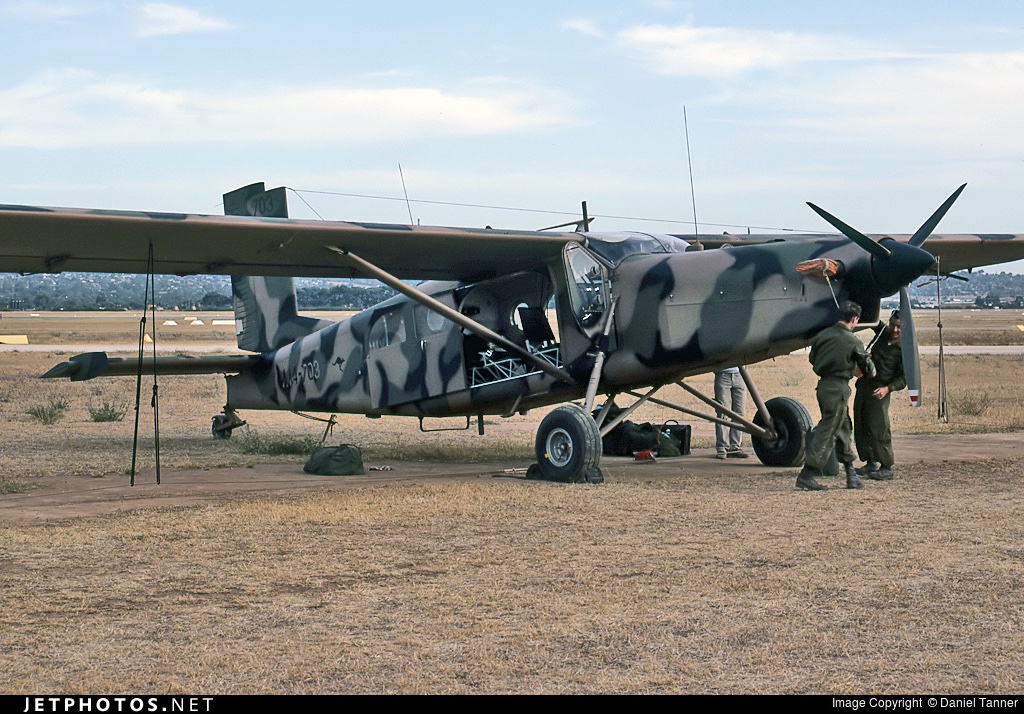

jackc Posted September 29, 2021 Share Posted September 29, 2021 Now for another crazy off the planet paint idea 🙂. My Thruster came with a spare set of skins, I need to somehow get them tested to see IF they are serviceable. IF they are OK I was going to try and ‘paint’ them with this paint scheme. So, any ideas IF this would be doable? Link to comment Share on other sites More sharing options...
skippydiesel Posted September 29, 2021 Author Share Posted September 29, 2021 No idea Jack - I would guess, it would be desirable to know that the solvents in the paint didn't "eat" the fabric (chemical compatibility) and that the paint used, had sufficient plasticisers to flex (rather than crack) with the fabric. 1 Link to comment Share on other sites More sharing options...
