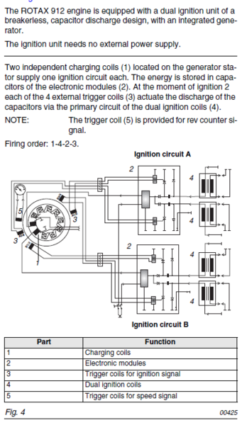

pluessy Posted October 12, 2021 Share Posted October 12, 2021 self-energised CDI, power is only required for the soft-start modules (ignition retard during cranking): 1 1 Link to comment Share on other sites More sharing options...
F10 Posted October 12, 2021 Author Share Posted October 12, 2021 (edited) Ok, so no external power required. Seems to confirm why no issue is made in manuals about external power. I have always found this system complex, being an old magneto/distributor/coil/contact breaker man! Edited October 12, 2021 by F10 Link to comment Share on other sites More sharing options...
