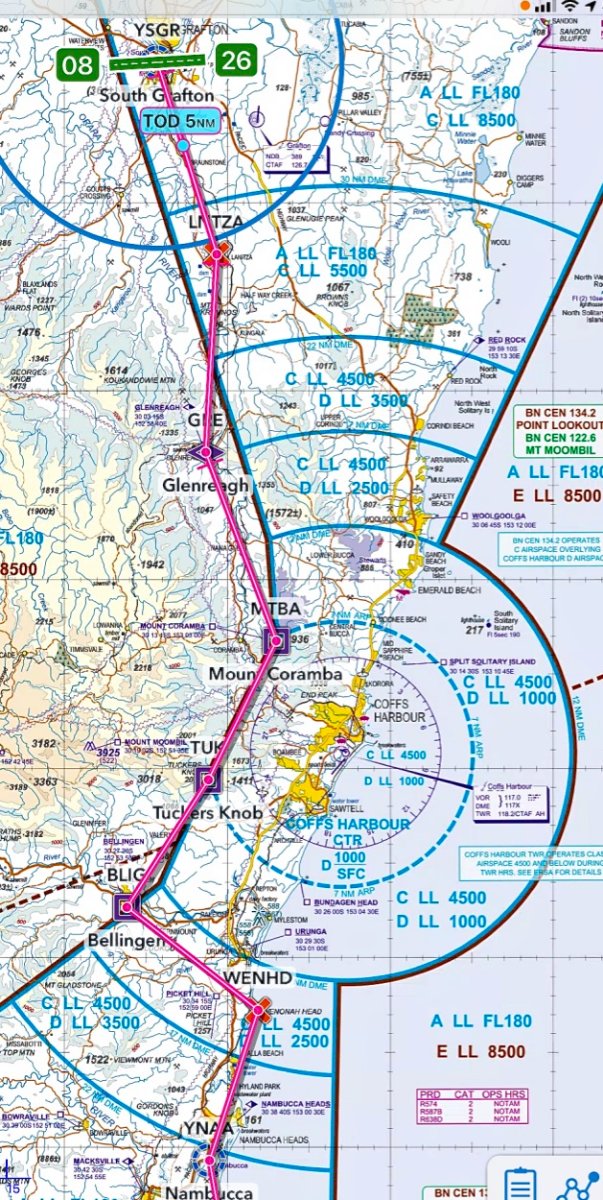

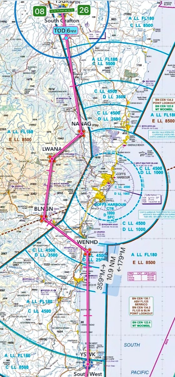

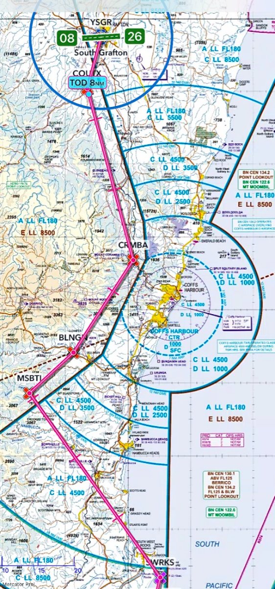

Garfly Posted October 21, 2021 Author Share Posted October 21, 2021 (edited) 22 hours ago, mkennard said: That was Coffs wasn't it? That would be nice as well to be able to transit their airspace somehow. Speaking of getting past Coffs ... on the assumption that a clearance to track coastal abeam YCFS was un-gettable, (not to say unavailable) I've been researching some route options through the hilly country to the west. Of course, it depends upon WX on the day but I was wondering which track might minimise the hostile terrain below. Checking out Google Earth it did appear that the farmland valley running north-south just north-east of Bellingen might be as good as any (cutting across to Nana Glen [northbound] near Lowanna, following the power lines.) But any comments or suggestions from those familiar with the area would be welcome. A few options: (click on each image for some more detail) Edited October 21, 2021 by Garfly Link to comment Share on other sites More sharing options...

mkennard Posted October 21, 2021 Share Posted October 21, 2021 2 hours ago, Garfly said: Speaking of getting past Coffs ... on the assumption that a clearance to track coastal abeam YCFS was un-gettable, (not to say unavailable) I've been researching some route options through the hilly country to the west. Of course, it depends upon WX on the day but I was wondering which track might minimise the hostile terrain below. Checking out Google Earth it did appear that the farmland valley running north-south just north-east of Bellingen might be as good as any (cutting across to Nana Glen [northbound] near Lowanna, following the power lines.) But any comments or suggestions from those familiar with the area would be welcome. A few options: (click on each image for some more detail) From memory I chose option 1 to keep maximum altitude during the flight. Option 2 is too close to trust your GPS and option 3 is too low and putting trust in the GPS again I think. 1 Link to comment Share on other sites More sharing options...

kgwilson Posted October 21, 2021 Share Posted October 21, 2021 20 hours ago, Garfly said: Speaking of getting past Coffs ... on the assumption that a clearance to track coastal abeam YCFS was un-gettable, (not to say unavailable) I've been researching some route options through the hilly country to the west. Of course, it depends upon WX on the day but I was wondering which track might minimise the hostile terrain below. Checking out Google Earth it did appear that the farmland valley running north-south just north-east of Bellingen might be as good as any (cutting across to Nana Glen [northbound] near Lowanna, following the power lines.) But any comments or suggestions from those familiar with the area would be welcome. A few options: (click on each image for some more detail) A better option is Coastal under 1000. Illegal at this stage for RA but you will be granted this transit most of the time if you call them. Coffs doesn't have a lot of traffic. 1 Link to comment Share on other sites More sharing options...
