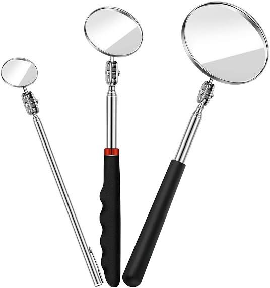

Thruster88 Posted November 26, 2021 Share Posted November 26, 2021 14 minutes ago, turboplanner said: Looks like a Basic structures module with basic engineering pinciples needs to be added to RA maintenance training. CASA schedule 5, mirror, torch and pen. Works on all aircraft. CASA Schedule 5 came into being many years ago to address a specific identified unsafe condition, when light aeroplanes imported into Australia either had no manufacturer's maintenance schedule, or had an inadequate maintenance schedule. 1 1 Link to comment Share on other sites More sharing options...
turboplanner Posted November 26, 2021 Share Posted November 26, 2021 49 minutes ago, Thruster88 said: CASA schedule 5, mirror, torch and pen. Works on all aircraft. CASA Schedule 5 came into being many years ago to address a specific identified unsafe condition, when light aeroplanes imported into Australia either had no manufacturer's maintenance schedule, or had an inadequate maintenance schedule. Eyeball use would be very good, for an Engineer. Given that RAA considers under Self Administration that a shop assistant can not only build an aircraft, but maintain it, so has no understanding of structural engineering, and what is being described here is the equivalent of (the previous owner or "someone") taking a chainsaw, sitting on a limb and cutting it on the truck side, there needs to be some training in what to use the above instruments for. A cable tie is perfectly OK for a non structural application such as attaching electrical cable to a tube, but not to replace a weld which completes triangulation of a fuselage. 2 1 Link to comment Share on other sites More sharing options...
