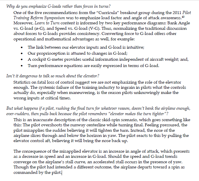

djpacro Posted December 11, 2021 Share Posted December 11, 2021 Quote Upset prevention and recovery training (UPRT) has been developed during the last decade to address the category of accidents ascribed to loss of control in-flight (LOC-I). Rich Stowell, considered a “father” of UPRT, looks at another way to approach LOC-I mitigation with a webinar presented by Aviation Performance Solutions (APS), “Learn to Turn: Laying the Foundation for Proper Upset Prevention and Recovery Training Skills.” from https://www.flyingmag.com/aps-webinar-featuring-learn-to-turn-rich-stowell/ Quote Released to the aviation community in September, the free Learn to Turn program takes a stick and rudder approach to reducing loss of control. This webinar focuses on increasing awareness of the consequences of your control inputs and describing training exercises designed to improve your basic flying skills. Master Instructor Rich Stowell shares tips and techniques that will help you be a better and safer pilot. from https://www.aopa.org/training-and-safety/air-safety-institute/implementing-learn-to-turn-with-rich-stowell 1 1 Link to comment Share on other sites More sharing options...

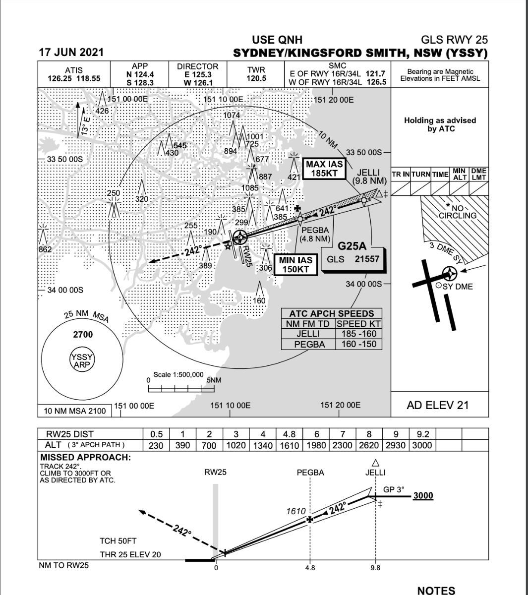

Garfly Posted January 22, 2022 Share Posted January 22, 2022 I wonder if this has ever happened on Victor One which follows the Sydney coast underneath finals for RWYS 34 and 25 1 Link to comment Share on other sites More sharing options...
facthunter Posted January 22, 2022 Share Posted January 22, 2022 25 might be more of a possibility but you should be well below any likely normal approach done on those runways. Nev Link to comment Share on other sites More sharing options...

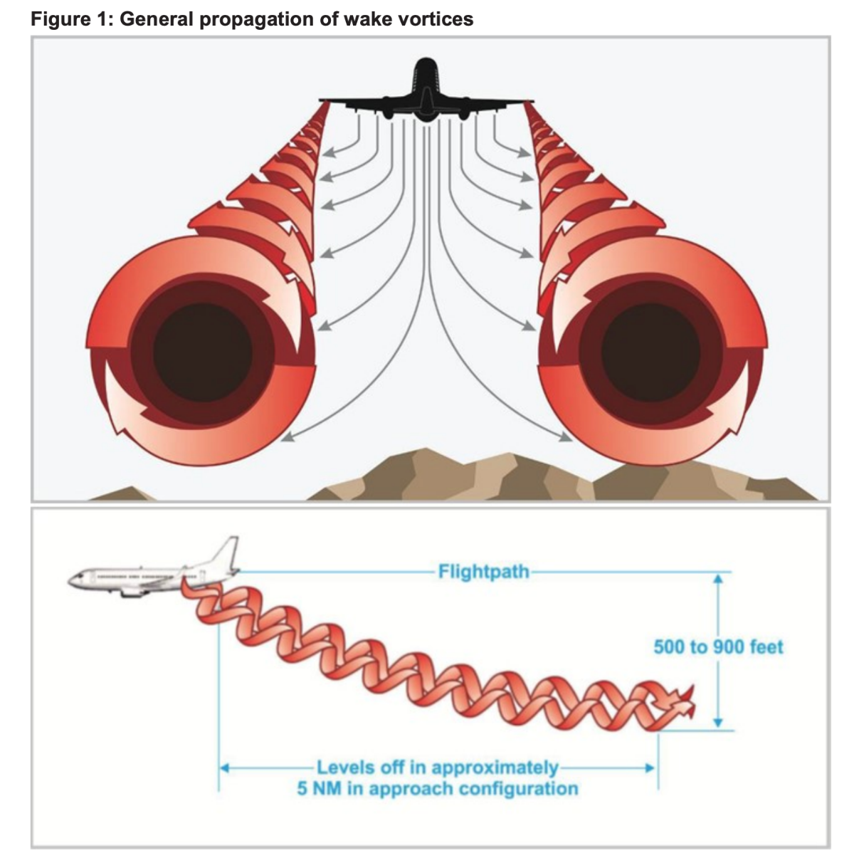

Garfly Posted January 22, 2022 Share Posted January 22, 2022 (edited) About 1000'? (2-3 minutes sink time?) [Click to expand.] Edited January 22, 2022 by Garfly Link to comment Share on other sites More sharing options...
facthunter Posted January 22, 2022 Share Posted January 22, 2022 Yes and I think that SHOULD be enough . Vortices continue at just below the same height they were generated and gradually dissipate. In calm air they last longer and move with the prevailing wind in any case, so that might bring some of the later approach path turbulence your way in some conditions. Worth considering I suppose but you'd have to be unlucky. Anytime you are moving in air with heavies you should be aware of where they have been in 3 dimensions and the effect (like a puff of smoke) moves with the airmass. Nev 1 2 Link to comment Share on other sites More sharing options...

Garfly Posted January 22, 2022 Share Posted January 22, 2022 (edited) 17 minutes ago, facthunter said: Yes and I think that SHOULD be enough . Vortices continue at just below the same height they were generated and gradually dissipate. In calm air they last longer and move with the prevailing wind in any case, so that might bring some of the later approach path turbulence your way in some conditions. Worth considering I suppose but you'd have to be unlucky. Anytime you are moving in air with heavies you should be aware of where they have been in 3 dimensions and the effect (like a puff of smoke) moves with the airmass. Nev Yes, according to this ATSB diagram it looks like you'd just sneak under the worst of it. Still, if you saw a heavy crossing on final a mile or two ahead of you I guess it'd be wise to do an orbit or two (and be just in time for the next one ;- ) https://www.atsb.gov.au/media/5775610/ar-2017-011-final.pdf Edited January 22, 2022 by Garfly Link to comment Share on other sites More sharing options...
Garfly Posted January 22, 2022 Share Posted January 22, 2022 (edited) 20 minutes ago, turboplanner said: I don't know but the traffic lanes I suspect are planned with a separation distance. Yes, there is a note in ERSA about it. I was wondering if there'd ever been an incident but I can't find reference to any. It seems that all the wake turbulence incidents at YSSY have involved aircraft taking off or landing there. [Click to expand] Edited January 22, 2022 by Garfly Link to comment Share on other sites More sharing options...
facthunter Posted January 22, 2022 Share Posted January 22, 2022 If it goes below the aircraft at 500 to 900 feet there'd be some houses near aerodromes with the doors blown off. Also holding at the holding point as a heavy lands you don't get much effect. I can't ever recall any effect except engine noise. I think the illustration is far from scientific. The vertical displacement of the air is the result of lift. The swirling comes from the flaps outside corners and/ or the wingtips and is due to the crudeness of "non feather" wings and causes the high drag in the full flapped and slow, configuration. The diameter of the swirling air gets larger as it gets further and with time from the plane and loses energy. Nev 1 1 Link to comment Share on other sites More sharing options...
