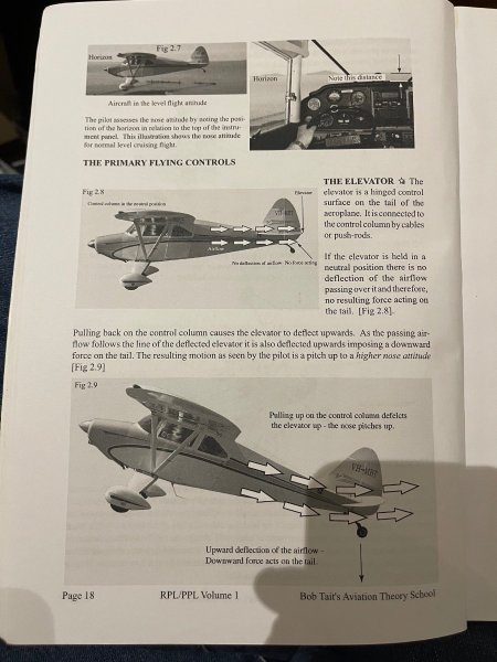

APenNameAndThatA Posted August 6, 2022 Author Share Posted August 6, 2022 (edited) On 10/12/2021 at 11:37 AM, Garfly said: I don't think I've ever known an instructor to 'teach' that pulling back on the stick (always) makes you go up. Lived experience does, though, because it mostly works that way. But that's the whole point, I suppose, of upset recovery training; unlearning ingrained muscle memory. It's like advanced driver training teaches that more braking ≄ more stopping, in all situations. Yet we still hear of even very experienced pilots pulling back in panic to save themselves. Anyway, great move to do that course. Im not saying you’re wrong, but this is page 18 of Bob Tait’s Volume 1 of RPL/PPL. “Pulling back on the control column … higher nose attitude” What he said was true except for stalls, spins, spiral dives and inverted flight. It matters because what you learn first sticks. Edited August 6, 2022 by APenNameAndThatA Link to comment Share on other sites More sharing options...

Garfly Posted August 6, 2022 Share Posted August 6, 2022 (edited) 1 hour ago, APenNameAndThatA said: Im not saying you’re wrong, but this is page 18 of Bob Tait’s Volume 1 of RPL/PPL. “Pulling back on the control column … higher nose attitude” What he said was true except for stalls, spins, spiral dives and inverted flight. It matters because what you learn first sticks. I don't see anything amiss with what the book says. It doesn't say "pulling back is what makes you go up". In my experience instructors are always at pains to point out that it's the throttle wot makes you climb - not the elevator (nomenclature notwithstanding ;- ) But yes, some things are drilled into ab initio flyers that do need to be undrilled, a bit, later, but I suppose it could hardly be otherwise. Another example might be the exaggerated fear of banking instilled in beginners (clearly for good reasons). It's often said that excessive bank-shyness can lead to the dangerous habit of ruddering around the base to final turn. In any case, this is why advanced training - such as you did - is such a good idea. I suppose all learning requires some unlearning along the way. After all, what Jupiter is allowed, might not be permitted the cattle. Edited August 6, 2022 by Garfly Link to comment Share on other sites More sharing options...
APenNameAndThatA Posted August 7, 2022 Author Share Posted August 7, 2022 13 hours ago, Garfly said: I don't see anything amiss with what the book says. It doesn't say "pulling back is what makes you go up". In my experience instructors are always at pains to point out that it's the throttle wot makes you climb - not the elevator (nomenclature notwithstanding ;- ) But yes, some things are drilled into ab initio flyers that do need to be undrilled, a bit, later, but I suppose it could hardly be otherwise. Another example might be the exaggerated fear of banking instilled in beginners (clearly for good reasons). It's often said that excessive bank-shyness can lead to the dangerous habit of ruddering around the base to final turn. In any case, this is why advanced training - such as you did - is such a good idea. I suppose all learning requires some unlearning along the way. After all, what Jupiter is allowed, might not be permitted the cattle. What’s wrong is that the book says that pulling back on the stick lifts the nose. It does, except in the emergencies when pulling back on the stick does the opposite. 🙄 Link to comment Share on other sites More sharing options...

Garfly Posted August 7, 2022 Share Posted August 7, 2022 (edited) 58 minutes ago, APenNameAndThatA said: What’s wrong is that the book says that pulling back on the stick lifts the nose. It does, except in the emergencies when pulling back on the stick does the opposite. 🙄 Yes, which is why Perdue in the video above says we must push when we're surprised to find ourselves nose-low hanging from the straps. But any student doing Lesson One "Effects of Controls" will have nowhere, yet, to put that knowledge. Insisting on it so soon would put 'em in a pedagogical spin. In the end, all learning is self-teaching. And no matter what your instructor or text book has said about what the elevator does, it is only your muscle memory that will determine how you act in a crisis. And it's not your instructor who is to blame for your muscles thinking that pulling will make the ground go away. Every $100 hamburger run you've done since passing your test will imbed that idea. As Perdue says you need to do upset training (and re-training) so that your muscles will do the right thing - quick enough - to save the day, in an emergency. Edited August 7, 2022 by Garfly 1 Link to comment Share on other sites More sharing options...

APenNameAndThatA Posted August 9, 2022 Author Share Posted August 9, 2022 On 7/8/2022 at 11:49 AM, Garfly said: Yes, which is why Perdue in the video above says we must push when we're surprised to find ourselves nose-low hanging from the straps. But any student doing Lesson One "Effects of Controls" will have nowhere, yet, to put that knowledge. Insisting on it so soon would put 'em in a pedagogical spin. In the end, all learning is self-teaching. And no matter what your instructor or text book has said about what the elevator does, it is only your muscle memory that will determine how you act in a crisis. And it's not your instructor who is to blame for your muscles thinking that pulling will make the ground go away. Every $100 hamburger run you've done since passing your test will imbed that idea. As Perdue says you need to do upset training (and re-training) so that your muscles will do the right thing - quick enough - to save the day, in an emergency. I agree that there would be nowhere to put it the way things are currently taught, which, IIRC is primary and secondary effects of controls (in the pre-flight briefing) and straight and level fight (in the actual lesson). I suggest that the earliest briefing be about the elevator and main wing, rather than about all the controls. Start by discussing the elevator and the effect on angle of attack. Then mention inverted flight. The discuss the critical angle of attack and stalls. Then mention spins as a special type of stall. Then, during the flight, don't worry about the rudder and ailerons but worry about angle of attack. See how the nose comes up as the AOA increases? Do you want to do a stall? Yes? See how the stick coming back makes the nose go down? On of the flying Youtubers talks about the laws of learning. One of the laws is the law of primacy. That is, what you learn first, you learn best. If you teach the student right from the start that the nose going up when you pull back on the stick is just a special case, they will know it forever. I also agree with what you said about muscle memory. That is important, too. I also mentally rehearse, from time to time, as I am going about my normal day, easing back pressure, and moving the stick forward quickly. The bottom line is that the solution is to start off teaching the elevator rather than beginning with a more superficial treatment of all three controls. Also, if you started off with the elevator and AOA, when you went to teach ailerons, you could explain how the aileron can stall by increasing the AOA and thereby stop the habit of picking up a wing with ailerons before the habit started, or at least start down that path. 2 Link to comment Share on other sites More sharing options...
