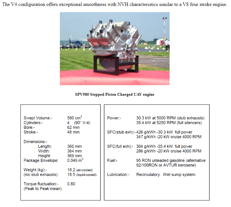

The Higgs engines show a lot of promise, with simplicity, light weight, multifuel capabilities, and high HP for weight - without major design complexity.
They simply utilise a second piston below the main piston to supercharge the inlet mixture, and utilise porting, a la all 2 strokes. The supercharging of the intake charge is the crucial feature of the design.
As with all new designs, extended testing is needed to find the "bugs" in the design. Adequate and efficient sealing, of pistons and sump, comes to mind, straight up.

You can't supercharge a conventional 2 stroke but you can scavenge it. if you have some positive pressure. Oil dilution is a common problem in diesels and they go to more trouble with Piston rings than petrol engines do.. The GM had Poppet valves for the exhaust so could arrange nonsymmetrical timing to a small extent.. 2 strokes get heat on the piston every revolution and tend to melt holes in the top of the pistons. Meeting environmental standards has been a show stopper..Nev
My beef was about the Higgs engine being called a compression ignition engine. If it needs spark plugs to ignite the fuel it is not compression ignition.
The use of the term "Diesel" relating really means an engine running on the design of Diesel, the German engineer who built the original compression ignitiion engines.
  • Agree 2
You can supercharge a two stroke if its using a second pumping piston of greater volume than the firing piston.
For my dream list on supercharged spark ignition two stroke engines that have actually flown I would take the Bernard Hooper stepped piston engine ... 580cc v4 = 30kw/40hp in a flying engine water cooled at 18.9kg.
Give me two of those on a slippery two seater ultralight with a belt redrive and I will be happy ... a LongEzi with these as a set of twins would be really nice or one of them on a sapphire ... 27hp cruise on 7LPH of avtur sounds nice
