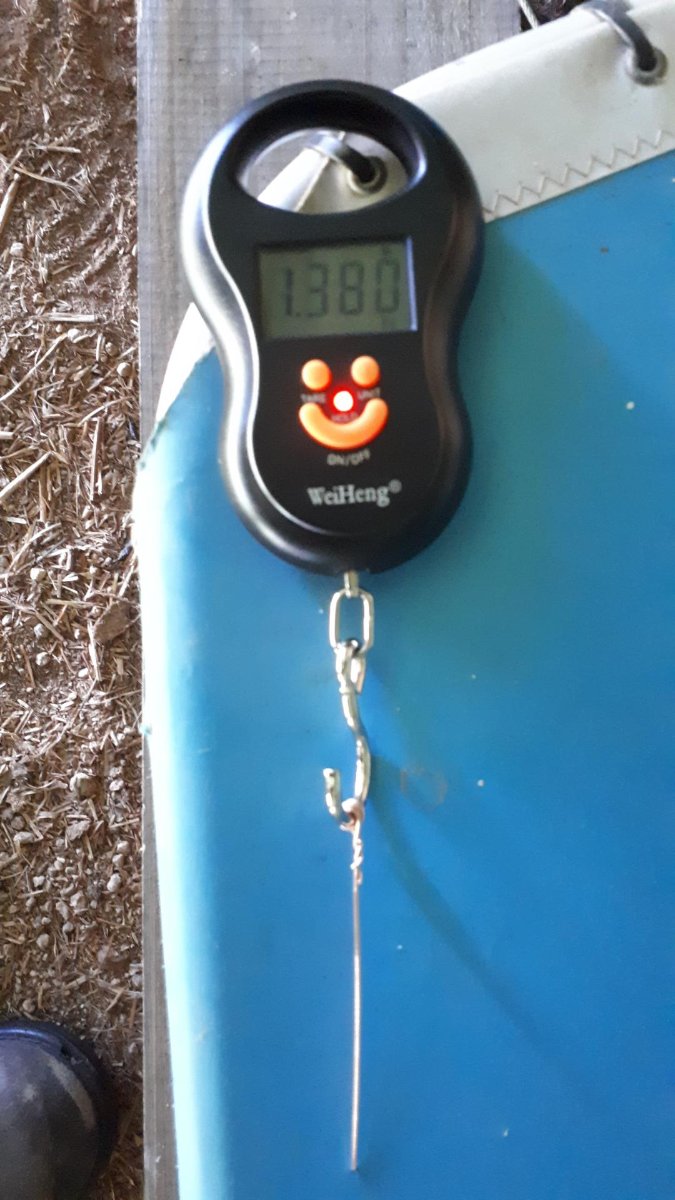

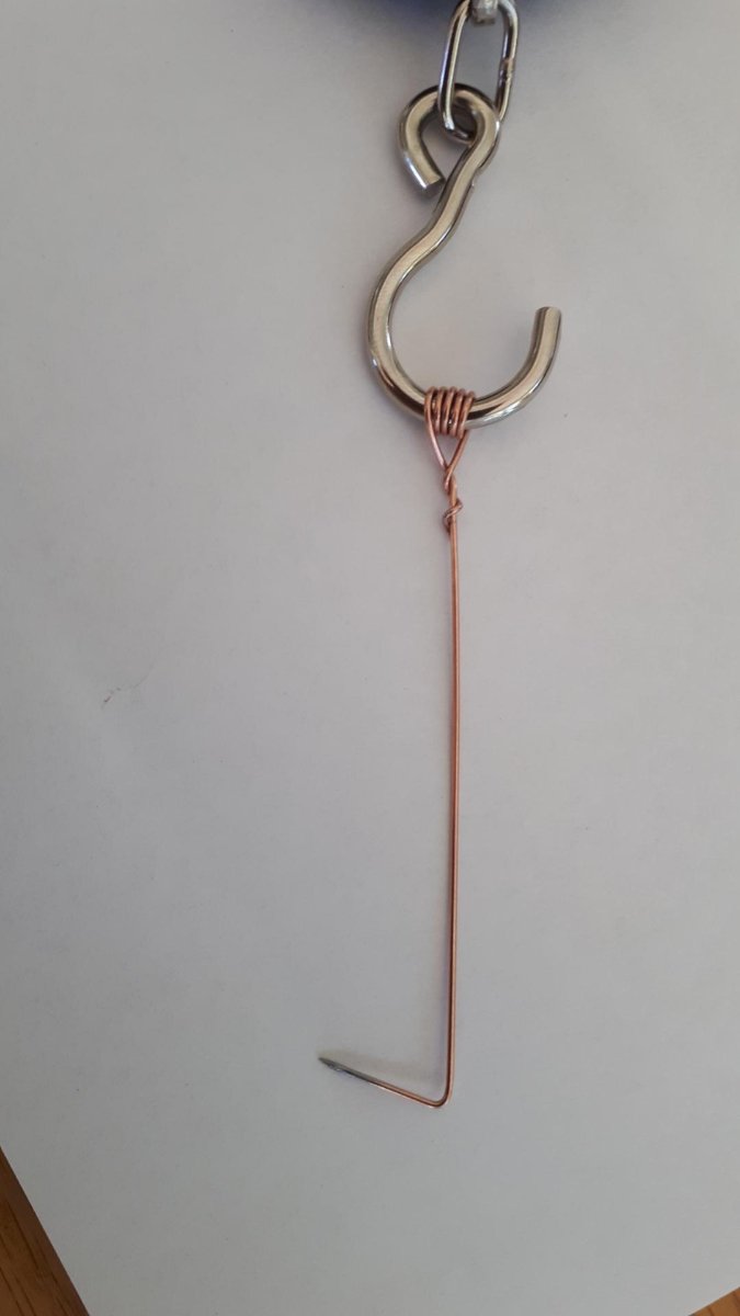

Thruster88 Posted December 31, 2021 Share Posted December 31, 2021 Made up a bettsometer using a $9.75 ebay electronic scale and some 0.9mm mig wire for the hook. Pull for dacron appears to be 3lb or 1360g on the fabric and stitching. Tested my recent purchase which passed easily, whent double no problem. 3 Link to comment Share on other sites More sharing options...
Keenaviator Posted January 1, 2022 Share Posted January 1, 2022 Is the diameter of the Betsometer needle .9mm? Link to comment Share on other sites More sharing options...
Thruster88 Posted January 1, 2022 Author Share Posted January 1, 2022 50 minutes ago, Keenaviator said: Is the diameter of the Betsometer needle .9mm? Should be 0.045 inch or 1.1 mm. Will get some 40 stainless lock wire when next at work. 1 Link to comment Share on other sites More sharing options...
Keenaviator Posted January 1, 2022 Share Posted January 1, 2022 (edited) Your fabric must be in excellent condition to handle 1380 grams @ .9mm then 🙂 I wouldn't have thought Thruster fabric would be as heavy as the top surface of a trick wing. Regards, Laurie Edited January 1, 2022 by Keenaviator 1 1 Link to comment Share on other sites More sharing options...
