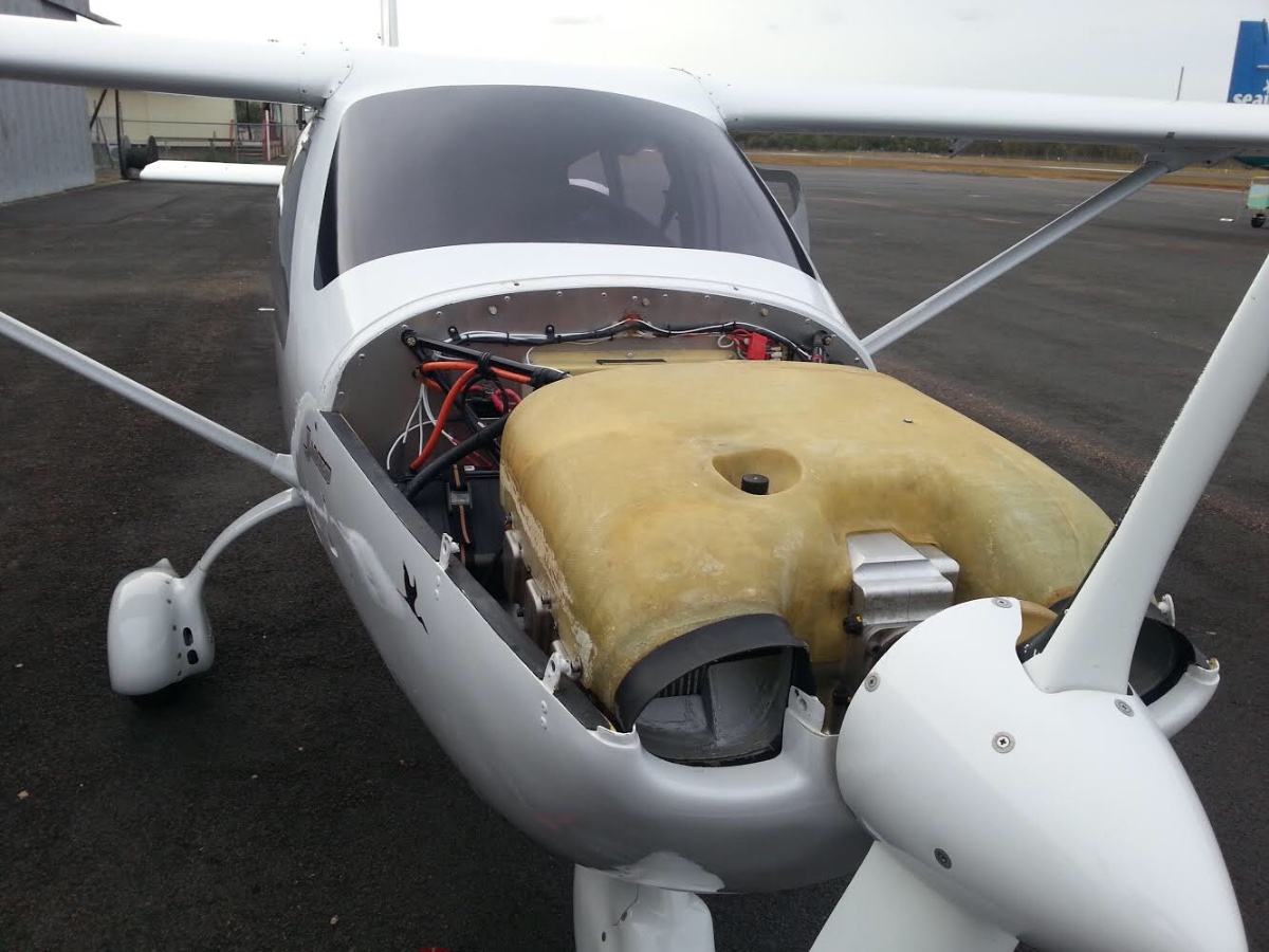

My Rotax 912 ULS aircraft design idol ( Robin Austin) suggested that exit air control, was probably more important, in his World Record aircraft VH- SGS, than inlet sizing. (http://www.worldrecordplane.com/)
My experience with the SK jabiru was that the cooling ducts were not good enough to begin with but after hours of tweaking, they were much better. I still, to this day, watch the temps on climbout and do the things skippy says if needed on a hot day. Keeping the CHT's under 160 C is the aim.

I liked the stuff I saw using tufts because it showed the airflow to not even be in the expected direction, but in the end, my tool was just a water U tube. the ends of the tubes were in the ducts or the lower cowl, and the U part was in the cockpit.
It was these readings which finally explained why the RHS ran cooler than the LHS, and I got rid of some of the difference by connecting the 2 ducts with a bit of vacuum-cleaner hose. Yes the difference was counter-intuitive.
After figuring that the prop was going upwards past the LHS ( as seen sitting in the cockpit ) I tried "eyebrow" fairings at the duct entrance on the upper cowl to deflect air in but these did exactly nothing. They were just taped on, so their removal was easy.
The standard thing to do on a Jabiru is to put a skirt on the lower cowl exit, and this works but it must increase the drag. I did a very small skirt and it sure helped.

…in the end, my tool was just a water U tube. the ends of the tubes were in the ducts or the lower cowl, and the U part was in the cockpit.
Several people have used a tube to join the two side, but this design goes further:
