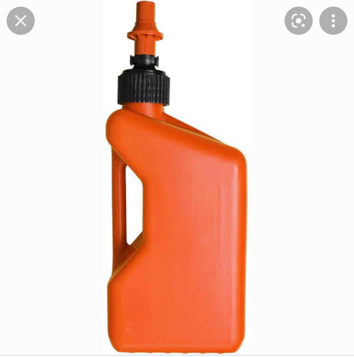

You can get jerry cans that you tip upside down, and the weight of the fuel opens the tap. Very little spilling. This one is called a Tough Jug. I can’t vouch for the quality. I was looking for a pic because people were mentioning jerry cans and electric pumps. This is an alternative to a normal jerry can. One advantage of this is that the aircraft supports the weight of the jerry can while the fuel flows.
Certainly reduces the chance of spillage.
At near $100 you could have an electric pump.
Resembles the 10L 2/ can I have for our chainsaws etc
If only 10L its going to take a lot of cans to do the job
If 20L still have the problem of lifting (especially for high wings)
Not so good on (near) vertical fill points
Wouldn't want to carry fuel in the aircraft - likely to vent at altitude and may not be 100% spill proof if falls over
