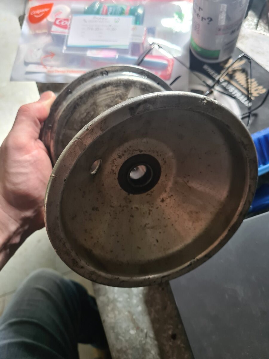

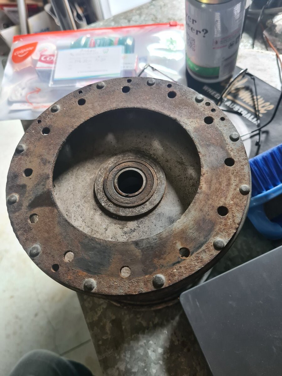

Peasant_Pilot Posted March 13, 2022 Share Posted March 13, 2022 Afternoon, looking to try and find replacement discs to suit these rims. They are a 6" rim and the discs are press riveted, but struggling to identify the rim type or where to get information about the discs etc. If anyone has any info they could share it would be much appreciated. Link to comment Share on other sites More sharing options...
Thruster88 Posted March 13, 2022 Share Posted March 13, 2022 The rim looks like a dirt kart item. Bitumen track karts use 5 inch wheels and dirt track types are 6 inch. https://edwardskartwheels.com.au/collections/dirt-kart-wheels I have bought these for the thruster. The disk I am guessing is custom made, you could get them made at an engineering shop perhaps. Link to comment Share on other sites More sharing options...
turboplanner Posted March 13, 2022 Share Posted March 13, 2022 21 hours ago, Peasant_Pilot said: Afternoon, looking to try and find replacement discs to suit these rims. They are a 6" rim and the discs are press riveted, but struggling to identify the rim type or where to get information about the discs etc. If anyone has any info they could share it would be much appreciated. What about machining those discs? Link to comment Share on other sites More sharing options...
Peasant_Pilot Posted March 14, 2022 Author Share Posted March 14, 2022 10 hours ago, Arron25 said: I take it you have contacted Helmut? Thanks mate, i ended up speaking with Helmut, he has been very helpful over the past few weeks. Link to comment Share on other sites More sharing options...
Peasant_Pilot Posted March 14, 2022 Author Share Posted March 14, 2022 10 hours ago, turboplanner said: What about machining those discs? I was going to do just that but one is warped really badly, according to foxcon he just has them laser cut out of mild steel, im doing up a cad file for it now and ill either make some up myself or get some blanks cut etc 2 Link to comment Share on other sites More sharing options...
Peasant_Pilot Posted March 14, 2022 Author Share Posted March 14, 2022 On 13/03/2022 at 1:39 PM, Thruster88 said: The rim looks like a dirt kart item. Bitumen track karts use 5 inch wheels and dirt track types are 6 inch. https://edwardskartwheels.com.au/collections/dirt-kart-wheels I have bought these for the thruster. The disk I am guessing is custom made, you could get them made at an engineering shop perhaps. Thanks for the info mate, really appreciate it hey, the discs ill either get laser cut or machine some up myself Link to comment Share on other sites More sharing options...
