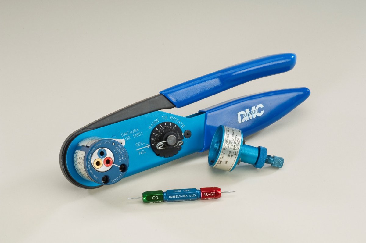

kiwiaviator Posted March 25, 2022 Share Posted March 25, 2022 I'm looking at making up a basic loom with pin and socket contacts in DB connectors. The equipment manual recommends using a DMC AFM8 crimping tool (meets MILSPECM22520/2-01) The problem is that the price for these crimpers is similar to the GDP of a small country. There are some cheaper ones on Aliexpress however before I commit to a purchase, I just want to see what others do to get high quality crimps. DMC product pictured. Link to comment Share on other sites More sharing options...

FlyBoy1960 Posted March 25, 2022 Share Posted March 25, 2022 the cheap ones are crap and barely do the job. mil spec doesn't mean everything you think it does. Sure it gives you specifications for what the tool or product is meant to do but it also refers to other specifications like operations and use. A cheap one may last 1000 crimps where the one indicated may last 100,000 crimps. You get what you pay for with everything in life. I paid nothing for my first wife and I got nothing in return 2 Link to comment Share on other sites More sharing options...
IBob Posted March 25, 2022 Share Posted March 25, 2022 (edited) https://nz.element14.com/aim-cambridge/24-8643p/crimp-tool-d-sub-26-20-awg/dp/2357846?gclid=CjwKCAjwrfCRBhAXEiwAnkmKmR9Dghvc4buz01hKBXI1fSHAO_UaJX5kOL645VXhEovkisdvGX8ExBoCtJ8QAvD_BwE&CMP=KNC-GNZ-SHOPPING-PMAX-2357846 Crimp tool D sub 26-20 from Element14, about $70.....or borrow mine. Does the job just fine. The 26-20 is the range of wire gauges. Part of the reason for the high price of the industry ones is that they have fittings for, and can be adjusted to work with a much wider range of wire sizes (and pins?) But you don't need that flexibilty: D-sub is one size and length of pin that accepts a small range of wire sizes. Edited March 25, 2022 by IBob 1 1 1 Link to comment Share on other sites More sharing options...
Blueadventures Posted March 25, 2022 Share Posted March 25, 2022 2 hours ago, Blueadventures said: There is, if no one else gives details I'll post later today. I got one, plus two packs of pins as spares (25 to each pack) and 2 of their insertion tools. Very reasonable price all up. Look up Stienair and look under tools. They are a good looking aircraft maintenance company. The 4 way crimp tool is $38 USD. Good to deal with. Over to you. 1 Link to comment Share on other sites More sharing options...
onetrack Posted March 25, 2022 Share Posted March 25, 2022 There's a good, lightly used DMC crimper currently up for auction on eBay. It's at USD$21.50 at present, but with 5 days to go, no doubt the final sale price will go up. They seem to sell on eBay, in new or near-new condition, for about USD$300. https://www.ebay.com/itm/255451643628 Be aware that the Stienair USD$38 crimper is an "import". That means possibly from China, or it could be from Taiwan. Chinese tools still lag behind American quality, but Taiwanese tools are generally quite acceptable quality. 1 Link to comment Share on other sites More sharing options...
skippydiesel Posted March 25, 2022 Share Posted March 25, 2022 I used Toledo D Sub crimpers - worked a treat for a one aircraft job. From memory $70 new. Make sure you select the correct tool for the wire gauge - See IBobs comments above. From memory Toledo do three D-Sib type connectors. The smallest are probably what you need - Try Toledo D Sub Crimpers 31024 wire size range AWG 26-20, 2 Link to comment Share on other sites More sharing options...
jetboy Posted March 25, 2022 Share Posted March 25, 2022 be sure you buy the DB pins that work with your chosen crimper, the type you pictured doesnt operate with many of the crimp pins. For a one - off job, soldering might be better. Link to comment Share on other sites More sharing options...
kiwiaviator Posted March 25, 2022 Author Share Posted March 25, 2022 16 hours ago, IBob said: https://nz.element14.com/aim-cambridge/24-8643p/crimp-tool-d-sub-26-20-awg/dp/2357846?gclid=CjwKCAjwrfCRBhAXEiwAnkmKmR9Dghvc4buz01hKBXI1fSHAO_UaJX5kOL645VXhEovkisdvGX8ExBoCtJ8QAvD_BwE&CMP=KNC-GNZ-SHOPPING-PMAX-2357846 Crimp tool D sub 26-20 from Element14, about $70.....or borrow mine. Does the job just fine. The 26-20 is the range of wire gauges. Part of the reason for the high price of the industry ones is that they have fittings for, and can be adjusted to work with a much wider range of wire sizes (and pins?) But you don't need that flexibilty: D-sub is one size and length of pin that accepts a small range of wire sizes. Thanks all for the info. Thanks Bob for the offer to use yours. I might just order the tool off Element 14 as I'll use it a lot more in the future. Link to comment Share on other sites More sharing options...
IBob Posted March 25, 2022 Share Posted March 25, 2022 All good. You'll also need something to strip the wire neatly and precisely: for the D sub pins, you're only taking about 4mm off. If you can find a well made version of this type, they are ideal: https://www.trademe.co.nz/a/marketplace/building-renovation/tools/hand-tools/pliers/listing/3524919310?bof=UX48xEQA I have the cheap knockoff version, and while I was able to adjust them to do the one job correctly, I wouldn't recommend them. 1 1 Link to comment Share on other sites More sharing options...
