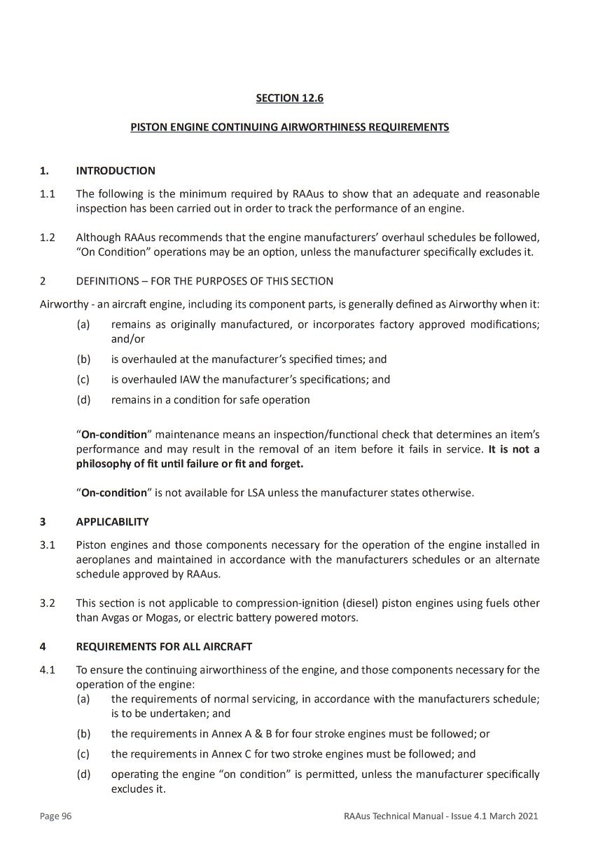

rhtrudder Posted April 11, 2022 Share Posted April 11, 2022 Wondering what’s involved in flying with a engine that has passed TBO, 914 engine in my plane has got 200 hours left , compression hasn’t changed , no more oil consumption, have flown it from 400 hrs to nearly 1800 , $45000.00 to replace it Link to comment Share on other sites More sharing options...
Flightrite Posted April 11, 2022 Share Posted April 11, 2022 I heard a new 915 is just short of $60K! Ouch! An engine doesn’t know it’s close to TBO, don’t mention it to the donk and keep flying😉 Link to comment Share on other sites More sharing options...
rhtrudder Posted April 11, 2022 Author Share Posted April 11, 2022 Wondering where I stand legally Link to comment Share on other sites More sharing options...
turboplanner Posted April 11, 2022 Share Posted April 11, 2022 5 minutes ago, rhtrudder said: Wondering where I stand legally Ask a specialist Public Liability lawyer; they would be the ones suing you if a duty of care applied and something went wrong, so the best to answer the question and give you the correct answer. You should so some reasearch before you go, e.g. What is the CASA definition of "On Condition", "TBO", etc. and other relevant facts. Link to comment Share on other sites More sharing options...
Thruster88 Posted April 11, 2022 Share Posted April 11, 2022 There is an article about this in Australian Sport Pilot #102. If the aircraft is an LSA registered with RAAus the answer seems to be no you cannot run on condition. Registration as an experimental is suggested. In VH land a high percentage of aircraft including those involved in air work, (flying training) are on condition, go figure. Link to comment Share on other sites More sharing options...
skippydiesel Posted April 11, 2022 Share Posted April 11, 2022 Rotax 9 engines had operational hours and calendar time to TBO. My last Rotax 9 (in a 19 aircraft) had 920 hrs operational time out of (if memory serves) 1500 hrs and had long passed they 10 years calendar time it started with - so we had passed TBO a long way back. Engine running like the preverbal sowing machine, leak down tests all good, nil oil consumption between services. 3 hours ago, rhtrudder said: Wondering what’s involved in flying with a engine that has passed TBO, 914 engine in my plane has got 200 hours left , compression hasn’t changed , no more oil consumption, have flown it from 400 hrs to nearly 1800 , $45000.00 to replace it Does not the aircraft category (19 or 24) have a bearing on this? I think 19's can pretty much go as long as the owner wants its to go 24"s , that go over TBO, will loose their training/hire privates and may not be supported by the factory. Link to comment Share on other sites More sharing options...
Garfly Posted April 13, 2022 Share Posted April 13, 2022 Section 12.6 of the RAAus Tech Manual sets out the official position on all that. https://members.raa.asn.au/storage/raaus-technical-manual-issue-41.pdf This is the first page of the section. (Click to expand) 2 Link to comment Share on other sites More sharing options...
