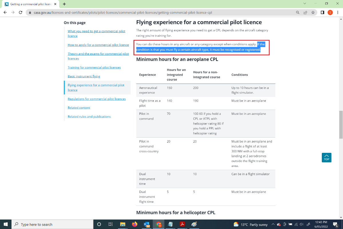

Not trying to be a CASA lawyer here, but their website says:
...If the condition is that you must fly a certain aircraft type, it must be recognised or registered...
Then the table below lists the differences in hours.
Regardless, the CPL flight test will be in a VH aeroplane (the flight test form have pre-written VH- in registration box) and it is also  good to have an experience before the test.
