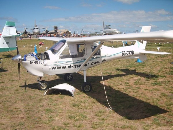

RFguy Posted September 16, 2022 Share Posted September 16, 2022 (edited) The weight issue is only because they're generally made for transport apps that are not weight sensitive. Does anyone know much about the piston engine in the Diesel/JetA Technam ? Edited September 16, 2022 by RFguy Link to comment Share on other sites More sharing options...

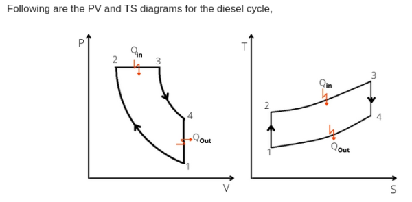

Yenn Posted September 16, 2022 Share Posted September 16, 2022 What is meant by you can't design an Otto engine without an ignition system, or maybe I should ask. What is an ignition system? The Otto cycle includes both normal petrol and diesel systems, Diesels don't have an electrical system for ignition. They compress the charge so that it's temperature becomes hot enough to ignite the diesel, when it is injected. Diesel power is controlled by the amount and timing of injected fuel, whereas petrol power is controlled by the amount of air in the charge and the ratio of petrol to air. The old diesels had a bad reputation for sooty exhaust, which was caused by injecting more diesel than the engine could burn with that air. Old diesels also did run slowly and when Perkins introduced a high speed diesel it was still less than 3000rpm. Over the years i have come to prefer diesels for their ease of operation. No worries with electric ignition, nor with a carburettor, but they are not generally designed for what we need to pull an aircraft along. A friend of mine has flown the twin Diamond with diesels and liked it, but there are not many of them around. Link to comment Share on other sites More sharing options...

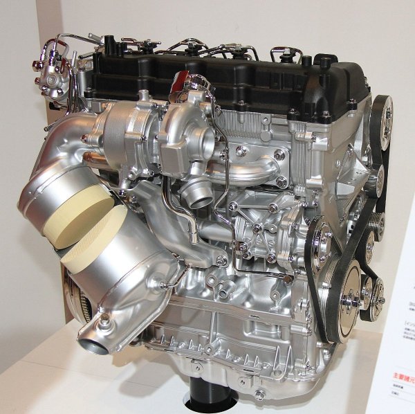

onetrack Posted September 16, 2022 Share Posted September 16, 2022 Weight is always the killer with a diesel engine in a lightweight aircraft. With the upgrade to 760kg MTOW for RA/kit build aircraft, there probably is the potential to fit a small automotive diesel in a light aircraft. To that end, the Subaru EE20 2.0L horizontally-opposed 4 cyl diesel is an attractive option, because it's still relatively light (but still comes in around 170kgs, as I understand), it's turbocharged and intercooled, and the engine layout is comparable to the regular petrol aviation engine design. But it produces its maximum of 150HP at 3600RPM. However, it would be possible to set up the Subaru EE20 to run at say, a maximum of 3300RPM, which would allow for direct drive - but this would reduce the HP output somewhat. Regardless, it would still need to be fitted in a heavier airframe than many current kit-build aircraft, and there would need to be quite a bit of re-engineering of the engine to suit aviation use. The electronic injectors of today have numerous advantages, in that they're more precise with injection, and they carry out multiple injection events over milliseconds, thus reducing diesel knock and vibration. However, diesel engines with direct drive in aircraft need to have a rubberised drive mechanism for the prop, to suppress the bigger power pulses that come from the high-torque power strokes of the diesel. Link to comment Share on other sites More sharing options...

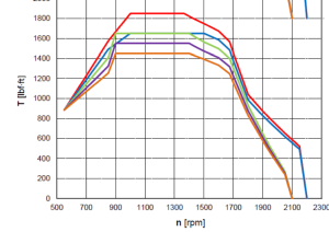

turboplanner Posted September 17, 2022 Share Posted September 17, 2022 (edited) This thread is almost duplicating one we had a couple of years ago. With common rail multipoint injection, diesel engines can pretty much be designed for any application, because the power and torque curves can be designed these days rather than wait to what shows up on the dyno. Diesel will always have a slight weight disadvantage to petrol because of the heavier structure required for the higher compression etc. So if you were designing for an aircraft engine to compete with a Rotax, you would be offesting that by going to direct crankshaft prop attachment. On long distance interstate haulage trucks, some cruise as low as 1100 rpm on full power to push the wind away, and max torque is not far down, to hold speed on hills. So you have the luxury of designing the engine power and torque to suit the cruise rpm requirement for the prop. It's just a matter of someone here throwing a few milion in the ring to produce a batch of say 500 engines. Edited September 17, 2022 by turboplanner 1 Link to comment Share on other sites More sharing options...
RFguy Posted September 17, 2022 Share Posted September 17, 2022 (edited) Turbs, so that prompted me to look at truck torque curves... wow peak torque down around 1000 RPM ! some down at 800 RPM. any reason not to use a automotive torque converter driving a prop ? I have not thought about it much. Edited September 17, 2022 by RFguy Link to comment Share on other sites More sharing options...
turboplanner Posted September 17, 2022 Share Posted September 17, 2022 1 hour ago, RFguy said: Turbs, so that prompted me to look at truck torque curves... wow peak torque down around 1000 RPM ! some down at 800 RPM. any reason not to use a automotive torque converter driving a prop ? I have not thought about it much. You can see from the straight line that its a designed performance. You're basically looking at constant cruise rpm, but a truck and a prop will be at different rpm, the difference just being different design input. By designing that way you're in the optimum for the prop, so don't need any sort of gearing and extra mass. Link to comment Share on other sites More sharing options...
