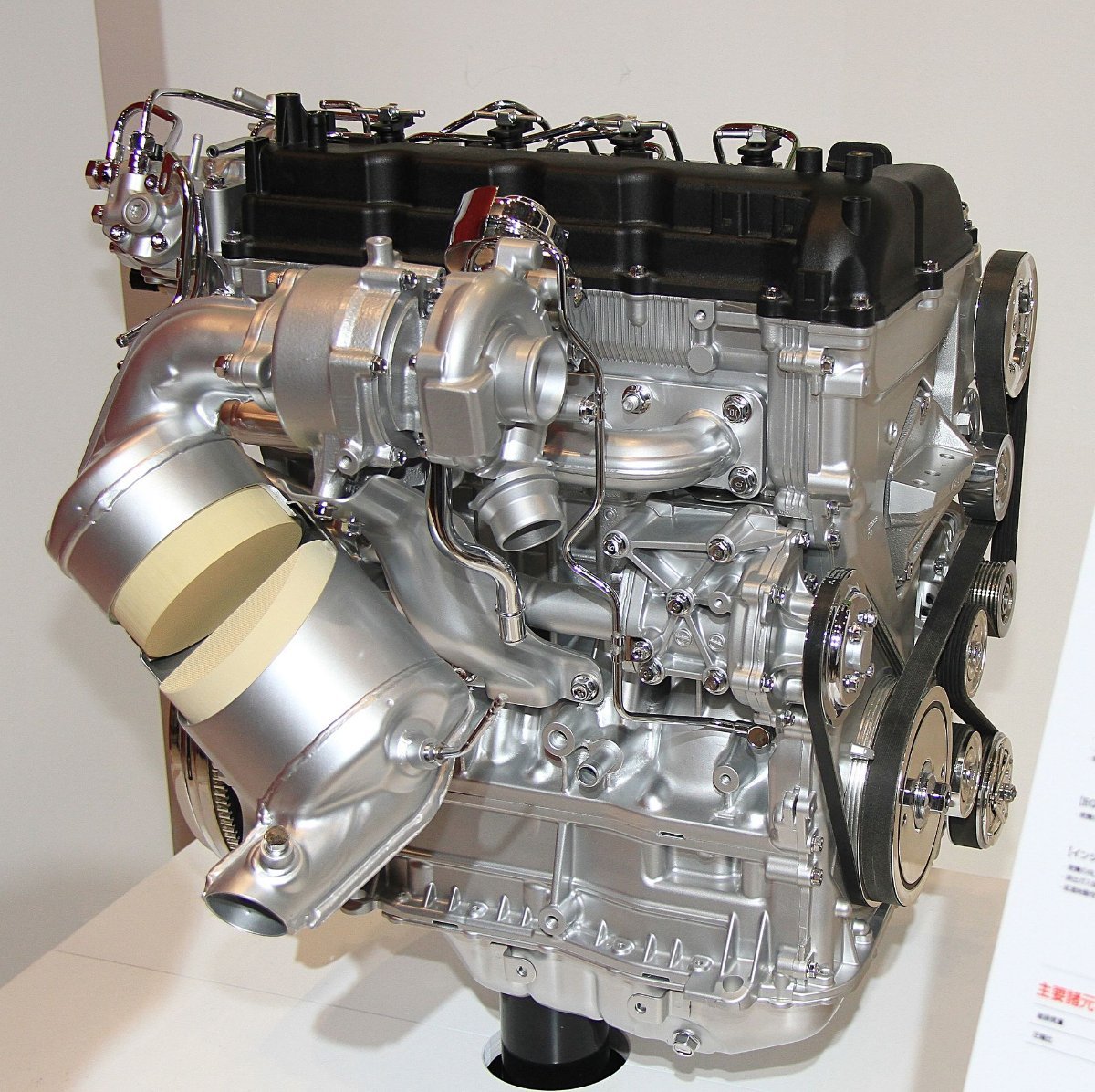

For anyone lusting after a turbo diesel kit plane engine the Mitsubishi Triton  engine, 4N15, in service since 2015 would be a good choice. All aluminium block and head. 430nm@2500rpm = 150hp. 2500 is perfect propeller speed. It weighs 163kg so maybe 185kg installed with cooling.
For comparison the most bullet proof aircraft piston engine on the planet (lyc o-320) weighs 121kg and also produces 150hp@2500rpm.
Given the weight difference and the need to fit a radiator and cooling system to the Mitsubishi, I wonder why people would be looking at diesel?

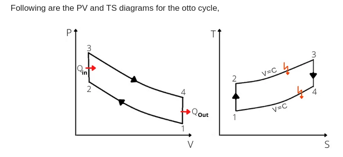

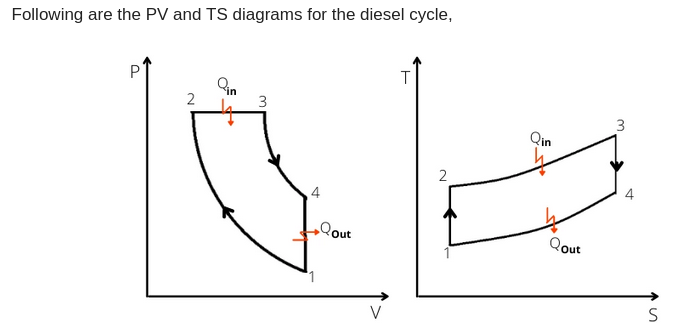

Hi Yenn, think about it, there's a difference between the Otto and Diesel cycle, that's why they each have a name. Notice the differing shapes of the Pressure/Volume diagrams for ideal cycles describing both. The otto cycle requires an external source of ignition because the temperature rise due to compression becomes less when you throttle. A diesel always compressess a constant volume so the pressure rise is constant regardless of throttling.
Rather than explain it read the below.
https://en.wikipedia.org/wiki/Otto_cycle
https://en.wikipedia.org/wiki/Diesel_cycle
And here's an explanation of the difference from where I stole the diagrams. https://mechcontent.com/otto-cycle-vs-diesel-cycle/
Of interest is that the Otto cycle is more efficient than the diesel for a given compression ratio. The diesel cycle is practically more efficient because the higher compression enables a higher combustion temperature, laws of thermodynamics etc. From the wikipedia article.
