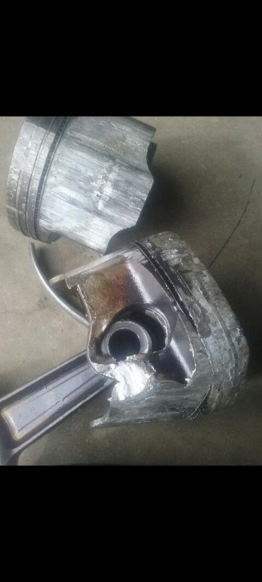

flyhi Posted July 15, 2022 Share Posted July 15, 2022 On 14/06/2022 at 1:52 PM, FlyBoy1960 said: I don't know if that is appropriate when you look at all of the oil stains on the bottom of the aircraft. It looks like a major failure of the engine and there is oil everywhere but if you prefer to say he ran out of fuel, that is okay Ran out of oil alright. Oil filter was missing after landing !!!! 1 2 Link to comment Share on other sites More sharing options...
planedriver Posted July 15, 2022 Share Posted July 15, 2022 WOW! That'll do it every time. 1 1 Link to comment Share on other sites More sharing options...
turboplanner Posted July 15, 2022 Share Posted July 15, 2022 1 hour ago, flyhi said: Ran out of oil alright. Oil filter was missing after landing !!!! Thanks for that; have seen it happen with screw ons on car engines, often though hand tightening then getting phone call etc, missing that last 3/4 turn. 1 Link to comment Share on other sites More sharing options...
BrendAn Posted July 15, 2022 Share Posted July 15, 2022 TS and PS were in the green Link to comment Share on other sites More sharing options...

Thruster88 Posted July 16, 2022 Share Posted July 16, 2022 22 hours ago, BrendAn said: TS and PS were in the green I would love to see what the big end bearing looked like. That piston must have got pretty hot to have that plastic deformation around the gudgeon pin. 1 1 Link to comment Share on other sites More sharing options...
facthunter Posted July 16, 2022 Share Posted July 16, 2022 They need the anti squeak, Otherwise a lot of welding and bending happens. Nev 1 Link to comment Share on other sites More sharing options...
Mike Gearon Posted July 16, 2022 Share Posted July 16, 2022 5 hours ago, MattP said: The combination of sim and pre and post flight briefings can’t be under estimated in your ifr training. Especially for holds and approaches as you can digest some theory, load up the sim, practice the work, have the instructor pause it then brief in the sim and continue as you go, helped me no end in the early stages compared to burning money and fuel in the air trying to get it right. Note I had access to a motion sim for the aircraft I was flying as part of this so immersion was much better than a basic fixed base generic sim but either way they both serve the same purpose. the other advantage of using a sim is home sims like xplane are good enough to practice the theory at home and re enforce the concept. Once you have that stuff click, the real thing becomes much easier. You just have to put up with the small differences in the way they implement some of the gps functionality and work around that, but for manual hold practice it’s not too bad. I also use the home sim to keep my brain in it when I can’t fly as often as I like, and before flights to just ensure I’m mentally there. One thing on the ifr flying aspect is currency is king, it doesn’t matter how many hours you have, if you’re not current and ready to go. I use this as a forcing function to keep as current as possible and fly regularly, or as regularly as time and money permit! Good luck with the training, and don’t forget to enjoy it too. I think the last sentence most important. I have been forgetting to enjoy it. Trying to take pleasure in great take offs and landings with the view out the window while it lasts. Agreed 100% on sim. I don’t think it’s as common in USA outside the large cities. All done in aircraft. Rapid city as example. No chance to sim and people even driving 3 hours from Wyoming to train there. Proficiency. Yes, I’m very confident under hood as of this week. Scan is effortless. I also like the reminder this doesn’t stick. It falls away quickly. I’ve heard a number of pilot stories at Linocln. Great thing with having a hangar I’m right next to the hangar that seems to have a bar in it. Up to 8-10 pilots gathered some late afternoons. Good knowledge soak. IFR training has suffered from 3 moves. Phoenix, Rapid City to Lincoln. Can’t blame anyone for it. I now know what is needed and I work toward that with good instructors. 1 Link to comment Share on other sites More sharing options...
BrendAn Posted July 16, 2022 Share Posted July 16, 2022 4 hours ago, Thruster88 said: I would love to see what the big end bearing looked like. That piston must have got pretty hot to have that plastic deformation around the gudgeon pin. How does an oil filter come loose on a plane. If I wasn't wiring it I would be making sure it was bloody tight. On drill rigs we used to do them tight with a filter strap because the vibration worked them loose. 2 Link to comment Share on other sites More sharing options...

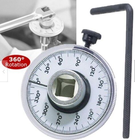

turboplanner Posted July 16, 2022 Share Posted July 16, 2022 There is a torquing procedure used on new era engines which is a little bit different, and could possibly be based on manufacturers records that 'x' million filters had never come loose. The procedure specifies a torque value for a fastener (e.g. Head Bolt) then it requires a dial gauge to be fitted and specifies tghtening a specific number of degrees, tensioning the bolt against its thread. These bolts are discarded after one use. Most spin on oil filters now use the same principle, a lot using "smear oil on seal, screw on until seal contact is made, turn filter an additional 3/4 turn. 2 1 1 Link to comment Share on other sites More sharing options...

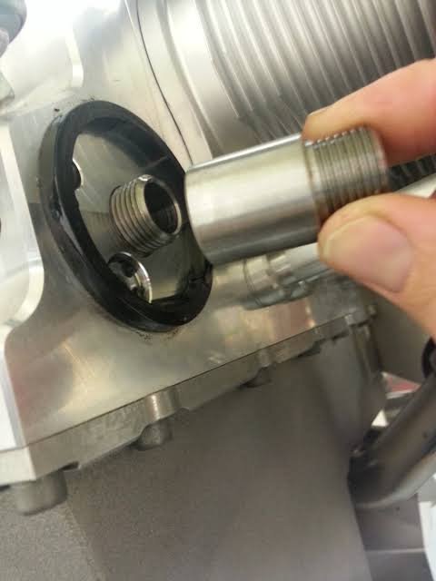

Thruster88 Posted July 16, 2022 Share Posted July 16, 2022 6 hours ago, BrendAn said: How does an oil filter come loose on a plane. If I wasn't wiring it I would be making sure it was bloody tight. On drill rigs we used to do them tight with a filter strap because the vibration worked them loose. The only plausible explanation is if the nipple or oil cooler adapter fitting became substantially un screwed when removing the oil filter. I have seen this on a volvo truck engine, fortunately for me the nipple completely un screwed and remained in the old filter. Picture for example only. 2 2 Link to comment Share on other sites More sharing options...
Blueadventures Posted July 16, 2022 Share Posted July 16, 2022 2 hours ago, Thruster88 said: The only plausible explanation is if the nipple or oil cooler adapter fitting became substantially un screwed when removing the oil filter. I have seen this on a volvo truck engine, fortunately for me the nipple completely un screwed and remained in the old filter. Picture for example only. Also the filters thread could have been incorrect sizing. 1 1 Link to comment Share on other sites More sharing options...
