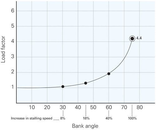

Bruce Tuncks Posted June 26, 2022 Share Posted June 26, 2022 I watched a power failure ( take-off from 23 Gawler) where there was a total power loss at 300 ft and nothing ahead. The pilot rurned 90 degrees and made a good landing in a safe paddock. That stuff about "no more than 15 degrees turn" could have got him killed. In a glider, you can do a 180 CLIMBING turn slowing from 60 to 45 knots. A jabiru loses 200 ft at most doing a similar thing. Try it at a safe height. But I also saw a very heavy landing where a brand-new Sonex tried to do a 270 turn to land back on a runway from a similar position so the advice is not complete crap. 1 Link to comment Share on other sites More sharing options...

Bruce Tuncks Posted June 27, 2022 Share Posted June 27, 2022 I reckon there are some things which may well be correct on heavy planes but do not apply so exactly to the light stuff we fly. But the second pilot ( the one who tried the 270 degree turn from 300 ft in the Sonex) was a recently retired 747 check captain... 1 Link to comment Share on other sites More sharing options...
facthunter Posted June 27, 2022 Share Posted June 27, 2022 The same laws of physics apply to all planes unless they fly supersonic.. The energy levels are much higher. Mass and velocity equals a lot of kinetic energy.. When you are accelerating and decelerating.. A VH or U/L instructor would do more landings in a day than a B 747 driver in a month and on maybe 3 different planes on that day. When you fly the line you don't change the type of plane. You may fly several versions of it. You also have to stop applying characteristics from the plane you flew onto the one you are converting onto.. A complex plane takes about 6 weeks to convert onto pretty much full time followed with about a month on the line with a training captain. There also may be specific route endorsements required to be current on. Nev 1 2 Link to comment Share on other sites More sharing options...
