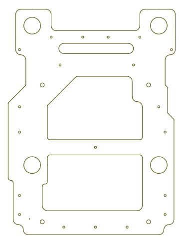

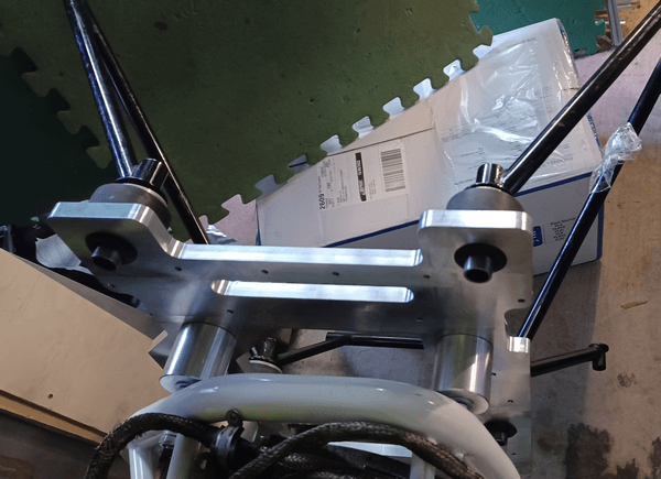

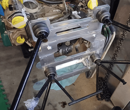

RFguy Posted September 8, 2022 Author Share Posted September 8, 2022 (edited) Finally got around to finishing the CAD for the mount adaptor plate. Off the to fab shop for that 12mm slab of 6061T6. 5005 would have been fine but its what I could get in the size. The big holes mate with the Jabiru engine mount with the rubber donuts. The smaller holes (4) interface to the ring mount lots of little ones are just utility threaded M5 thru. dont need the rib across the middle but I can always cut it out. Edited September 8, 2022 by RFguy 5 Link to comment Share on other sites More sharing options...

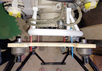

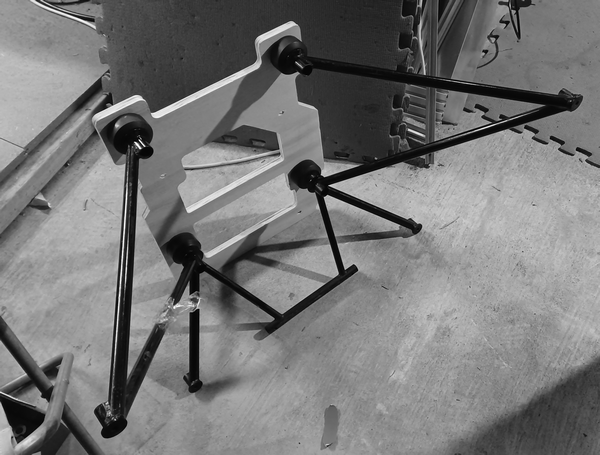

RFguy Posted September 20, 2022 Author Share Posted September 20, 2022 Well, looks like the drawing is good (Plywood CNC) . Will ponder it a bit then get the ally cut..... Three pics below not holding perfectly aligned/square but you get the idea. 7 1 Link to comment Share on other sites More sharing options...

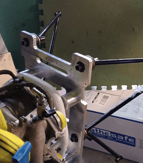

RFguy Posted October 7, 2022 Author Share Posted October 7, 2022 (edited) ...The fat spacers ensure the bolts stage square with the plate. next rev I would pin the spacers to the plate, also. Edited October 7, 2022 by RFguy 7 Link to comment Share on other sites More sharing options...

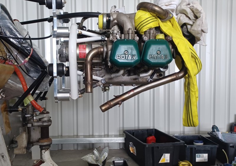

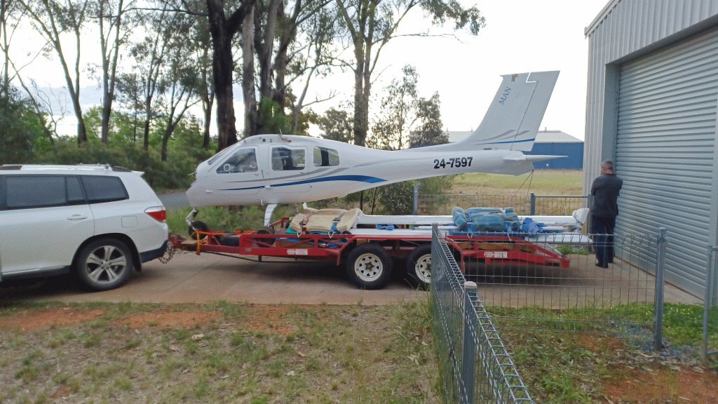

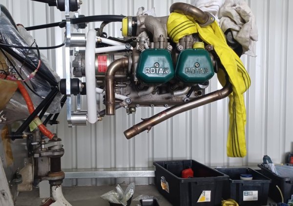

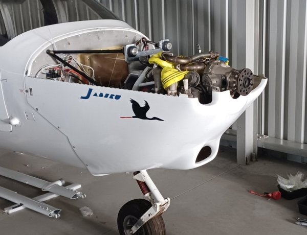

RFguy Posted October 16, 2022 Author Share Posted October 16, 2022 (edited) moved back to Cowra from Temora for Rotax install.. Thanks Thruster88 for your invaluable experience and assistance. (pictured) Edited October 16, 2022 by RFguy 3 1 Link to comment Share on other sites More sharing options...

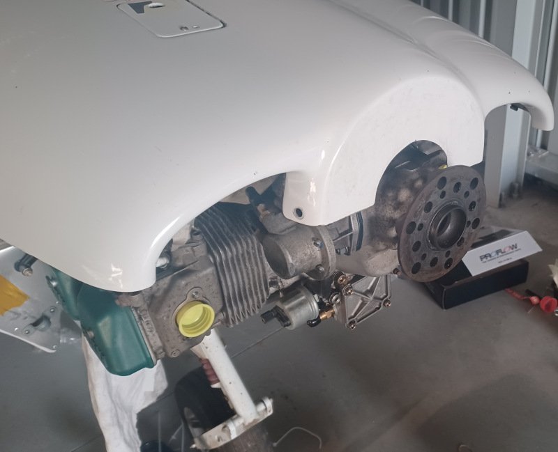

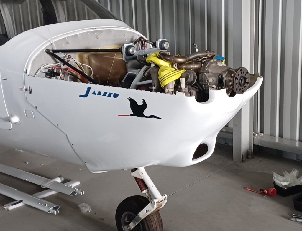

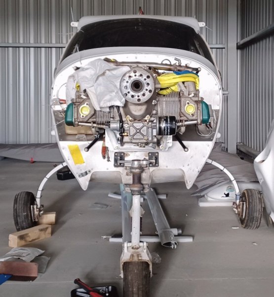

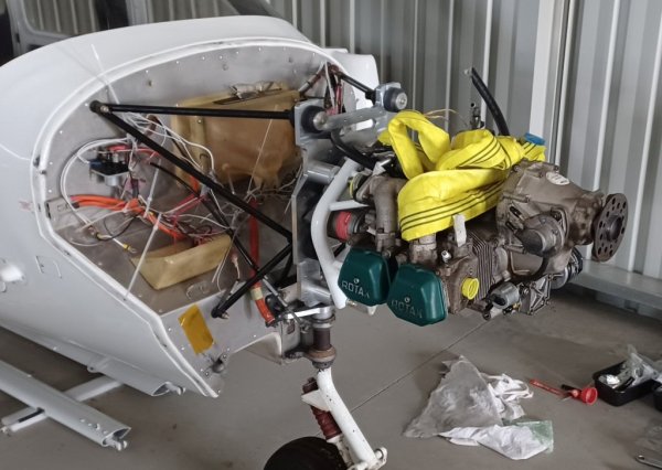

RFguy Posted October 28, 2022 Author Share Posted October 28, 2022 (edited) progress. as known, engine is about 30mm further forward, and the front of the top and bottom cowling needs modifications. thrust line and centre is all good. Edited October 28, 2022 by RFguy 7 Link to comment Share on other sites More sharing options...
RFguy Posted October 29, 2022 Author Share Posted October 29, 2022 (edited) The exhaust ill be custom- that's just what I got. some weird phone camera image distortion in the side view The oil and water cooler will be underneath. The exhaust and turbocharger will be under and forward of the ring mount. That pipe is heavy. 30mm OD, 1.6mm wall. Wil use corrugated SS hose to connect collector, and maybe see how the collector goes paper thin. the turbocharger has to mount to something. The front cylinder cheeks will need to be made a bit wider in the case I reduce compression with cylinder shims. Edited October 29, 2022 by RFguy Link to comment Share on other sites More sharing options...
