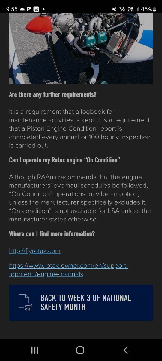

glenT300 Posted June 28, 2022 Author Share Posted June 28, 2022 8 hours ago, aro said: Who told you on condition is not allowed? I had a scan of the technical manual and to me it looks like it should be allowed for private work. I didn't see a section specific to 25 reg - I think for the purposes of the regulations it comes under 95.55. One of the registration guys at Raaus. He said because it is 25 rego it is a certified aircraft and therefore an LSA. I did some searching around and found what he said on the RAAUS website. It's a bit stupid because if it was any other prefect you can run on condition. Link to comment Share on other sites More sharing options...

Thruster88 Posted June 28, 2022 Share Posted June 28, 2022 Glen, you need to get a definitive ruling from the tech manager, good luck with that. Let us know how that goes. In the VH CASA world "on condition" is permitted. Lycoming have a 2000hour or 12 year tbo. For private and AIRWORK ops which includes flying school aircraft, exceeding the tbo is permitted providing the engine meets the 100 hourly or annual inspection. There are thousands of VH aircraft with engines on condition including my two. The way I see it RAAus is just an out station of CASA. A quick look at RAAus aircraft for sale shows most are on condition. If all these aircraft need a new engine it will put a serious dent in the cheap flying. The L2 could show that the engine is on condition due calendar on tech form 13 condition report however I cannot see an item for that on the form. I have been involved in registration of a few 10 and 25 thrusters in recent times, all have engines on condition due calendar. Link to comment Share on other sites More sharing options...
glenT300 Posted June 28, 2022 Author Share Posted June 28, 2022 3 minutes ago, Thruster88 said: Glen, you need to get a definitive ruling from the tech manager, good luck with that. Let us know how that goes. In the VH CASA world "on condition" is permitted. Lycoming have a 2000hour or 12 year tbo. For private and AIRWORK ops which includes flying school aircraft, exceeding the tbo is permitted providing the engine meets the 100 hourly or annual inspection. There are thousands of VH aircraft with engines on condition including my two. The way I see it RAAus is just an out station of CASA. A quick look at RAAus aircraft for sale shows most are on condition. If all these aircraft need a new engine it will put a serious dent in the cheap flying. The L2 could show that the engine is on condition due calendar on tech form 13 condition report however I cannot see an item for that on the form. I have been involved in registration of a few 10 and 25 thrusters in recent times, all have engines on condition due calendar. Thank you for the info. I knew there was something I was missing to the puzzle. I thought this must have been a new rule or an ignored one. I'll get in touch with the tech manager and see what they say. Fingers crossed I get this sorted as painlessly as possible. Link to comment Share on other sites More sharing options...
Thruster88 Posted June 28, 2022 Share Posted June 28, 2022 (edited) I don't see how a thruster can be LSA when their production pre dates the introduction of the category https://www.casa.gov.au/aircraft/sport-aviation/light-sport-aircraft/about-light-sport-aircraft Compared to part 23 certified aircraft (cessna 172) LSA sounds like a free for all yet you cannot run the engine on condition unlike the Cessna. Makes perfect sense not. Edited June 28, 2022 by Thruster88 Link to comment Share on other sites More sharing options...
aro Posted June 28, 2022 Share Posted June 28, 2022 I would assume that RAA use the LSA definition in CAO 95.55. I don't think it can be a LSA without having a special certificate of airworthiness specifically issued for a light sport aircraft. Otherwise I think it comes under the definition of ultralight aeroplane means an aeroplane (other than a light sport aircraft or lightweight aeroplane) that: ... (e) is one of the following: ... (iv) an aeroplane to which Air Navigation Order section 95.25 as in force on 25 March 1985 applies (known as an old section 95.25 aeroplane); 1 Link to comment Share on other sites More sharing options...
glenT300 Posted June 28, 2022 Author Share Posted June 28, 2022 I bought this aircraft for cheap affordable flying. Cheap affordable flying isn't having to send my engine overseas for overhaul every 5 years irrespective of how many hours of flying I've done. Mine is an 89 model and they've classified it as certified and a 25 rego so not much I can do about that. Hopefully I get some joy out of the Tech manager. Link to comment Share on other sites More sharing options...
aro Posted June 28, 2022 Share Posted June 28, 2022 If the registration is 25- it is a 25 reg, but being a 25- reg or being certified doesn't make it LSA as far as I can see. Link to comment Share on other sites More sharing options...
