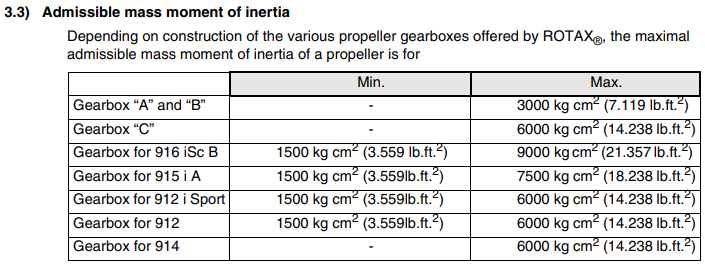

RFguy Posted August 11, 2022 Share Posted August 11, 2022 (edited) OMG ! RUNNING WITHOUT A PROP ? NO NO NO ! I would NOT (and rotax does not) recommend running the ROTAX without a minimal inertial mass moment . NOT ONLY DO THEY NOT RECOMMEND IT, they forbid it HERE ARE THE NUMBERS !!!!. Inertia for a thin disc = 1/2 . m . Radius squared. .. soooo for a 25cm radius disc, it must weight a minimum of 4.8kg Made of aluminium sg = 2.7 g/cm2, that is 1777cm2, or a 25cm radius disc that is 0.905cm thick. for say 30cm radius (60dia) , that is a 3.3kg disc, and the disc for ally will be 1234cm2 and 0.436cm thick. So if you go with something like 5mm plate, 60cm diameter, that will work. or 10mm plate,48cm dia, , that will work... In gold, 25cm diameter, 4.8kg, 248cm2, or 1.26mm thick but it might not hang together, without being some gold alloy. The rotax has a minimal flywheel, also. Edited August 11, 2022 by RFguy 1 Link to comment Share on other sites More sharing options...
