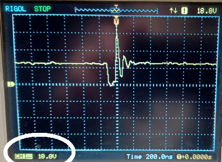

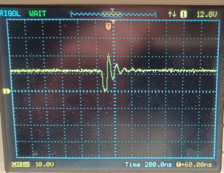

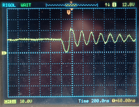

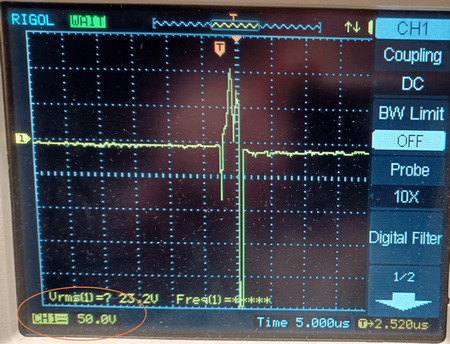

RFguy Posted August 13, 2022 Share Posted August 13, 2022 (edited) Here you go folks, on a typical master relay or starter solenoid. This is not my fastest scope, but fast enough. First pic, what happens without any spike protection : Note in the bottom left corner, the voltage per vertical division (vertical scale) This is 50V per division. The negative spike is off the scale, > 250V negative, and ! 100V positive. Nasty ! This is what kills electronics. And the length of the transient is long (a few microseconds) = lots of energy. The time divisions are 5uS per division. These long voltage pulses can rip through the whole wiring harness... *************************************************************************************************** Second pic - with a 1N5408 rectifier diode across the coil, Vertical scale is 10V /division. negative spike is at -1V. positive spike is at about 33V. Much better ! And the spike length is very short- less than 200nS. Most electronics designed for 12V would survive this most of the time. Not bad. The time divisions are 200nS (0.2uS) per division. ********************************************************************** Third pic - This is with my recommended 1N5819 Schottky rectifier diode across the coil. Maximum excursion is about +22V. Negative excursion ~ -0.2V and its fast - it is all over within 200nS ! ************************************************************** Fourth Pic- using a 18V UNIdirectional TVS voltage transient diode across the coil. Type It is designed to clamp -1V in one direction and +18V in the other direction. It's designed to be placed on a voltage bus and deal with all nasties. These diodes are designed for when there is LOTS of energy to be dumped. Alternators can dump lots of energy if disconnected. Notice the behaviour- clamp is around 0Volts on negative, and peak about 20V positive. But has substantial ringing. Length of the ring is about 1uS. Use unidirectional, not bi-directional. (they come in both types) ********************************************************************* So when to use the rectifier diode, and when to use the TVS diode ? The TVS diode can be placed across the 12V bus and will clip the positive and negative excursions. A rectifier diode placed across the bus will only clip negative excursions- the rectifier diode must be placed across the relay or contactor- that is it must be placed across the inductive component that is generating the high voltage spikes. So the summarize : Place across relay or contactor or solenoid : 1N5819 , or 18V TVS diode (band to positive side)...or 1N4007 (2nd choice - good) or 1N5408 3rd choice. Place across 12V bus : 18V TVS diode Place across alternator battery connnection regulator output : 18V TVS diode. When using TVS diode, buy the unidirectional, not the bi-directional. Band to Positive. -glen english Edited August 13, 2022 by RFguy 1 5 4 Link to comment Share on other sites More sharing options...
RFguy Posted August 13, 2022 Author Share Posted August 13, 2022 I'll add that for TVS diodes, it is best that go at the source of the trouble, or on the gear itself to protect the gear. There place where they are well used is on the gear itself- The voltage spike HAS to pass the diode before getting into the gear. The diode will strip off the spike . I put them into Microair radios when I come across them. Compare to say the TVS diode just being in the wiring somewhere- the voltage spike might not have to go past the diode, and it wont be effective. 1 1 Link to comment Share on other sites More sharing options...

Jabiru7252 Posted September 11, 2022 Share Posted September 11, 2022 On 13/08/2022 at 11:41 AM, RFguy said: Here you go folks, on a typical master relay or starter solenoid. This is not my fastest scope, but fast enough. First pic, what happens without any spike protection : Note in the bottom left corner, the voltage per vertical division (vertical scale) This is 50V per division. The negative spike is off the scale, > 250V negative, and ! 100V positive. Nasty ! This is what kills electronics. And the length of the transient is long (a few microseconds) = lots of energy. The time divisions are 5uS per division. These long voltage pulses can rip through the whole wiring harness... *************************************************************************************************** Second pic - with a 1N5408 rectifier diode across the coil, Vertical scale is 10V /division. negative spike is at -1V. positive spike is at about 33V. Much better ! And the spike length is very short- less than 200nS. Most electronics designed for 12V would survive this most of the time. Not bad. The time divisions are 200nS (0.2uS) per division. ********************************************************************** Third pic - This is with my recommended 1N5819 Schottky rectifier diode across the coil. Maximum excursion is about +22V. Negative excursion ~ -0.2V and its fast - it is all over within 200nS ! ************************************************************** Fourth Pic- using a 18V UNIdirectional TVS voltage transient diode across the coil. Type It is designed to clamp -1V in one direction and +18V in the other direction. It's designed to be placed on a voltage bus and deal with all nasties. These diodes are designed for when there is LOTS of energy to be dumped. Alternators can dump lots of energy if disconnected. Notice the behaviour- clamp is around 0Volts on negative, and peak about 20V positive. But has substantial ringing. Length of the ring is about 1uS. Use unidirectional, not bi-directional. (they come in both types) ********************************************************************* So when to use the rectifier diode, and when to use the TVS diode ? The TVS diode can be placed across the 12V bus and will clip the positive and negative excursions. A rectifier diode placed across the bus will only clip negative excursions- the rectifier diode must be placed across the relay or contactor- that is it must be placed across the inductive component that is generating the high voltage spikes. So the summarize : Place across relay or contactor or solenoid : 1N5819 , or 18V TVS diode (band to positive side)...or 1N4007 (2nd choice - good) or 1N5408 3rd choice. Place across 12V bus : 18V TVS diode Place across alternator battery connnection regulator output : 18V TVS diode. When using TVS diode, buy the unidirectional, not the bi-directional. Band to Positive. -glen english Howdy. My cheap digital CRO lets me save the screen to a USB stick so I don't have to photograph it. Also, if you put a diode across a solenoid or relay to stop the spike, should not the spike be limited to 0.6 volts? SDS00006.BMP Link to comment Share on other sites More sharing options...
RFguy Posted September 11, 2022 Author Share Posted September 11, 2022 Kevin, 500mV/div or 5V/div (with x10 probe) ? solenoid stand alone with just a cliplead put on the coil ? 5mS/div, you are probably seeing the L/R product of the relay solenoid. A rectifier diode across the solenoid should clamp , once it eventually turns on, at ~ -0.7V yeah. There will be some overshoot due to turn on delays. The unidirectional TVS will try and clamp ~ 1V one way and whatever the clamp voltage is the other way and bounce between . Bi directional type will bounced both ways. Link to comment Share on other sites More sharing options...
