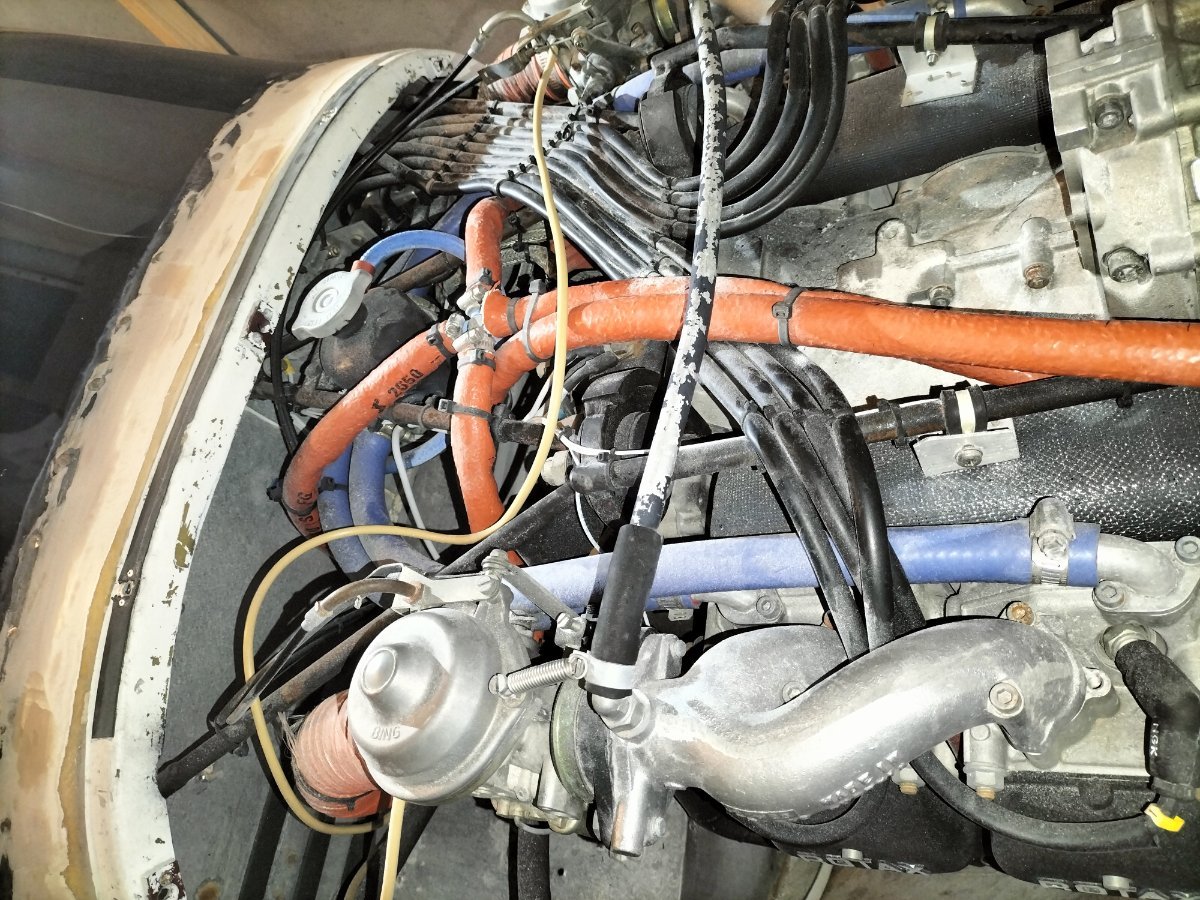

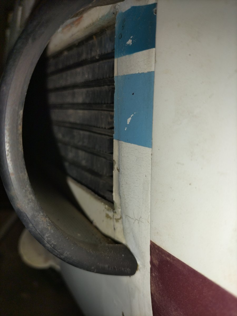

skippydiesel Posted September 21, 2022 Author Share Posted September 21, 2022 1 hour ago, IBob said: Skippy, maybe we are looking at different documents, but I can't see anywhere it says the cooler must be mounted in that orientation. The only references I can see are on Page 22 of 79-00-00: 1. Mount the cooler below the oil pump. 2. Mount the cooler with the fittings upwards. If I'm missing stuff here, I'm happy to be corrected........? Seems to me that I have somehow read into the oil tank location/orientation the same info for the cooler - brain cells not getting ant sharper. Thanks for pointing out my error (had me worried for a while) However I still have the cooler in/out lets at very different location to the Rotax sketch (ideal?) - I cant see why the in/out lets must be on top as long as I am confident (which I am) thet there is not air bubble trapped in my oil cooler. Link to comment Share on other sites More sharing options...
IBob Posted September 21, 2022 Share Posted September 21, 2022 Okay, saw your pics now. I am certainly not any sort of engine or Rotax expert, but I cannot see any problems with the way you have it mounted. I would think that the Rotax reference to having the ports on the top is to avoid anyone having them on the bottom, which would/could lead to varying amounts of air trapped, and the oil passing only through the lower part of the cooler, resulting in varying and inadequate cooling. Link to comment Share on other sites More sharing options...
