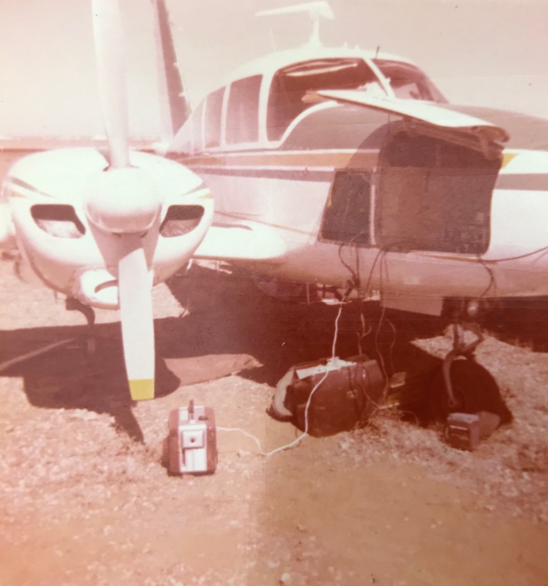

jackc Posted October 1, 2022 Author Share Posted October 1, 2022 What the eye does not see, or the ear does not hear, the heart does not grieve……over 40 years ago I had a pilot land at Coober Pedy and blew a tyre on an Aztec, he asked where he could get it fixed, along with his crook radio. I said an AME from Pt Augusta or Alice Springs will be the closest and may take a couple of days. Or, you can look the other way and I will fix it 🙂 So I sourced an industrial tyre and tube in town and fitted it up, repaired his radio, broken wire and he flew away happy. You don’t need a piece of paper to fix anything in this World IF you know what you are doing. You DONT need a qualified LAME to fix an aircraft 🙂. Yeah I can hear the Cupcakes of today bleating about illegal, insurance, liability etc etc. It’s all only a problem IF you don’t know what your doing. Unless some snowflake snitch dobs you in. IF you can access a LAME by all means use him, if not…..then do your own thing. 1 2 Link to comment Share on other sites More sharing options...

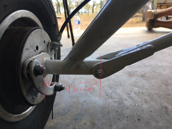

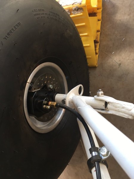

jackc Posted October 3, 2022 Author Share Posted October 3, 2022 This is what I did to my Aeropup, the drum cable brake from what appears to be off a moped was checked on a test flight as part of my condition report, the video I was sent showed a landing roll at Gympie longer than a 747. I queried the L2 who said if I was you, I would not fly with those brakes. So, the next pic shows the hydraulic disc brake kit I upgraded it to. Now this aircraft has not flown with this setup, the reason is the work continues…..now a full rewire.and some added instruments before taking to the sky. Not wanting to put this tyre size on a Jabiru, but just a slight increase? Maybe a CAR35 engineer could solve the Jabiru problem? 1 Link to comment Share on other sites More sharing options...

jackc Posted October 4, 2022 Author Share Posted October 4, 2022 Heard back from Jabiru….. If the aircraft is registered under the ASTM LSA (i.e. 24-rego) then the aircraft has to remain standard (500 x 6 nose and mains). Under ASTM there is no STC ruling, it is a manufactures approval. Jabiru have done no load testing etc to come up data that allows such modifications to a 24 reg J-230, for approval by them. Therefore I will just have to let the tyres down a bit, for softer landings 🙂 Link to comment Share on other sites More sharing options...

jackc Posted October 4, 2022 Author Share Posted October 4, 2022 IF I get this aircraft, I will have a good look, the front wheel yoke will not allow a size increase anyway, but Jabiru said also that the load mount points for undercarriage had not been tested for increased stress on those points of the fuselage, either. Cant see how that could be, even for a small increase but they design aircraft and I dont……and being 24 rego etc etc, we all know the story. Link to comment Share on other sites More sharing options...
