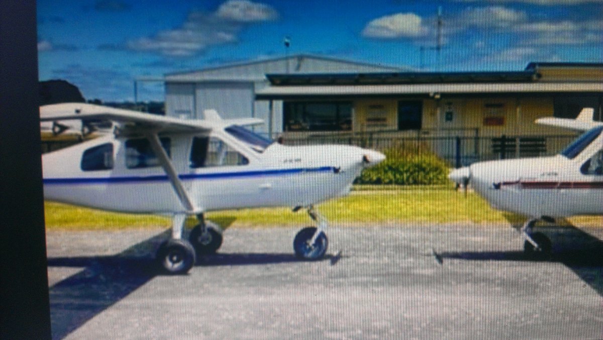

Jim188 Posted December 14, 2022 Share Posted December 14, 2022 Here is what a Jab EXP might look like with bigger tyres, not sure if this pic is real or photoshopped. Link to comment Share on other sites More sharing options...
RFguy Posted December 14, 2022 Share Posted December 14, 2022 that's put on a bit of drag on the TO roll.... 1 Link to comment Share on other sites More sharing options...
Jim188 Posted December 14, 2022 Share Posted December 14, 2022 I was following this Cessna tyre thing in SA for some two years now. They say the take off roll is shorter, the idea, is that the Jab has less ground frication on the ground roll, I guess it will make little difference on the black stuff. I also read, they lost some airspeed at cruise, but the handling on their bush strips was so much better with less worry about the nose wheel falling into an animal track and prop strike. Anyway JackC, I hope this helps with your question about the bigger tyres, one last thing, you'll have to forget about it unless you own a 19 or Exp register Jabiru. 1 Link to comment Share on other sites More sharing options...
