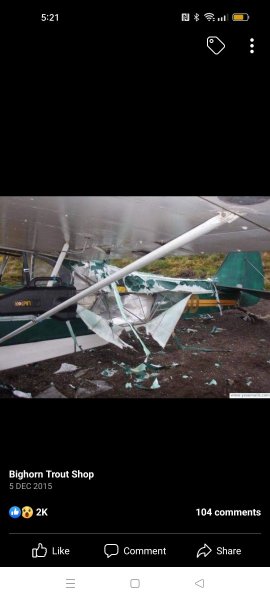

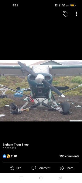

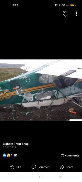

jackc Posted October 23, 2022 Share Posted October 23, 2022 Tape is must have if large animals decide to feast on your wings or tail feathers 🙂 1 Link to comment Share on other sites More sharing options...
facthunter Posted October 23, 2022 Share Posted October 23, 2022 Does that happen often to you? I wouldn't even want them leaning on it. . Nev 1 Link to comment Share on other sites More sharing options...
