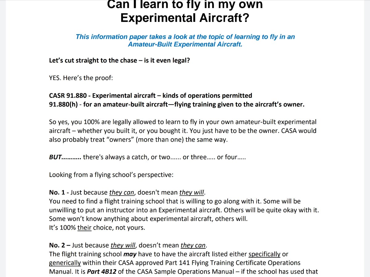

skippydiesel Posted November 21, 2022 Share Posted November 21, 2022 Cant find it but someone mentioned getting instruction in the new aircraft - be warned, in RAA, this may only be done in a factory (24) registered aircraft - homebuilt/experimental can only be used for instruction where the pilot/owner is the builder 1 Link to comment Share on other sites More sharing options...
Thruster88 Posted November 25, 2022 Share Posted November 25, 2022 On 22/11/2022 at 10:13 AM, skippydiesel said: Cant find it but someone mentioned getting instruction in the new aircraft - be warned, in RAA, this may only be done in a factory (24) registered aircraft - homebuilt/experimental can only be used for instruction where the pilot/owner is the builder The SAAA has information about getting flight instruction in an amateur built experimental aircraft in the latest email update. It is legal according to CASR 91.880(h) regardless of whether you built or bought the aircraft. Not sure why RAAus would make rules to make it more difficult than it needs to be. As they say it is up to the instructor/ flight school to say yes or no. 4 Link to comment Share on other sites More sharing options...
