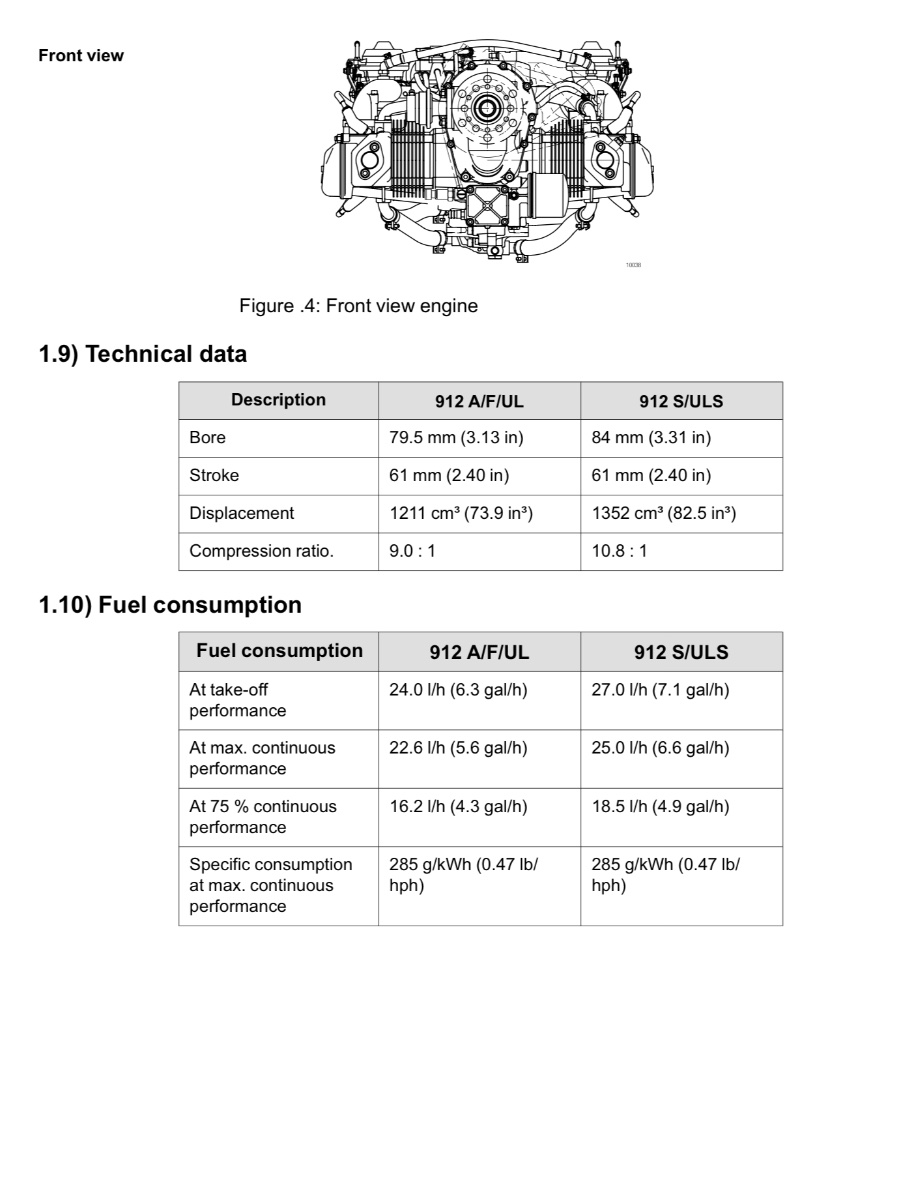

skippydiesel Posted November 26, 2022 Share Posted November 26, 2022 "...................the Warrior will set you back $95/hr in Avgas versus $40/hr for RON95 ULP in the Sling" Wow! that's one thirsty (20L/h) Rotax 912 ULS (or is it a 914?) in the the Sling. My 912ULS cruised at 100 + kn for 13L/h & 120 kn for 18L/h. My new one (yet to fly) I hope to do 130 kn for 16L/h Link to comment Share on other sites More sharing options...

rodgerc Posted November 26, 2022 Share Posted November 26, 2022 9 hours ago, skippydiesel said: "...................the Warrior will set you back $95/hr in Avgas versus $40/hr for RON95 ULP in the Sling" Wow! that's one thirsty (20L/h) Rotax 912 ULS (or is it a 914?) in the the Sling. My 912ULS cruised at 100 + kn for 13L/h & 120 kn for 18L/h. My new one (yet to fly) I hope to do 130 kn for 16L/h My Warrior and Sling numbers are pretty rough but not out by anything like an order of magnitude. Based on Rotax’s published data and using a RON 95 ULP specific gravity of 0.72, 285g/kWh converts to ~0.297L/h/HP i.e. 20L/h approximates 67HP..... similarly 18L/h ~61HP, 16L/h ~54HP and 13L/h ~44HP. IFF Rotax’s data is reliable and your 130kt @ 16L/h expectations are realised, you’ll have built a very slippery airframe. 1 Link to comment Share on other sites More sharing options...
