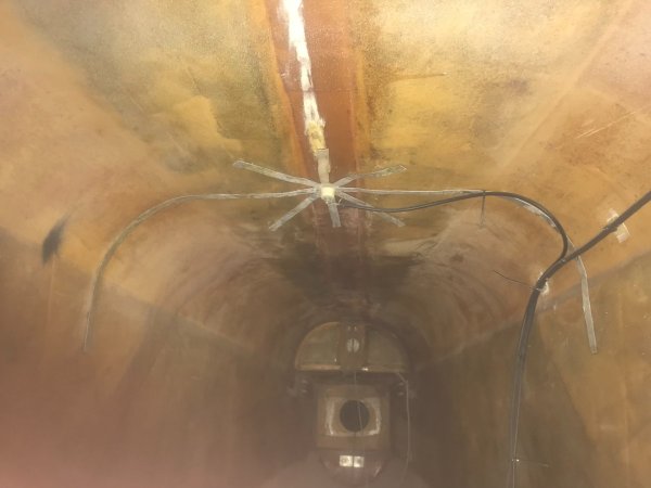

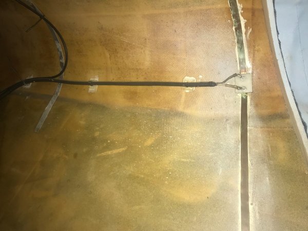

I'm halfway through repairing damage to the bottom of the fuselage. I won't go into how it was damaged at this point but as well as damaged fibreglass it has cut both the coax cables to each antenna.
I have both the normal VHF comms radio and also a UHF unit fitted. Both were fitted by the previous owner.
There is a dipole type and also a stub type at the top with it's ground plane attached underneath inside the plane.

The UHF antenna probably doesn't have much of a ground plain , if any.
In a composite or wood aircraft, the VHF (not the dipole) antenna should have a significant ground plain - fit one it will leave the dipole in the shade for both transmit & receive..
hmm OK the dipole is definetly VHF
the stub end fed antenna with the ground plane- that ground plane looks like it could be used for VHf or UHF, so it depends what is on the other side of the fibreglass. if it is ~ 16cm long skinny , that would be a UHF stubby whip.  If it is perhaps 30cm long and appears to have a coil or spring in it, probably VHF.

Both sets of wires seem to be attached simply to metal straps, which I assume form the antenna ground planes. The strips seem to be glued to the body. If a large area sheet of metal replaced the thin strips, would that improve the trans-ception capabilities of an aerial? On the converse, would a large ground plane require some mans of screening it from the aircraft's electrical signal (engine ignition system, electronics etc)

Glen will have the technical answer  - mine is: ground planes can be made of any good conductive material (metal). Metal aircraft (& carbon fiber) make excellent ground planes. Composites/wood must have constructed/fabricated ground planes, these are usually made of thin metal. The ones shown are  copper ribbon . I have used builders aluminium flashing to good effect.  A flat symmetrical plate (or cross) with the antenna in the centre is the best.  Flexible material can be molded & glued to the inside of the fuselage. I have forgotten the formula for the optimum size, this is often compromised by the available space
for small ground planes, like these, being a solid or approximated with thin elements wont make any difference in this application.
the only time this is important is if, for example, you have some sensitive electronics underneath the antenna- the solid plane will be an electrostatic shield and prevent possible interactions.
also, noise from the cockpit can get on the coax cable outer and be brought into the antenna pickup field. The complete ground plane (solid) reduces the pickup from garbage on the cable.
in this application, the minimum you need in thin elements is two wires in opposite directions to acheive symmetry.
The coax cable should come away at 90 deg to the antenna, ideally, in the two wire scenario.
