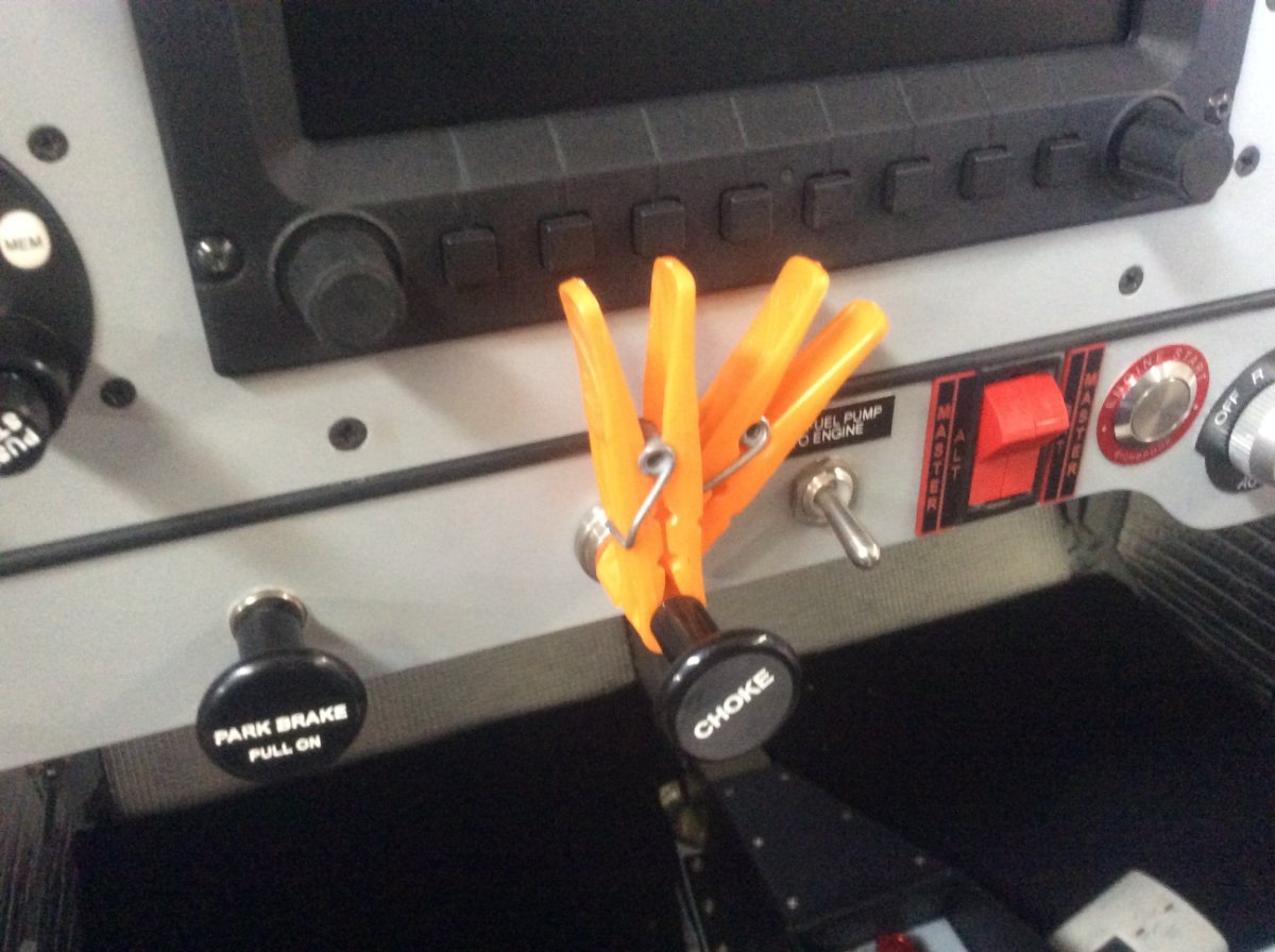

skippydiesel Posted December 3, 2022 Share Posted December 3, 2022 I fitted my last aircraft with a nifty motorcycle choke that had a friction nob so that I could lock it full closed, thus freeing my hands to do other things in the cockpit while I started the engine. My new aircraft comes with a genuine aircraft choke, that must be held in the full closed position for starting (no friction devise). I find this to be very inconvenient. A third or even forth hand, would be a great help. In leu of additional hands ,this is what I have come up with: Crude, simple, efficient, cost effective and allows for half choke very soon after start 2 Link to comment Share on other sites More sharing options...

Thruster88 Posted December 4, 2022 Share Posted December 4, 2022 19 hours ago, skippydiesel said: I fitted my last aircraft with a nifty motorcycle choke that had a friction nob so that I could lock it full closed, thus freeing my hands to do other things in the cockpit while I started the engine. My new aircraft comes with a genuine aircraft choke, that must be held in the full closed position for starting (no friction devise). I find this to be very inconvenient. A third or even forth hand, would be a great help. In leu of additional hands ,this is what I have come up with: Crude, simple, efficient, cost effective and allows for half choke very soon after start You could move the start button between the park brake valve and the choke. Fingers on the choke, thumb on the start, other hand on throttle. Problem solved. Got a pic of the entire panel layout? 1 1 Link to comment Share on other sites More sharing options...
Blueadventures Posted December 4, 2022 Share Posted December 4, 2022 58 minutes ago, Thruster88 said: You could move the start button between the park brake valve and the choke. Fingers on the choke, thumb on the start, other hand on throttle. Problem solved. Got a pic of the entire panel layout? Agree, needs rearrangement. Pegs stupid. I would have had the start button and enricher (Choke) closer, from the getgo. Moving the Alt / Battery switch unit will also allow them to be closer. 1 1 Link to comment Share on other sites More sharing options...
old man emu Posted December 4, 2022 Share Posted December 4, 2022 22 hours ago, skippydiesel said: Crude, simple, efficient, cost effective and allows for half choke very soon after start You've got that pegged! 1 Link to comment Share on other sites More sharing options...
skippydiesel Posted December 4, 2022 Author Share Posted December 4, 2022 2 hours ago, Blueadventures said: Agree, needs rearrangement. Pegs stupid. I would have had the start button and enricher (Choke) closer, from the getgo. Moving the Alt / Battery switch unit will also allow them to be closer. Thank you for your kind words - Its easy to be critical but in the end the "clever" pilot works with what he has - pegs, in this instance are cost effective, light weight, do not require reengineering/wiring and easy to use. 1 Link to comment Share on other sites More sharing options...
Blueadventures Posted December 4, 2022 Share Posted December 4, 2022 Just now, skippydiesel said: Thank you for your kind words - Its easy to be critical but in the end the "clever" pilot works with what he has - pegs, in this instance are cost effective, light weight, do not require reengineering/wiring and easy to use. My comment is directed at the builder, yourself and it is an easy fix if you want to do it. I would not accept the use of pegs like you have. It's not good in my opinion. Even change out the enricher device. I have seen setups where the enricher is pull to 'ON' and a 90 degree turn locks the position. After starting it is turned 90 degrees opposite and it springs to fully off. You should consider such / similar. You have asked assistance / comment with many things for your build and this is my comment to help. Its not a direction just a comment. 1 Link to comment Share on other sites More sharing options...

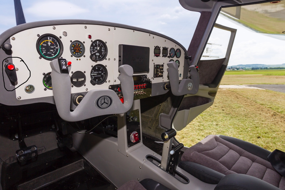

cscotthendry Posted December 5, 2022 Share Posted December 5, 2022 You need one of these. The handle is the choke pull. The red button is the start button. Unfortunately it's a custom item made by Aeropilot, but someone could probably make something similar for you. 4 Link to comment Share on other sites More sharing options...

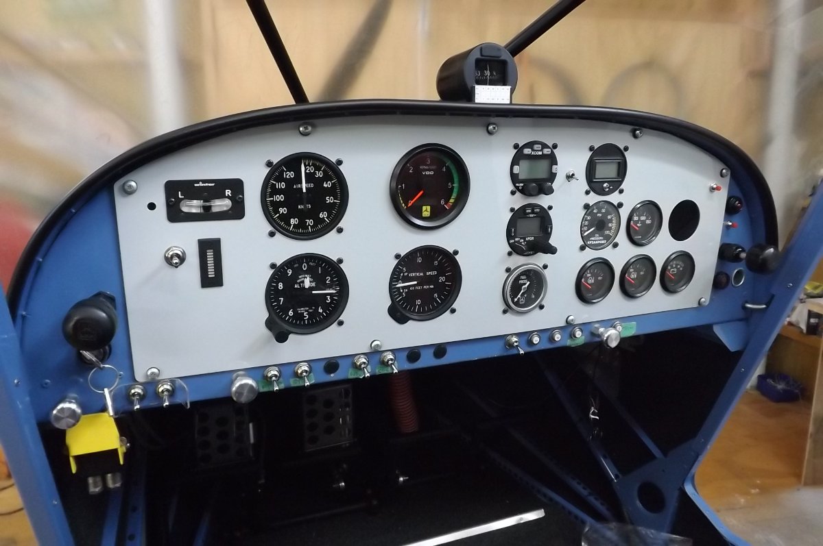

IBob Posted December 5, 2022 Share Posted December 5, 2022 (edited) I have a separate choke that springs back: it's the silver knob at the lower left in the pic. The starter switch is just under the throttle, and it works fine for me: throttle closed, fully pull choke, hit the switch, and as soon as she fires my hand goes from switch to throttle. Pause a moment, then feed in some throttle while letting the choke off. My engine does have the timed spark retard, and that makes for much better starting than the earlier arrangement where the spark was advanced as soon as the engine hit a certain RPM. I also have a heavy negative cable from engine back to battery: some years ago i read something from an Australian Rotax guru, who reckoned he had noticed a strong correlation between aircraft with starting/sprag clutch damage problems, and aircraft that relied on the hull for the negative return. A combination of the above has always given me very good starting. Edited December 5, 2022 by IBob 3 1 1 Link to comment Share on other sites More sharing options...

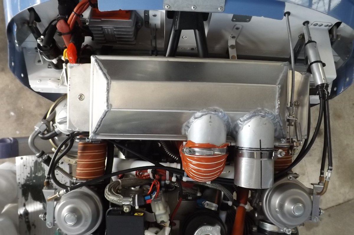

IBob Posted December 6, 2022 Share Posted December 6, 2022 (edited) Blueadventures, I believe the throttle bar stop may go some way towards maintaining carb synchronisation. I have the standard setup, with two cables coming from the quadrant bar to the two carbs. Initially, as this bedded in, and as expected, the carb sync required periodic minor adjustments. But since approx the 45hr mark, no further adjustment has been required: I still check it periodically, but it will be almost 200hrs since I last adjusted it. I put that down to careful routing and securing of the cables and the throttle bar stop, which prevents the carb arms being pulled beyond the carb arm stops. And I would count it as one of a very small handful of worthwhile improvements to the Savannah build. The Savannah throttle bar has a centrally placed quadrant, presumably for those wishing to put in a centre knob throttle, but otherwise unused. This comes back and strikes a block of MDP, cut to thickness once I had everything else in, and riveted to the firewall. In the pic you can see the MDP block, it is white and just to the right of the voltage regulator, with the unused quadrant resting againts it. Edited December 6, 2022 by IBob 2 Link to comment Share on other sites More sharing options...
