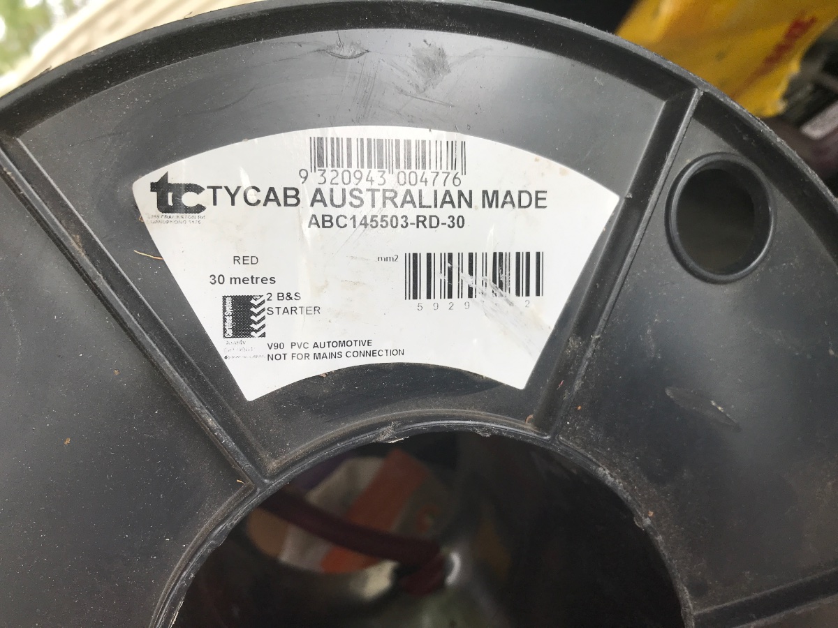

jackc Posted December 26, 2022 Share Posted December 26, 2022 2 hours ago, RFguy said: Cooldrive seems like a site and business very high in hype on their website.... I buy Tycab Australian Made cable via Cooldrive, cost more but worth it. Gave Junkar away a long time ago….. https://www.tycab.com.au/ 2 1 Link to comment Share on other sites More sharing options...

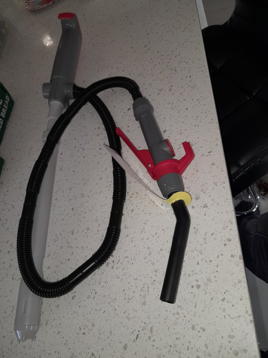

Kiwi Posted December 26, 2022 Share Posted December 26, 2022 Try one of these. Put drum on wing, turn on and pull nozzle trigger, runs on 2 "d" batteries and lasts for ages. 1 1 Link to comment Share on other sites More sharing options...

skippydiesel Posted December 26, 2022 Share Posted December 26, 2022 40 minutes ago, Kiwi said: Try one of these. Put drum on wing, turn on and pull nozzle trigger, runs on 2 "d" batteries and lasts for ages. Its not much more than a powered syphoned - a jiggler would be just as good, at a fraction of the price AND you still have to lift your 10 -20L up onto the wing. If I am being charitable, I would say that it probably reduces the chances of accidental spillage but at $78-90 that's a lot of dough to spend on a syphon. 1 Link to comment Share on other sites More sharing options...

Kiwi Posted December 26, 2022 Share Posted December 26, 2022 1 hour ago, Carbon Canary said: G’day Kiwi, l’ve had my eye on one of these. What do u reckon they would be like in lifting fuel 1.8m from the ground straight up to a high wing ? CC Only used it for the Piper and car, if you can get it within a metre it would work fine. 1 Link to comment Share on other sites More sharing options...

Kiwi Posted December 26, 2022 Share Posted December 26, 2022 1 hour ago, skippydiesel said: If I am being charitable, I would say that it probably reduces the chances of accidental spillage The original poster stated he has no problem getting the 10 litre drum up high enough, but getting the fuel in the tank is the problem. This is nothing like a siphon and would solve his problem. 1 1 Link to comment Share on other sites More sharing options...
