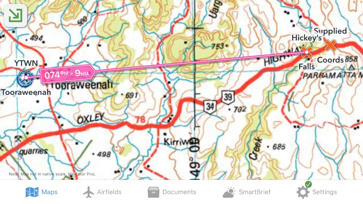

old man emu Posted December 31, 2022 Author Share Posted December 31, 2022 Stupid Question # log e^x^n: If I gave you the name of a location, e.g. Hickeys Falls NSW, and told you that the Google Map coords are -31.425607, 149.081188, and that the WAC coords are 312531, 1490452, which set of values would you use in your electronic flight planning gizmo thingy to fly there? Link to comment Share on other sites More sharing options...

Garfly Posted December 31, 2022 Share Posted December 31, 2022 (edited) 5 hours ago, old man emu said: Stupid Question # log e^x^n: If I gave you the name of a location, e.g. Hickeys Falls NSW, and told you that the Google Map coords are -31.425607, 149.081188, and that the WAC coords are 312531, 1490452, which set of values would you use in your electronic flight planning gizmo thingy to fly there? I prefer to use the DMS coords because that's how my OzRwys - and Google Earth - are (usually) set up. But anyway, for me, both apps (notwithstanding the different formats) placed the coordinates quite close together but at a distance of about 1.5 km to the east along the highway, from Hickeys Falls. I used GE first, to locate the place by name (it's not on any of the charts I have in OzRwys) and then matched up features to confirm and cross check. I placed the falls themselves (just north of the associated carpark) at 312543, 1490401 Or, in our sort of lingo, approx 9nm on the 074 radial FROM YTWN. Are those the kind of results you were expecting? CLICK FOR FULL REZ. Edited December 31, 2022 by Garfly Link to comment Share on other sites More sharing options...

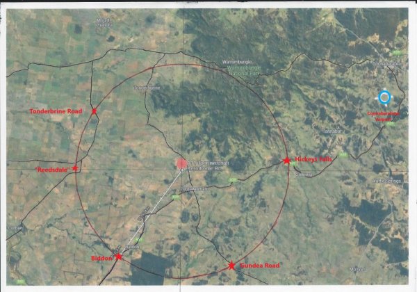

old man emu Posted December 31, 2022 Author Share Posted December 31, 2022 3 hours ago, Garfly said: Are those the kind of results you were expecting? Not quite the answer I was looking for, but good info - thanks. I was simply wondering what keystrokes one made to enter the information into your navigation gizmo thingy. This is the diagram I am going to provide in the Pilot Guide. Link to comment Share on other sites More sharing options...
Garfly Posted December 31, 2022 Share Posted December 31, 2022 (edited) Okay, that looks good. I can see that the precise location of the Falls themselves is not important in context. The road intersection is the waypoint. I suppose you could also play with what3words fixes, which, I reckon, would put the actual falls at magician.opening.aboard and the nearby intersection at uninspired.outsize.strategist and YTWN at assertions.springtime.investigated ;- ) Edited December 31, 2022 by Garfly Link to comment Share on other sites More sharing options...
