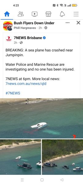

BrendAn Posted January 26, 2023 Share Posted January 26, 2023 Crew ok. Suspect float attachment failure. 1 Link to comment Share on other sites More sharing options...

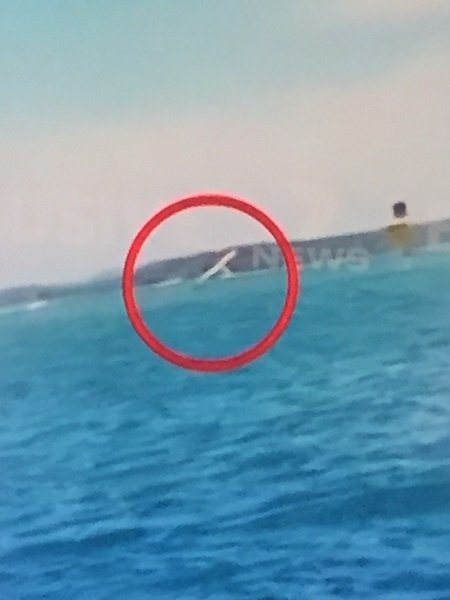

red750 Posted January 26, 2023 Share Posted January 26, 2023 This image snapped from video on the Ch 7 News taken by a bystander. Report stated the plane had just taken off. 1 1 Link to comment Share on other sites More sharing options...
derekliston Posted January 26, 2023 Share Posted January 26, 2023 Looked like a wingdrop stall from the video on the news. It said kit-built but didn’t say what? 1 Link to comment Share on other sites More sharing options...
BrendAn Posted January 26, 2023 Author Share Posted January 26, 2023 1 hour ago, derekliston said: Looked like a wingdrop stall from the video on the news. It said kit-built but didn’t say what? Someone on the group I got that post from seemed to know all about it. He said it was fresh out of an annual and a float mount came apart. But I have no idea if he was correct or not. 1 Link to comment Share on other sites More sharing options...
BrendAn Posted January 26, 2023 Author Share Posted January 26, 2023 (edited) Everyone’s ok, just out of annual, left float fuse mount failure. This is the post I was talking about. Edited January 26, 2023 by BrendAn Link to comment Share on other sites More sharing options...
derekliston Posted January 26, 2023 Share Posted January 26, 2023 11 minutes ago, BrendAn said: Everyone’s ok, just out of annual, left float fuse mount failure. This is the post I was talking about. If you watch the news video, the plane leaves the water, the nose pitches up, the left wing drops and contacts the water, the plane then cartwheels in! Pure surmise but my guess would be the float detaching would be caused by, rather than the cause ofthe crash? 2 Link to comment Share on other sites More sharing options...
derekliston Posted January 26, 2023 Share Posted January 26, 2023 The video of the take-off and crash is on the 9 news site! Worth a look, but until I hear otherwise I’ll keep my opinion. I have personal experience almost identical although not a seaplane. 1 Link to comment Share on other sites More sharing options...
onetrack Posted January 26, 2023 Share Posted January 26, 2023 The float is still attached as he leaves the water - but the wing drop right after getting airborne, puts the wingtip into the water! - so I'm agreement with Dereks assessment! https://www.9news.com.au/national/seaplane-crash-jumpinpin-north-stradbroke-island-queensland/7f2756c8-3b98-4625-a7b6-442ec650bd44 1 1 Link to comment Share on other sites More sharing options...

BrendAn Posted January 26, 2023 Author Share Posted January 26, 2023 1 hour ago, Thruster88 said: There is no doubt, it was a departure stall. Cannot fault this reporter, correctly described type of aircraft and operation. https://www.brisbanetimes.com.au/national/queensland/seaplane-crashes-at-north-stradbroke-island-20230126-p5cfph.html I asked again about the floats and was told there was a float mount failure, neither float detached from the aircraft but the broken/ seperated mount connection is what started his troubles . It will be interesting to see what happened. 2 1 Link to comment Share on other sites More sharing options...

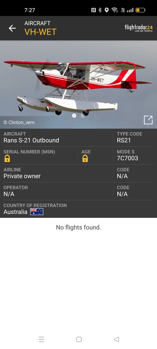

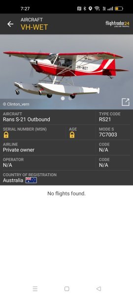

440032 Posted January 27, 2023 Share Posted January 27, 2023 It went swimming as VH-DAB. Rans S7S with Zenith floats. It did have a go-pro mount on the fin I know, (because I made it.) WET is a new S21 on floats, coming soon. 2 Link to comment Share on other sites More sharing options...
BrendAn Posted January 27, 2023 Author Share Posted January 27, 2023 9 minutes ago, 440032 said: It went swimming as VH-DAB. Rans S7S with Zenith floats. It did have a go-pro mount on the fin I know, (because I made it.) WET is a new S21 on floats, coming soon. Yes. I read it was now dab 1 Link to comment Share on other sites More sharing options...
old man emu Posted January 27, 2023 Share Posted January 27, 2023 It's definitely WET now. 1 1 Link to comment Share on other sites More sharing options...
