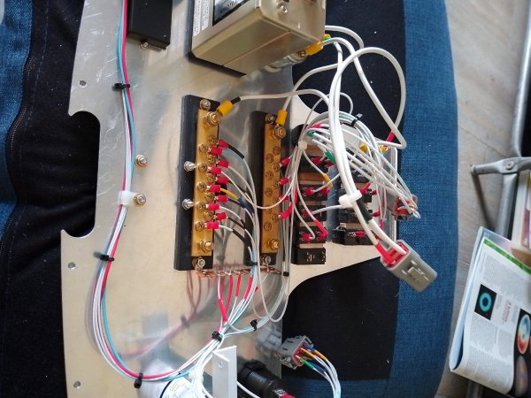

danny_galaga Posted February 21, 2023 Share Posted February 21, 2023 I have yet to wire up my radio, headphone jacks and aerial. Actually I don't even have an aerial 😄 Looking at whether I need shielded wiring on ALL wires into the radio, and would they all need to be grounded? Is it a matter of 'this wire is a must to be grounded, but the more the merrier '? I've wired most of my panel. I've used shielded wire to the ignition switches. The shielding is grounded to the negative bus bar which is on the instrument panel. 1 Link to comment Share on other sites More sharing options...

Kyle Communications Posted February 23, 2023 Share Posted February 23, 2023 All your mic and heaset wiring needs to be shielded. DO NOT earth the shields at both ends only the aircraft end. Your headset sockets must not be grounded to the aircraft frame keep them totally isolated. All earths should be bought back to the one place for all your avionics. I use a earthing brass bar..basically a Neutral link like used in your house. You bring the negative from the battery to that link then onto the engine. Earth loops cause all the issues usually 2 Link to comment Share on other sites More sharing options...

danny_galaga Posted February 23, 2023 Author Share Posted February 23, 2023 5 hours ago, Kyle Communications said: All your mic and heaset wiring needs to be shielded. DO NOT earth the shields at both ends only the aircraft end. Your headset sockets must not be grounded to the aircraft frame keep them totally isolated. All earths should be bought back to the one place for all your avionics. I use a earthing brass bar..basically a Neutral link like used in your house. You bring the negative from the battery to that link then onto the engine. Earth loops cause all the issues usually Oh yes. I'm on top of the negative return aspect. I misspoke earlier, I said I had shielded the ignition switches. I meant radio switch Link to comment Share on other sites More sharing options...
Kyle Communications Posted February 23, 2023 Share Posted February 23, 2023 Good to see you using at least one deustch connector I use deutsch for everything except my CAN bus stuff 1 Link to comment Share on other sites More sharing options...
