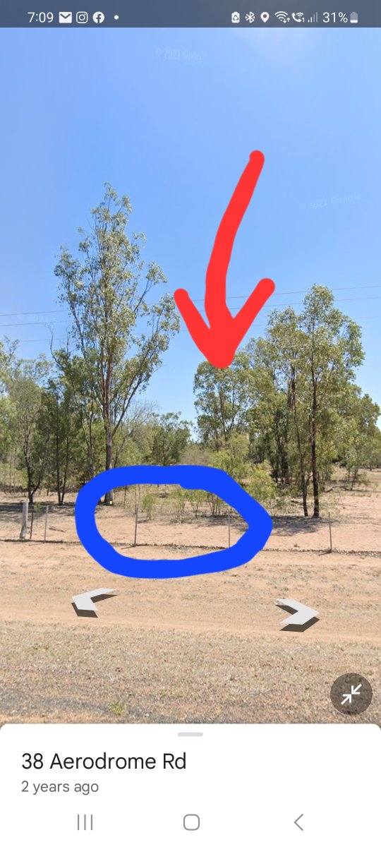

they came through the trees with the LHS wing hitting the tree with the red arrow. they then impacted the ground in the blue circle. the LHS main gear was left at the fence and they then bounced from there to the southern side of the road as seen in other photos. I'm the guy in the red and seen it all. first question I asked  was "what happened" the student said engine failure, got it running then partial engine failure and went below the power lines on purpose.
My partner seen the passenger get ejected through the front windscreen and when I ran to the plane the guy was laying in the long grass on the southern side of the plane( he was in the passenger seat on the northern side)
I know both pilots and the plane as I trained in it

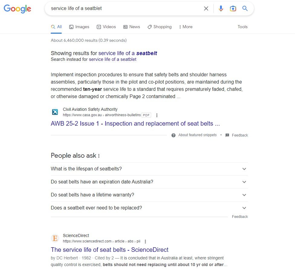

As for the seatbelts, these are the forgotten safety devices in all moving vehicles. Just the other day I was looking at my driver's seat belt in my car. The car is 18 years old. Now this question of seatbelt integrity has come up as a result of this incident, so I Googled "service life of seatbelts" and the first link that was returned was this:
And here is a quote from that AWB:
The difficulty is, that while seat belt webbing may appear to be free of detrimental fraying, fading from exposure to ultraviolet light, and chemical contamination, the only way of ensuring that seat belt webbing is safe to use, is to test the webbing to destruction. This, of course, renders the belt assembly unusable. To overcome this problem, some rotorcraft manufacturers have implemented a 10-year service life on seat belts and shoulder harnesses.
Recommendation
1. Remove from service and destroy all seat belts and shoulder harness webbing when it reaches 10 years time in service.
2. Implement inspection procedures to ensure that safety belts and shoulder harness assemblies, particularly those in the pilot and co-pilot positions, are maintained during the recommended ten-year service life to a standard that requires prematurely faded, chafed, or otherwise damaged or chemically contaminated seat belt webbing to be replaced with serviceable assemblies
I replace my seatbelts in my vehicles regularly, as soon as they start looking tired, frayed, won't retract, or display damage in any part of the seatbelt tongue or latch.

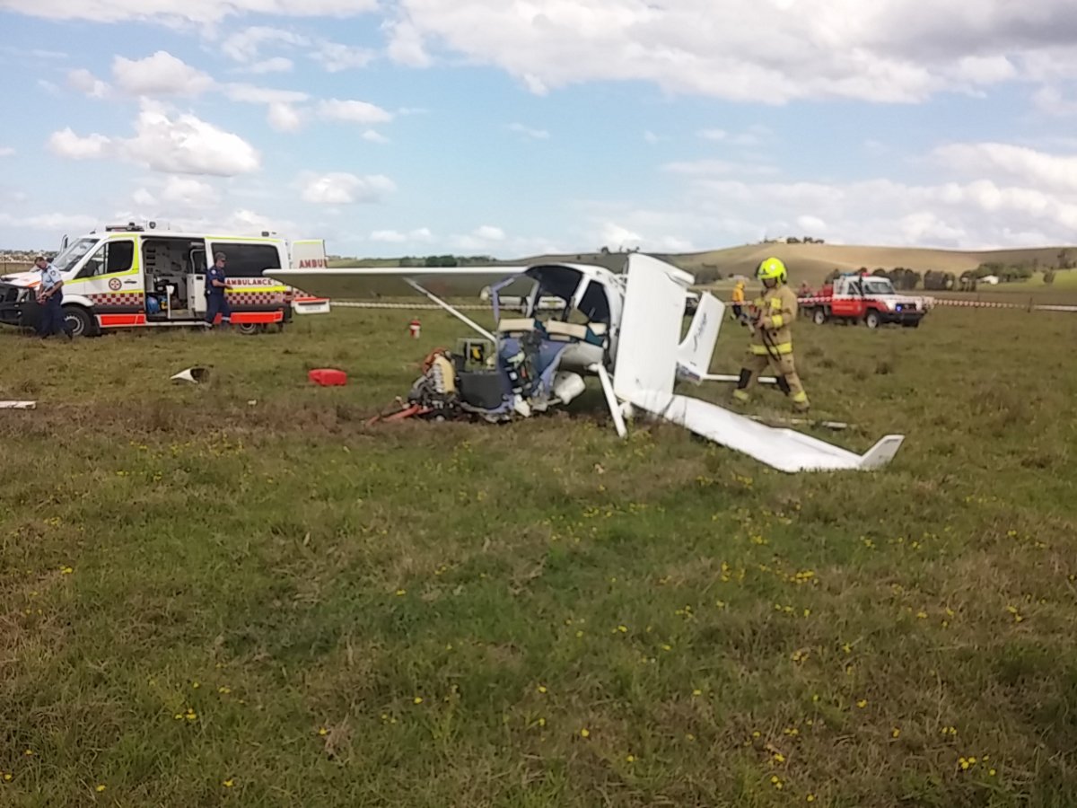

There are a number of reasons why the seatbelt anchor was torn out including previous stresses from earlier issues with the aircraft. Back in 2016 I was one of the first on the scene when a J230 went in under power in a cow paddock just short of Runway 08 at South Grafton. There was extensive damage and the entire front of the aircraft was torn off and partially went under the fuselage. The pilot and passenger were left in their seats looking out at a bunch of startled cattle. Injuries were a cut on the head of one and a sore knee from the other. Jabirus are tough and the passenger compartment is amazingly strong. Photo of this one below
20161012_144951.jpg In a lot of other aircraft GA & RA the occupants would not be here to tell the tale.
