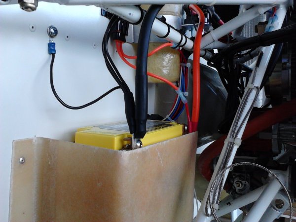

skippydiesel Posted March 6, 2023 Share Posted March 6, 2023 19 hours ago, kgwilson said: I....................................... This my battery installation on the firewall. The battery is 6KGs........................ 19 hours ago, kgwilson said: ........... a top bungee strap to stop it moving........... ...........install an Anderson plug............ Nice neat install. That seems about right for an excellent Rotax start battery - I have used SSB batteries to very good effect for many years. Lead Acid/Absorbed Matt/Gel type motorcycle batterie's have been going up in CCA's and down in weight. The last I purchased, for my Zephyr , was (I think) SSB VB16L-B CCA 385 - AH (20hr) 19- Weight 6.5kg - spun the 912 ULS almost as well as combustion. Personally I don't like bungees in this sort of application - much prefer a strap of almost any tightening system . Be careful of your commonly available Anderson plug - it will literally fall apart, if inadvertently sprayed with hydrocarbon (petrol etc). There are chemical resistant versions, unfortunately I was unable to find any, when I did my search/purchase. 2 Link to comment Share on other sites More sharing options...
