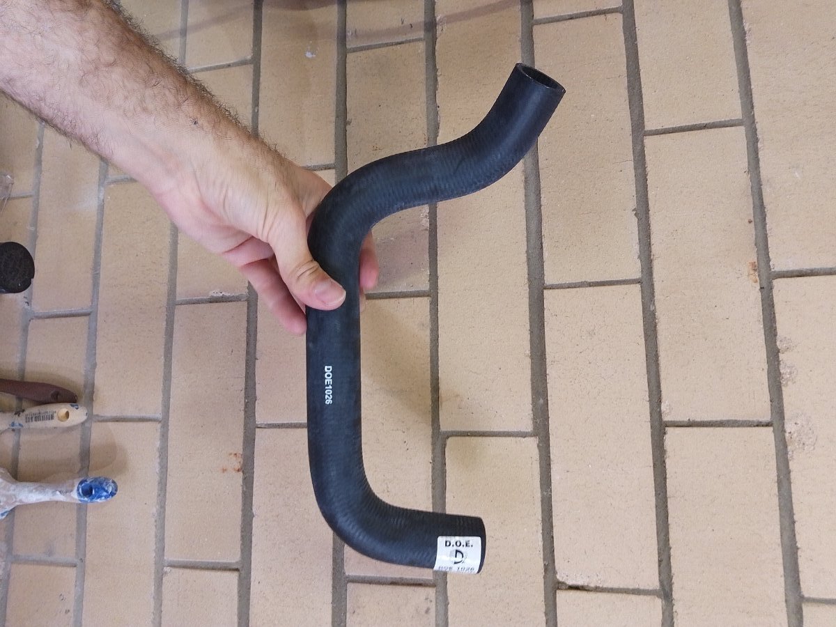

danny_galaga Posted March 12, 2023 Author Share Posted March 12, 2023 (edited) I'm wondering if we are talking at cross purposes here. I thought I was clear. But a picture is worth a thousand words they say. The attached picture is a hose FROM MY KIT. if you google the part number on the label, you get to this car parts supplier https://www.modernautoparts.co.za Just to be one thousand per cent sure, you can type in the other part number on the label and you get the same hose. This, I am confident this is where my kit supplier (which is based in South Africa) gets their radiator hose from and therefore so can i. And I was also asking about any parts that people know are good for Rotax engines. Skippy has come through with a radiator cap and gates hoses. There is one other part I know of, not the engine itself but the regulator/rectifier. I believe it's common to use a Ducati version of some description. Anyone know a source for that? Sorry, no idea why that last bit is underlined. Hard to edit posts on this site 😸 Edited March 12, 2023 by danny_galaga Conniptions 1 Link to comment Share on other sites More sharing options...

danny_galaga Posted March 12, 2023 Author Share Posted March 12, 2023 (edited) No, definitely for kit aircraft, having made to order parts would mostly be quite expensive. For example , radiator hoses 😉 Skippys Zephyr for instance used a Gemini radiator hose, and mine it would seem, a Datsun. Mine is not marked Nissan/Datsun so it's safe to assume it's not Nissan/Datsun OEM. Edited March 12, 2023 by danny_galaga Link to comment Share on other sites More sharing options...
onetrack Posted March 12, 2023 Share Posted March 12, 2023 The radiator hose is a bottom radiator hose that belongs to the Nissan 1400 ute ("bakkie"), which was not sold in Australia. It's made by a local South African rubber components supplier. The engine in the Nissan 1400 ute is the Nissan A14, a 1.4L engine that was fitted to a wide range of vehicles, and forklifts as well. I can't recall what Australian Nissans used this engine, Nissan swapped engines around like I swap my shirts. It does appear the A14 engine was used in the Nissan Pulsar N10 of the early 1980's, but there's no guarantee the Pulsar uses the same radiator hoses as the S.A. Nissan 1400 ute. Nissan are bastards for constant changes. My workshop neighbour has a later (1999) Pulsar with the 1.6L engine, and the thermostat housing rotted out on it - but there are no less than three different thermostat housings for this engine! And they all look the same at first glance! I always try to acquire old printed catalogues, I have a cupboard full of them - water pumps, hoses, brake components, ignition parts, suspension parts, etc, etc - they're a goldmine for tracking down parts, because they give you so much information. https://www.proautorubberkzn.net/radiatorhoses 1 Link to comment Share on other sites More sharing options...
danny_galaga Posted March 12, 2023 Author Share Posted March 12, 2023 (edited) And there it is DOE1026. Nissan 1400 lower. I wasn't expecting any further info on my hose since I have a retail supplier source now, but you've gone above and beyond. This seems to be the manufacturer 😊 Edited March 12, 2023 by danny_galaga 1 Link to comment Share on other sites More sharing options...
