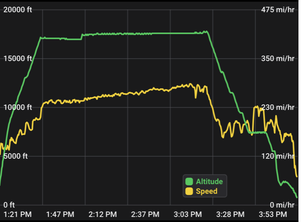

Ian Posted March 19, 2023 Author Share Posted March 19, 2023 The graph shows a defiant which is NA and while the rate of climb is slowing it remain adequate up to FL180. On 18/03/2023 at 6:47 PM, facthunter said: Light aircraft do not have adequate de icing systems at all except from carb heat. Prop ice can make it impossible to read the instruments due to the vibration. You have to find warmer air and quickly or be sure of being able to stay clear of cloud or any chance of supercooled rain drops falling... Nev Agree completely on the risks associated with icing, weather and the lack of effective mitigations on GA aircraft. It's somewhat ironic that on planes where rejecting heat is often an issue that the cold is a problem in other areas. Link to comment Share on other sites More sharing options...

facthunter Posted March 19, 2023 Share Posted March 19, 2023 There's nothing more boring than sitting at high Levels and moving as if you're stopped. You just won't get UP there either without supercharging and the OAT will require cabin heating. Nev 1 1 Link to comment Share on other sites More sharing options...

Ian Posted March 19, 2023 Author Share Posted March 19, 2023 12 minutes ago, facthunter said: There's nothing more boring than sitting at high Levels and moving as if you're stopped. You just won't get UP there either without supercharging and the OAT will require cabin heating. Nev I agree that it might be a little monotonous, however the image posted earlier is a NA plane climbing to 17500 pretty easily and if you're going from point A to B you might be willing to accept the monotony. The longez service ceiling is 27000 feet which is also a naturally aspirated plane https://en.wikipedia.org/wiki/Rutan_Long-EZ Cabin heat or being impervious to the cold might be a good idea. Zooming along at low levels is a lot of fun however there are risks associated with not having altitude. Altitude also gives you more options especially if you're flying over unforgiving terrain, your options increase at the square of your altitude, Low = Increased risk. 1 Link to comment Share on other sites More sharing options...
facthunter Posted March 19, 2023 Share Posted March 19, 2023 At the level you quote the engine would be delivering about 30% of its max sea level power.. Nev 1 Link to comment Share on other sites More sharing options...

Ian Posted March 20, 2023 Author Share Posted March 20, 2023 36 minutes ago, facthunter said: At the level you quote the engine would be delivering about 30% of its max sea level power.. Nev Yes I understand physics, however I was simple responding to the comment that 1 hour ago, facthunter said: You just won't get UP there either without supercharging Which wasn't quite correct, yes you'll have less power however some piston naturally aspirated planes have high ceilings and do get up there. Link to comment Share on other sites More sharing options...
