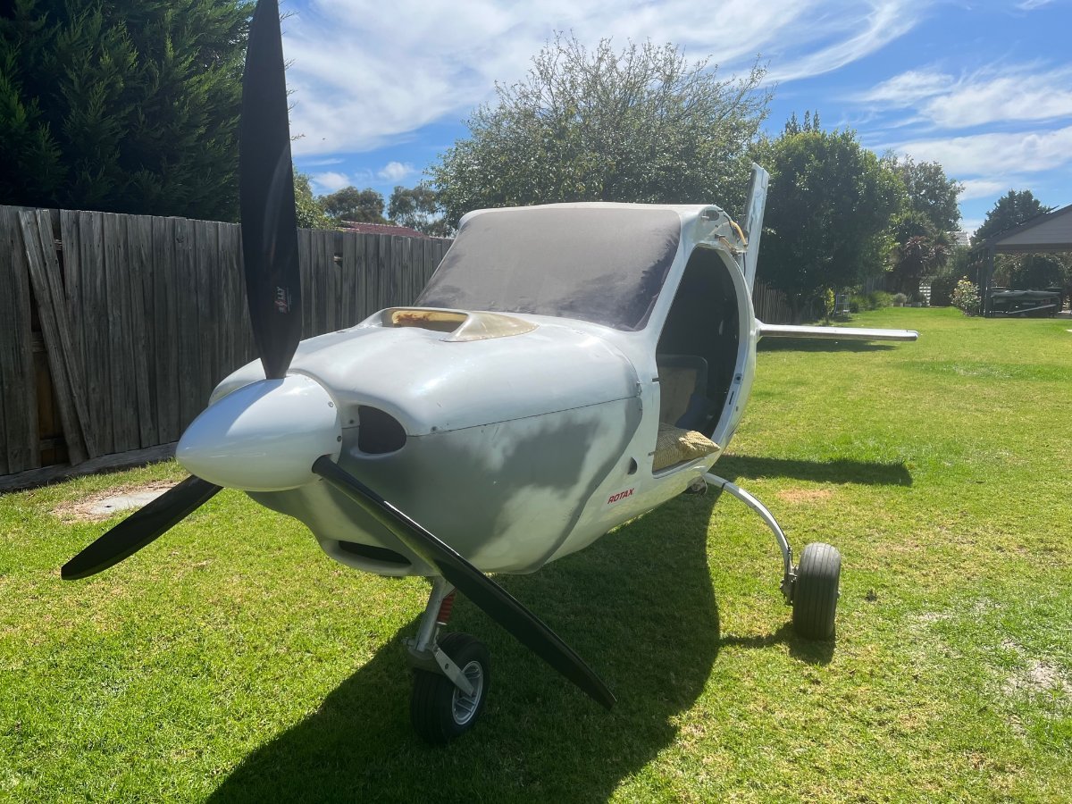

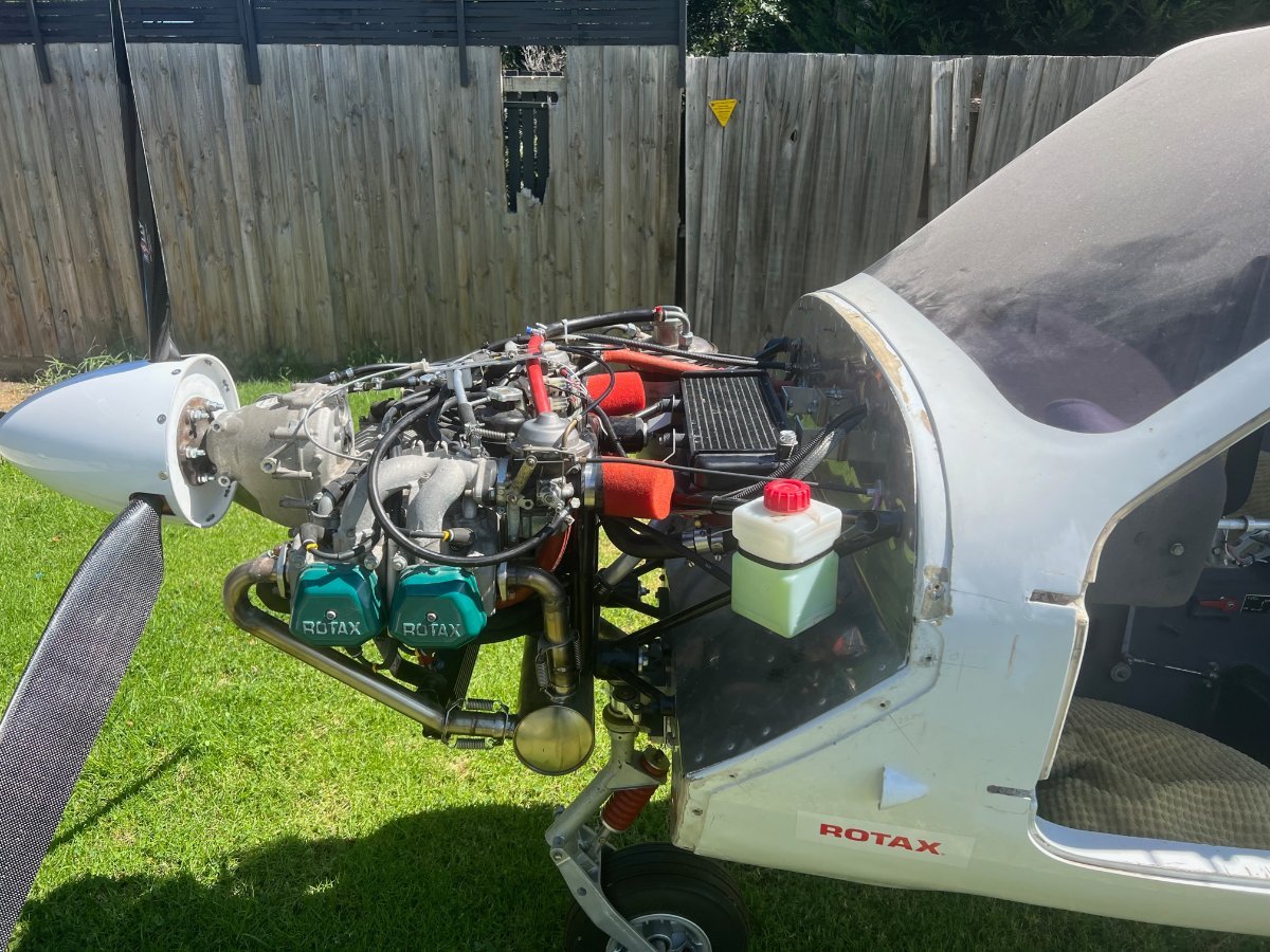

GolfWhiskeyHotel Posted April 24, 2023 Author Share Posted April 24, 2023 RE: Rotax/Jabiru 160C Well, things have moved along. The aircraft is finished and I'm on the road to MARAP. Unfortunately there is no other way. The weight and balance was done today. Empty weight came out a couple of kilos over the original 302, and the C of G is in the correct range. So things progress. AS the 160c is a Certified aircraft it has to follow the MARAP path. ( I really dont understand "Certified' and LSA, Why Certified? I can't follow it at all) I wish it were otherwise. I had no idea that the 160C was particularly singled out for this. RAA has been helpful so far. But, I WILL need examples of safe operation of a Rotax Powered Jabiru 160 There must be a couple around. Please raise your hand. Link to comment Share on other sites More sharing options...

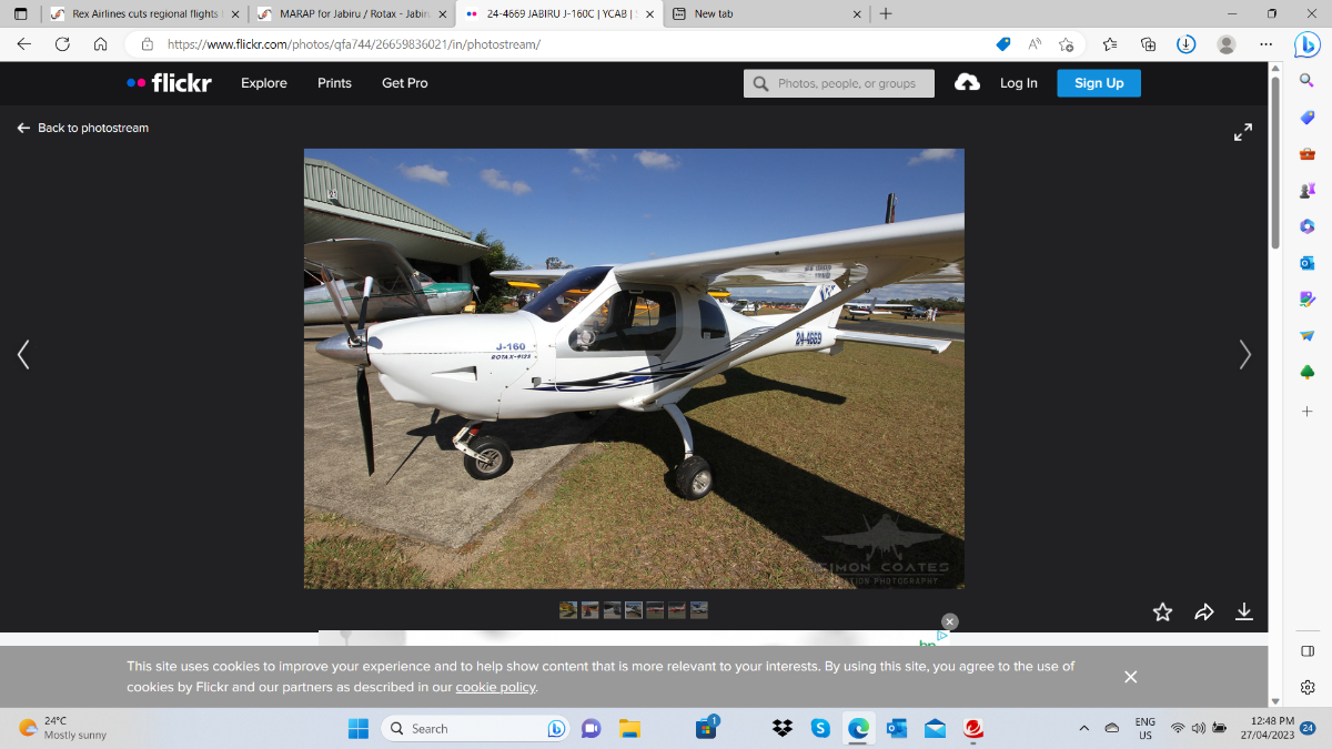

sfGnome Posted April 26, 2023 Share Posted April 26, 2023 (edited) I used to hire 24-4669 which was a Rotax powered 160. No idea where it is now, but if it’s still flying then it should be traceable. Edited April 26, 2023 by sfGnome 1 Link to comment Share on other sites More sharing options...
Blueadventures Posted April 27, 2023 Share Posted April 27, 2023 21 hours ago, sfGnome said: I used to hire 24-4669 which was a Rotax powered 160. No idea where it is now, but if it’s still flying then it should be traceable. May be at Caboolture, a rego check with RAAus may say. Link to comment Share on other sites More sharing options...

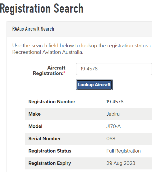

440032 Posted April 27, 2023 Share Posted April 27, 2023 Surely RAAus knows of Robert's Jabiru 170 19-4576? Link to comment Share on other sites More sharing options...

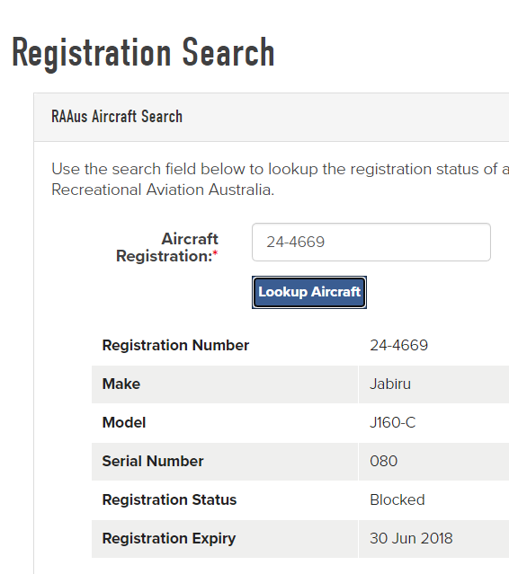

RossK Posted April 27, 2023 Share Posted April 27, 2023 Link to comment Share on other sites More sharing options...

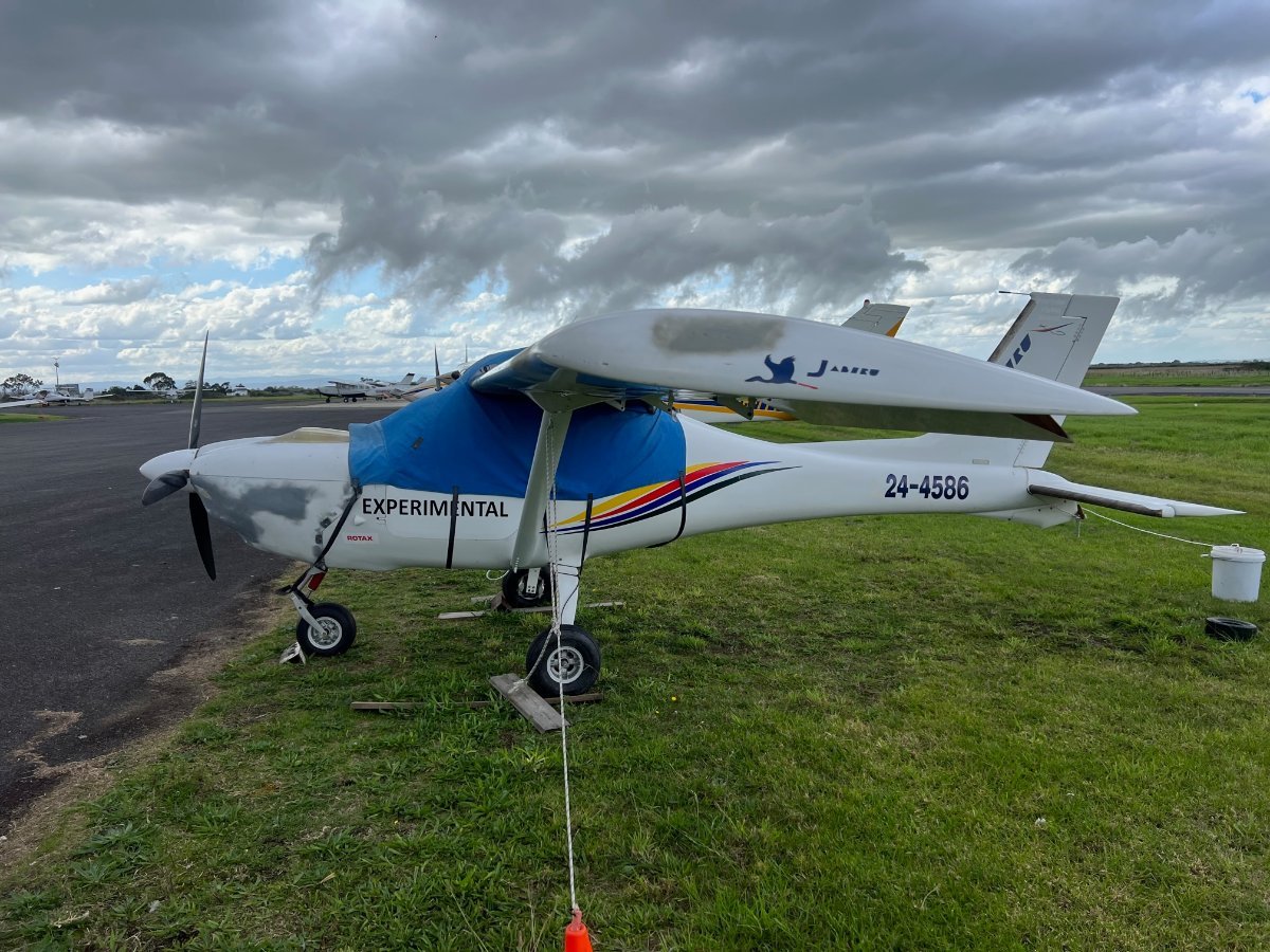

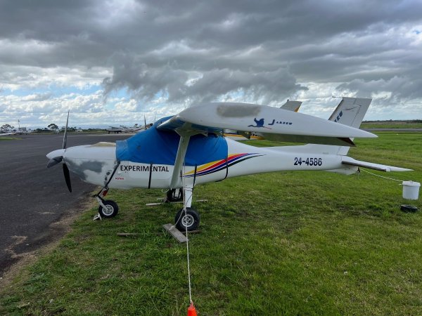

GolfWhiskeyHotel Posted April 28, 2023 Author Share Posted April 28, 2023 Thanks everyone. I have a couple of numbers to work with. Although I would have thought that RAA would have known who has the Rotax powered Jabiru's. The aircraft has an "Experimental" sticker on the side. I stuck the decals on in anticipation of E reg. When I try to remove them the paint comes off!!! 1 Link to comment Share on other sites More sharing options...
tillmanr Posted April 28, 2023 Share Posted April 28, 2023 GWH, have you tried warming the decals with a hair dryer. It is normally enough to soften the adhesive. Don’t just keep the heat on a small spot rather gradually warm up maybe half the word. 1 Link to comment Share on other sites More sharing options...

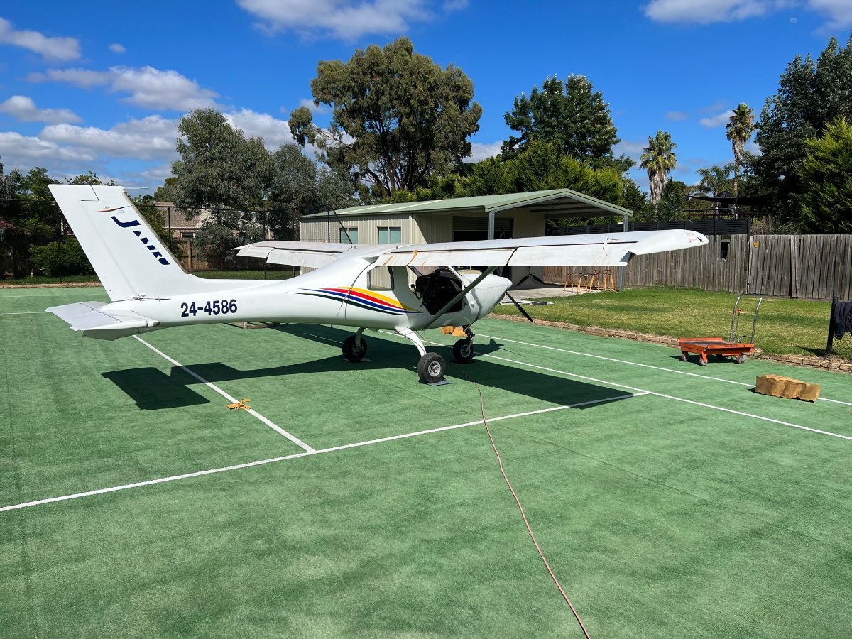

GolfWhiskeyHotel Posted July 29, 2023 Author Share Posted July 29, 2023 So Far So Good IMG_5721.MOV 5 Link to comment Share on other sites More sharing options...
