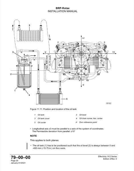

rodgerc Posted March 23, 2023 Share Posted March 23, 2023 Rotax installation manual is very specific about the height of the oil tank in relation to prop shaft. When I queried the detail with Flood Imports I was advised it was to avoid hydraulic lock from the tank being mounted too high. Link to comment Share on other sites More sharing options...
