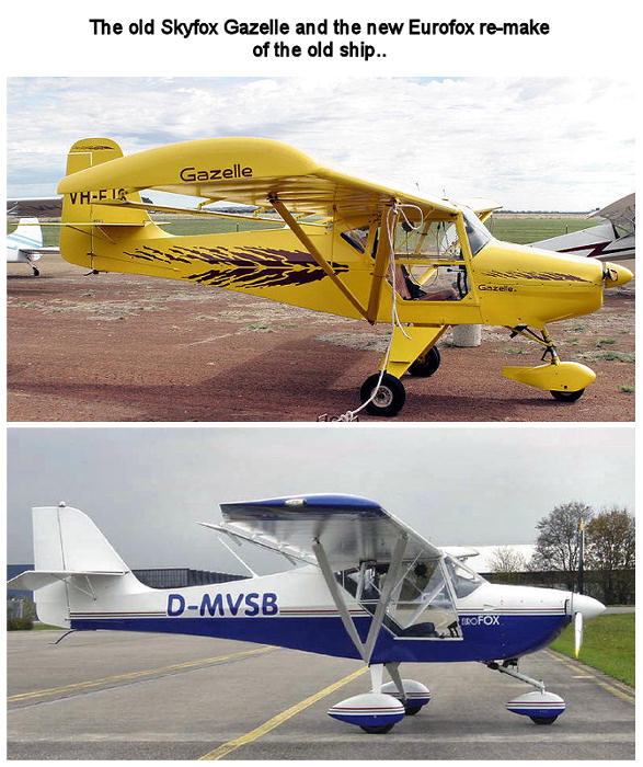

I note the Gazelle’s days a numbered due to a number of reasons however I see a European company has taken a lead in this area and produced what appears to be totally upgraded version of the Gazelle calling it a Eurofox. (See photo comparison below). This does seem be quite a major re-make and it’ll be interesting to see if any make their way out here to oz for training, etc.

G'Day Rodger, I hate to shatter your allusions, but I did point out elsewhere that the old SkyFox is really a copy of the American 'Denny' KitFox (the MKII to be exact)Around about the KitFox V, 'SkyStar' (the newer parent company) introduced a tricycle U/C, and called it the Vixen.The mob up at Caloundra saw this and adapted the nosewheel to the SkyFox and called it the Gazzelle. 'SkyStar' got as far as the KitFox VII before going bust againThe EuroFoxis just another copy, of a copy, of a copy, and so on. As you may have guessed, I'm no fan of the Skyfox, especially after having to repair a few of them.You may notice insurers don't like them either, mainly because of the repair costs.For example, a typical accident for a SkyFox (no a Gazzelle) is a ground loop.This could be blamed on the shorter fin and rudder than a Gazzelle, but either way the damage was usually a collapsed U/C (it is a bit weak) a broken prop, some cowl damage and often some cracking back near the fin post.The annoying bit though is that most of the time, the a wingtip hit the ground, and most of the aileron hangers would break off!That would seem bad enough, but if the wing hit hard enough, it could bend one of the spar tubes, and when that happens....You throw, the wing, away! The amount of work required to replace either spar tube was more than the wing was worth!I don't know what you would do now? My other gripes were basic ones like, a cramped cabin, small doors, a hot cabin, having to duck under the wing in flight to see where you were going, always guessing how much fuel was really in the tanks, the leaking hydraulic brakes, the fact you could apply full rudder or full brake, but not at the same time!Other than that, they seemed nicely built, had attractive upholstery and had folding wings!Sorry if I've crushed anyones dreams, but I can only tell it as I see it.C'mon Howie, lets get more Lightwings out there! Arthur."Now where's that fireproof suit?"
