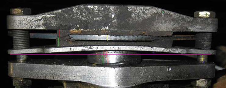

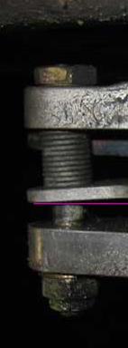

Tomo Posted October 16, 2008 Share Posted October 16, 2008 It looks to me that the glue stuff that the pads consist off reacted with the heat and wore down very quickly, that's why there is bits of pad glued to the rotor/disc... Ah...;) I think I just found his problem.... It's a moving head caliper, right... Take a close look at the springs on the bolts to make it spring apart once it's released... well the spring has closed up to it's maximum ability, which didn't allow the other side to move in (the side without the piston), so cause the piston side to go out farther to compensate which in turn bent the plate with the pad on it.....and pooped out the O-ring.... I'll attach a zoomed up pic of the spring that's closed up to it's maximum ability... What do you all reckon....??? Cheers, Link to comment Share on other sites More sharing options...

Tomo Posted October 16, 2008 Share Posted October 16, 2008 Either that or he just held them on lightly, before he actually needed to use them... It's just like driving down a hill in your car, you don't ride brakes all the way down, you use them firmly and in short amounts... that is probably how he got them hot, but that's not the bent plate and O-ring problem, that's for certain..... I wonder if it happened to both sides?, I didn't see any where that he mentioned of anything like that, did you? Cheers, Link to comment Share on other sites More sharing options...
Guest brentc Posted October 16, 2008 Share Posted October 16, 2008 It's pretty simple really, the brake pads are stuffed and should have been replaced long ago. Add to that that the bolts weren't tightened as the brake pads wore out thus allowing the pistons to over extend and allow the o-rings to catch because the pitson didn't come out evenly. The second pic from the left and the bottom left pic clearly show the rivets are flush with the pads which means they are worn too far and the rivets are scraping on the brake discs. This highlights the importance of PROPER maintenance by someone who knows what they are doing! Link to comment Share on other sites More sharing options...
BigPete Posted October 16, 2008 Share Posted October 16, 2008 Spot on Brentc. :thumb_up: regards Link to comment Share on other sites More sharing options...
