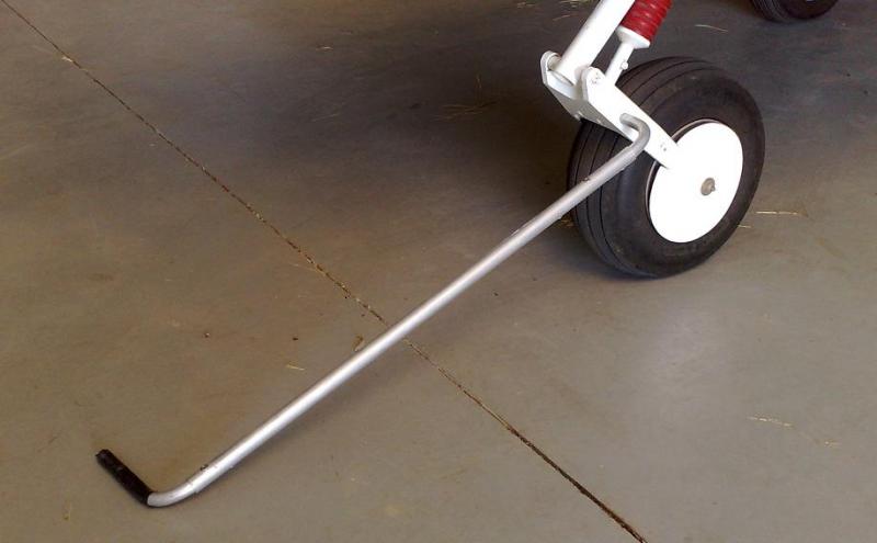

Well, If you must have a tow bar, then a tow bar you shall have. There's one out at the aero club (for a Jabiru). I'll take a photo of it today and post later.

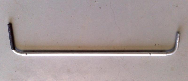

Ok Pete, here it is. Very easy to make. :thumb_up:
1. Solid aluminium rod bent thru 87 - 90% (I think it's half inch, but you better check) x 2
2. Aluminium tube to fit handle and puller internal dia of half inch x 36 inches long.
3. Join with pop rivits and shove on rubber grip at handle end.

Jab Towbar
BigPete, thankyou very much for this information. I appreciate the time and effort you put into this. It looks a very simple arrangement to put together. I will do some checking of the sizes, Hope to catch up with you next time I am in Echuca, once again thankyou,
