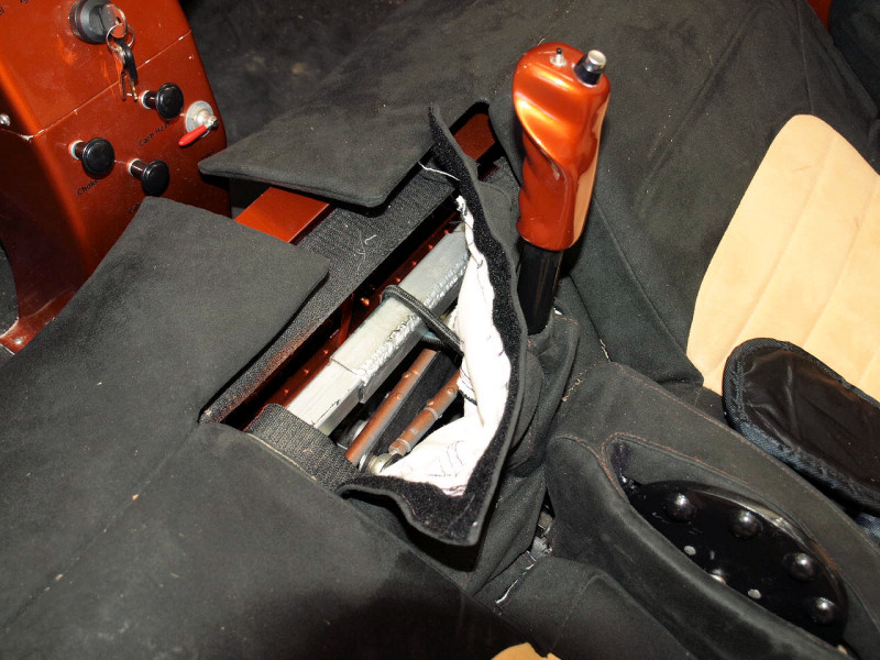

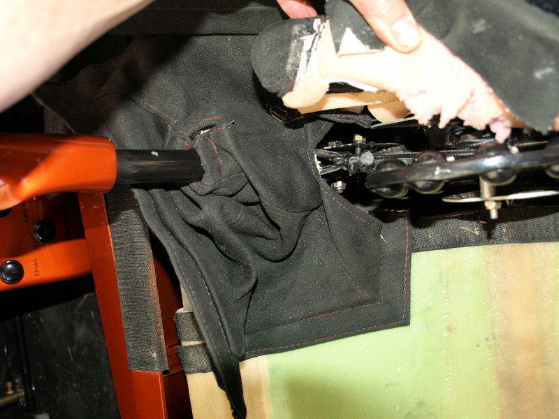

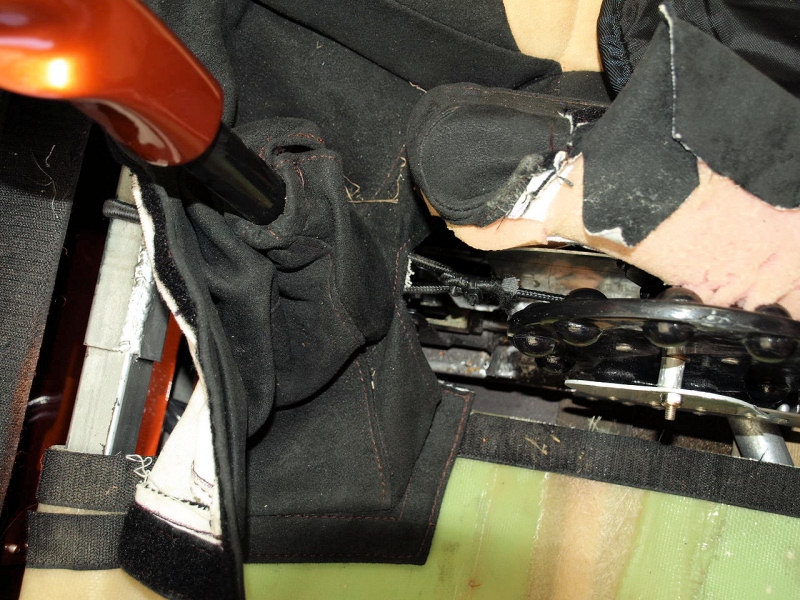

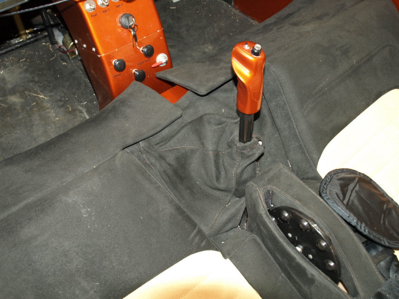

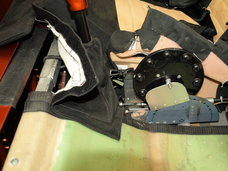

slartibartfast Posted March 18, 2009 Author Share Posted March 18, 2009 Slarti,Please excuse my lack of knowledge but you mentioned trim with bungies? How does that work Here you go BLA82 and Doug. Snapped a few of the bungie trim arrangement. You've made me notice how dirty my floor is. Time for a vacuum. [ATTACH]7386.vB[/ATTACH] With everything in place. Turn the wheel for elevator trim. [ATTACH]7387.vB[/ATTACH] Just lift the velcro and slide the bungie left or right for aileron trim. [ATTACH]7388.vB[/ATTACH] [ATTACH]7389.vB[/ATTACH] You can see the spool. [ATTACH]7390.vB[/ATTACH] The arc and detentes were for the original lever. The holes were too far apart. Link to comment Share on other sites More sharing options...
Deskpilot Posted March 18, 2009 Share Posted March 18, 2009 Thanks for taking the time to photograph your setup Ross. Not real clear as to how it works but. Any good at drawing? Link to comment Share on other sites More sharing options...

slartibartfast Posted April 1, 2009 Author Share Posted April 1, 2009 Still don't see how the bungies work without changing the mid point of control and extra work load when going against it. I can see I'll have to do that drawing after all. There is extra workload, but the controls are so light you don't have to move far anyway. Plus the Cheetah doesn't need trimming for different phases of flight, although I'm still not sure how that works. Once the all-flying tail is set at an attitude, it wants to stay there. It's more a trim for weight changes (pax, luggage, etc.). Link to comment Share on other sites More sharing options...
