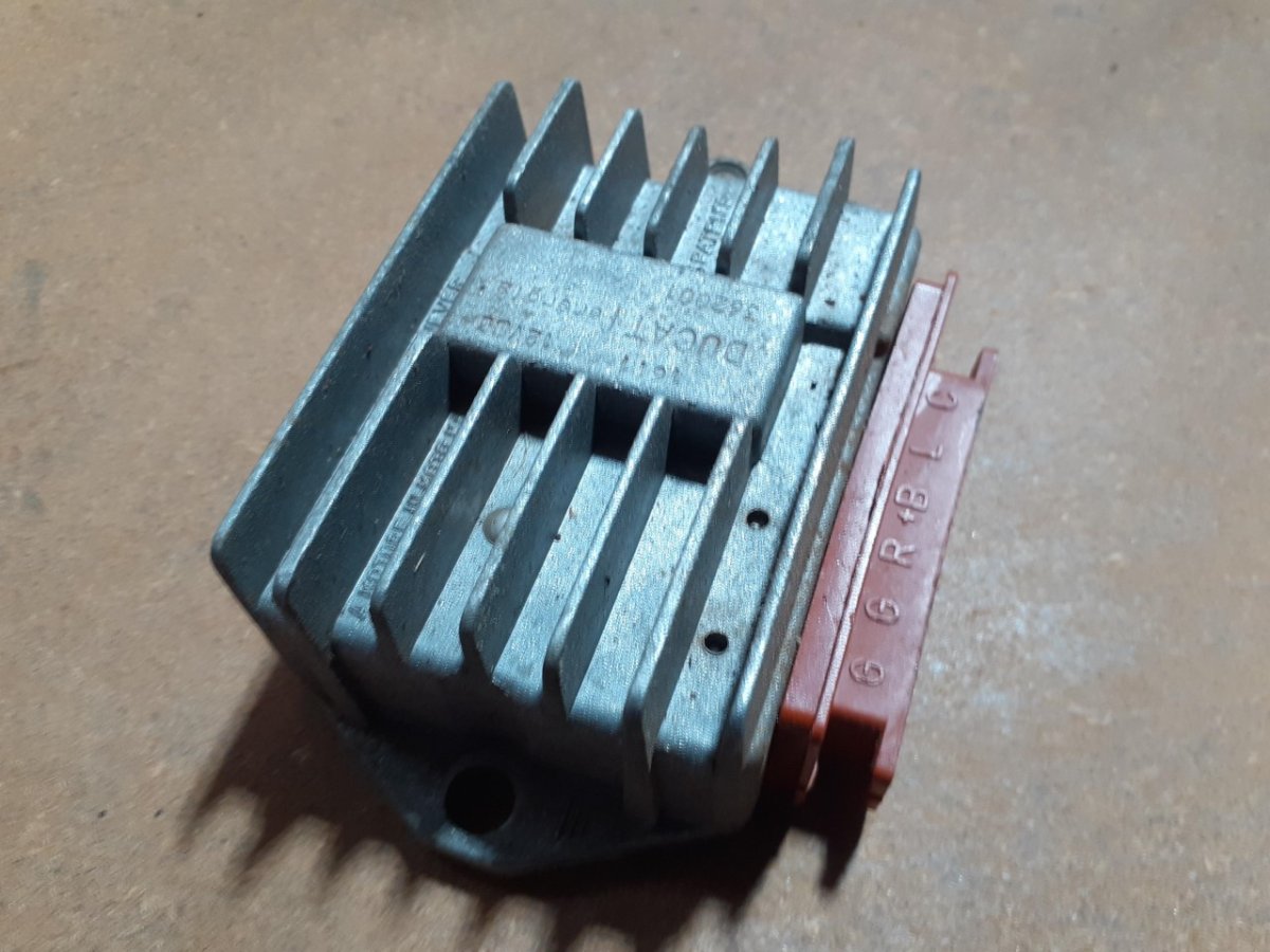

waraton Posted November 22, 2020 Share Posted November 22, 2020 On a slightly different matter, where can I get the 6 pin connector assembly for the regulator???? Link to comment Share on other sites More sharing options...

Blueadventures Posted November 22, 2020 Share Posted November 22, 2020 1 hour ago, waraton said: On a slightly different matter, where can I get the 6 pin connector assembly for the regulator???? Bert Flood will sell and about $280 plus postage. Link to comment Share on other sites More sharing options...

onetrack Posted November 22, 2020 Share Posted November 22, 2020 Waraton - you might like to check out the thread below. You can buy all types of connectors (plugs and spades and bayonet connectors) from Alanco or Ashdown-Ingram. That means you basically have to build your connector yourself. https://www.sportpilottalk.com/viewtopic.php?t=4682 2 Link to comment Share on other sites More sharing options...
