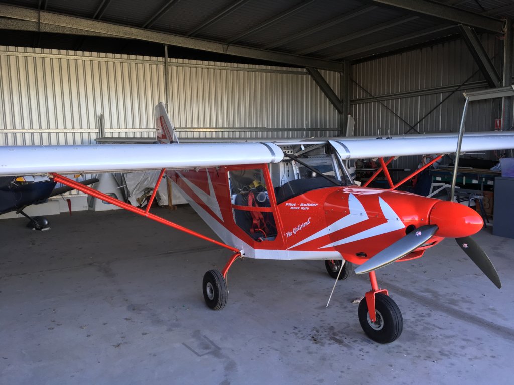

Kyle Communications Posted June 10, 2019 Author Share Posted June 10, 2019 Well sadly the time has come :(....its time to sell "The Girlfriend" If anyone is interested in this aircraft PM me or email me kylecom @ tpg.com.au If you have followed this thread for the past 8 years or so you have seen how she has been built and all the TLC in doing so. You have seen the mods done and the outcome. You have also seen what happened when the nose wheel decided to part company and what was done and how it was fixed. Also the mods done to make sure it wouldnt happen again and to improve other aspects of this great aircraft. I have had some awesome flights with her. She begrudgingly is being sold off to help fund the new one coming later this year "The Mistress" a Rans S21 Outbound and also a house being designed and built up at our farm that of course has a hangar big enough for 2 aircraft and the 2 airstrips. Dont panic though I love my Savannahs and will still have one as most will know by this blog My Savannah S model rebuild Blog This is "Mabel" and she is being reborn to be the one I fly until S21 is finished which will be some time away. Mabel has many other things done to her and also all the mods done on "The Girlfriend" so will be another evolution of my savannahs to make them easier and even nicer to fly. The Girlfriend is advertised on the RAA classified website here is the link if you are interested Aviation Classifieds These pages are a resource that I am very proud of as I believe it has helped a lot of others all over the world in building their pride and joy as well. I have received so many emails from all over the world about these pages and I hope it stays for a lot longer to help others in their builds. My rebuild blog hopefully helps others as well even though the S and XL models are really basically the same there are some differences. Please feel free to email me at any time if I can help with any issues or problems. Lord knows I have had issues in the rebuild as well and have asked for opinions and advice on it as well. No one knows everything and no question is stupid. We all want everyone to be safe and fly safe and thats what I try to do every day. Anything I find that is applicable to the XL that I find or fix or modify in the S rebuild I will update here as well Mark 1 Link to comment Share on other sites More sharing options...
Kyle Communications Posted June 21, 2020 Author Share Posted June 21, 2020 Well an end of a era tomorrow morning when "The Girlfriend" flys the coup to be with another man. She will be gone from my grasp but certainly not forgotten. I hope this blog and all its pages have helped others building their Savannahs. I have always put in here what I thought would be good and what was and what did not end up being so progressive. This thread showed everything..warts and all and I appreciate all those many many people who gave me advice while putting "The Girlfriend" together and also along the way of our journey for the last 9 years or so. I have also tried to make sure I pay it back to others and certainly feel free to contact me if you want any advice or opinions. First flight was 27th May 2012..my last flight was 5th of June 2020 so she has been flying for just over 8 years My current thread is My Savannah S model rebuild Blog this is where I have been rebuilding a wrecked "S" model. Pretty much all of the mods made and fitted to "The Girlfriend" have been put into her..... "Mabel" is this ones name. Plus a few other mods as well. Mabel isnt too far away for being painted then of course its the 90% to go to do assembly and fitout. Thank you to all who have spent the time to read this thread and added their valuable input. I have enjoyed this ride very much Mark Kyle 5 1 Link to comment Share on other sites More sharing options...
