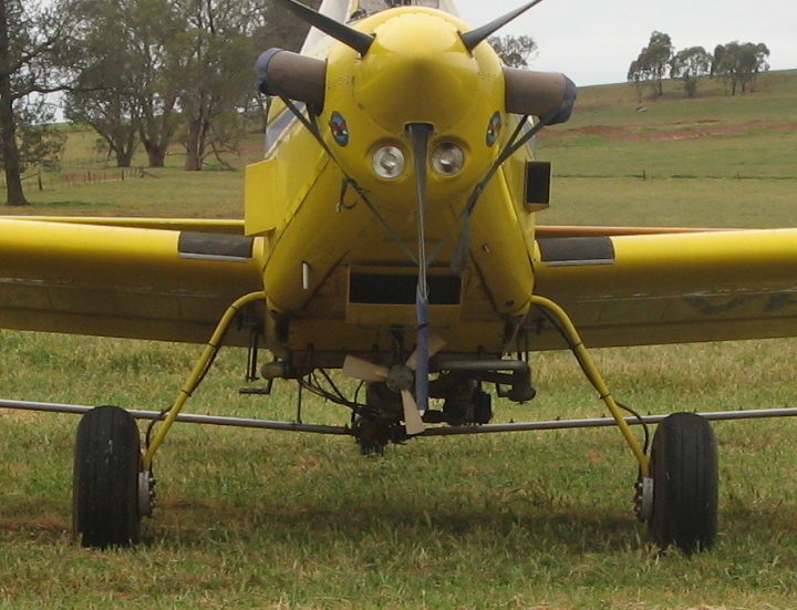

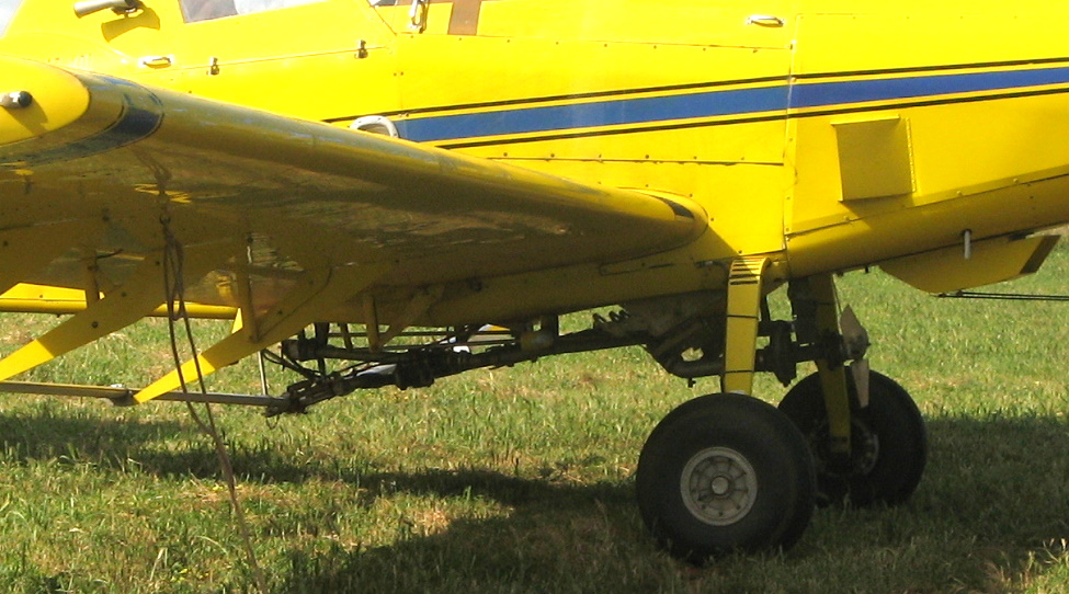

Powerin Posted June 15, 2011 Share Posted June 15, 2011 HI Maj, thanks for the information, never seen underneath the sprayers.. keen to see how it all works. You are right, lucky the wire broke , 1 km of conductor they are putting back up now. I will try and get name and type of aircraft he was flying for you.. Will PM the details . Dave Here's a couple of pics of the underside of an Airtractor (AT-402). As you can see there is a small 3 bladed wind turbine that drives the centrifugal pump. On this AT the turbine sticks out ahead of the undercarriage legs so you could see how it might get damaged in a wire strike. This particular aircraft also sported some nice power cable shaped indents on the leading edges of the wings. I seem to recall the undercarriage legs on a Turbo Thrush are a bit different from this. Link to comment Share on other sites More sharing options...
