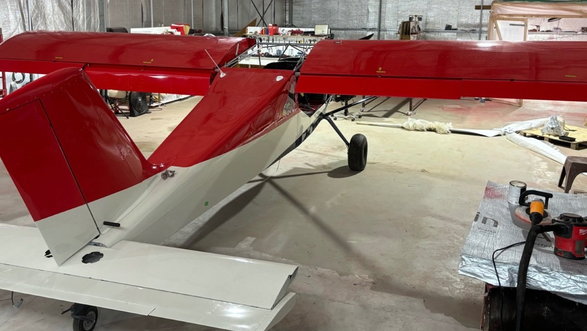

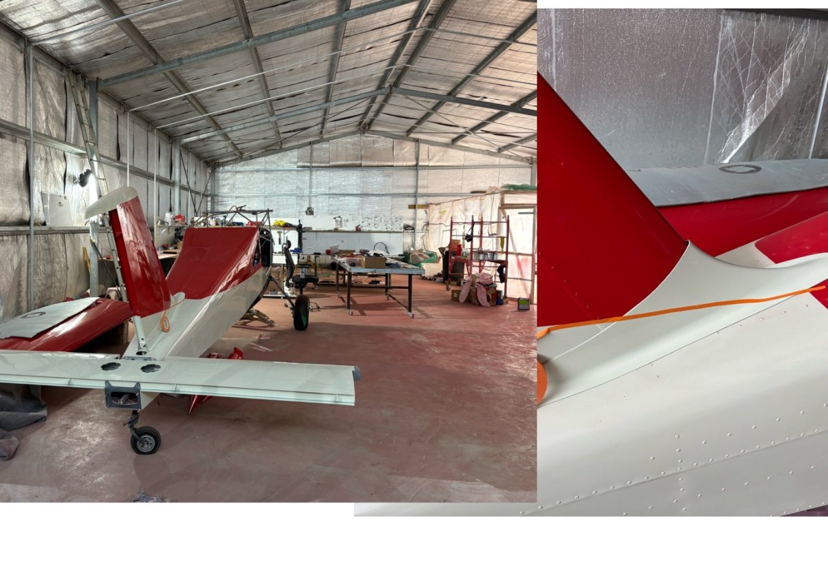

  6. Aircraft 2. We have motor and avionics sorted. Tomorrow is taxiiing and going through the avionics on the G3X such as checking radios, magnetometer etc. Big deal to close the boot cowl and limited access to the wiring. So, getting it as right as possible now is essential. whirlwind prop is a drama. I’ll post about that once sorted. We’ve had some failures in S21’s related to the 3/8th bolts. It’s a bit like the Jabiru saga with 3/8th and upgrade to 7/16th. I’ll start with the 3/8ths and expect or hope for an upgrade kit with 7/16th prop lugs and bolts. After boot cowl closed we are onto windscreen, sunroof and engine cowl. That’s it. So… maybe 4-6 weeks to flying subject to paperwork. 5kw wind turbine to follow. Aircraft takes priority over the turbine patent. Pic yesterday front and back and picking up Deb for a trip in the RV6. The cows hardly move for take offs and landings. Have to sort of land between them. Cow poop on the new aircraft will be annoying. But.. when going away such as trips back to USA I realise how damn good it is to have your own runway and just wheel it out and be in the air in a few minutes. Warm up is the slowest part of proceedings.

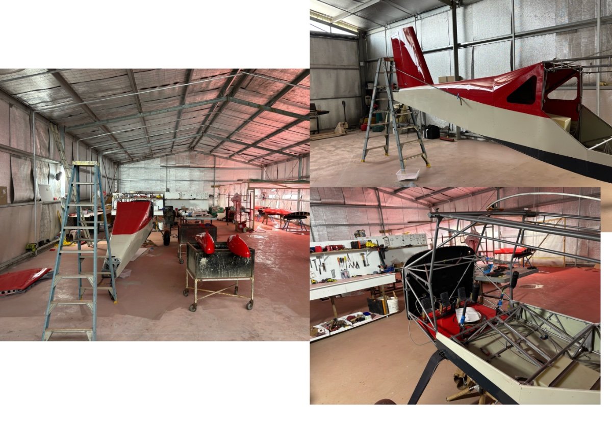

  8. Aircraft 1 First oil change at 15 hours. We can now do the extensive test card work. Would have been today if the wild weather wasn’t a problem. We debate speed at 2650rpm 9500ft. I’m thinking 150 knots. Will report back with actual data/ video. Aircraft 2 Doors mostly done. They are just as painful as everyone says. Really should be a polycarbonate moulded piece. I guess the fact that Rans would have to make left and right tools is why it isn’t done. Getting the center where the 2 pieces meet over the door bow isn’t fun. We know of one lower panel blowing out in flight so I’ve added UHB tape under the polycarbonate where it’s specified to go on top. I’m also going Sika on top before putting on the aluminum strip. It’s not going anywhere! I’ve planned from the start to add the upper flap lever. It’s the only spot on the aircraft I’ve gone off script. The mechanism is exactly copied from Rans so nothing new going on in the ratchet mechanism. It’s proven so why mess with it? The change is just upper mount and reduced range of travel from 90 degree to 45 degree. Ready to go to laser cutter and the 3d printed console with room for iPads, maps etc, iPhone and drink bottles needs a little refining before going out. Advantages. real estate at center of seats is now fully usable. headphone jacks come from the upper cross piece. headphones have a hangar for each. 4 point harness mount points now provided. ‘’It all mounts off the seatbelt rear connect point so not an issue for seat belt security. If anything it’s just a little more forgiving in that the cross piece would bend a little in use. We do hope to never test this.

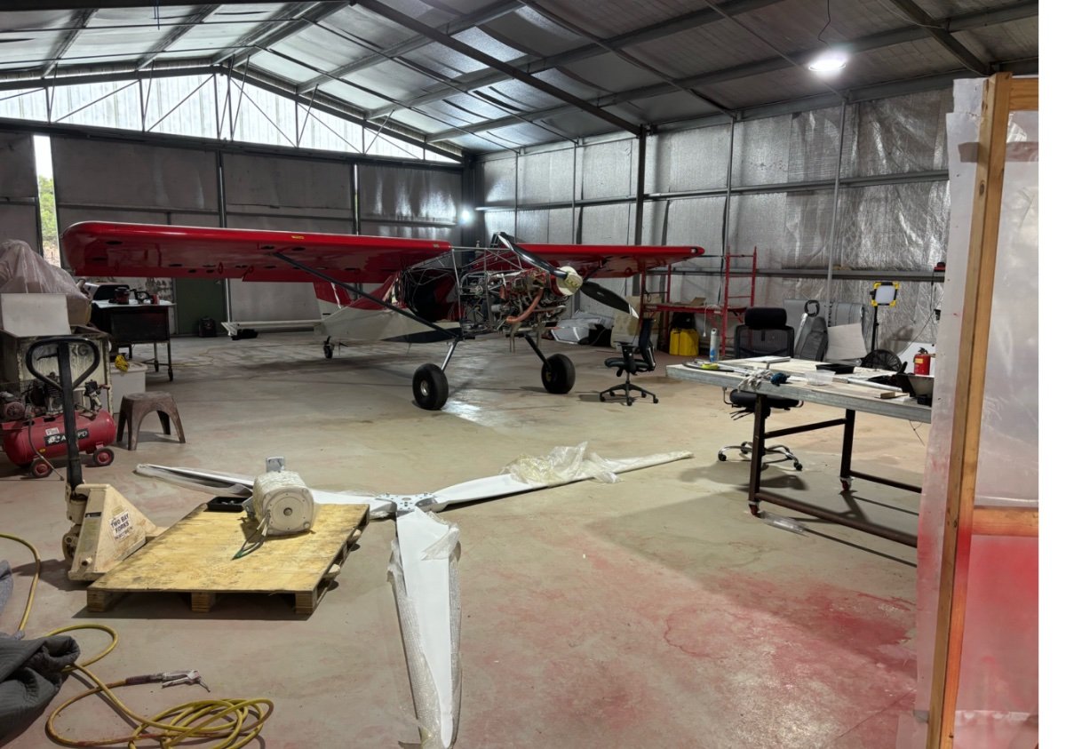

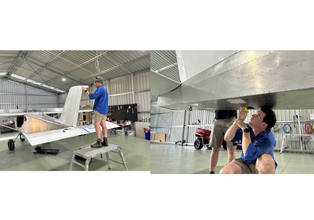

  12. Aircraft 2 has the engine mounted and avionics are near finished. Nic is a work maniac as I think I’ve mentioned. I have to get down to hangar by 7am or he’s beaten me to it. I take a break at lunchtime and a little siesta then comeback and often Nic is still there and worked through. I don’t think he’ll be back for the more mechanical stuff and he’s a bit over the avionics and just wanting it finished. Still, I appreciate the help and very grateful he’s giving me time. Deb is top left. She’s lost 50lb last 4 months (American so she loses lb’s). Only started flying with me recently and happy to come into Tyabb but not so keen on the island runway landings between trees, birds, cows and the uneven ground. She’s surprised herself by looking forward to the Rans being finished and going on adventures. It’s heaps more comfortable than the RV. The seats are like armchairs in comparison and the big tyres make my runway feel smooth. Those things along with the slower landing speeds will really help her confidence in flying with me. Job today is antennae’s so Nic doesn’t run out of things to do. Then onto wiring the light speed ignition in. After that the big jobs are wings on (we learned from first aircraft… don’t put the wings on early. They are just in the way) then skylight, windscreen, prop and engine cowl. After that it’s flying and trying to keep up with Nic.

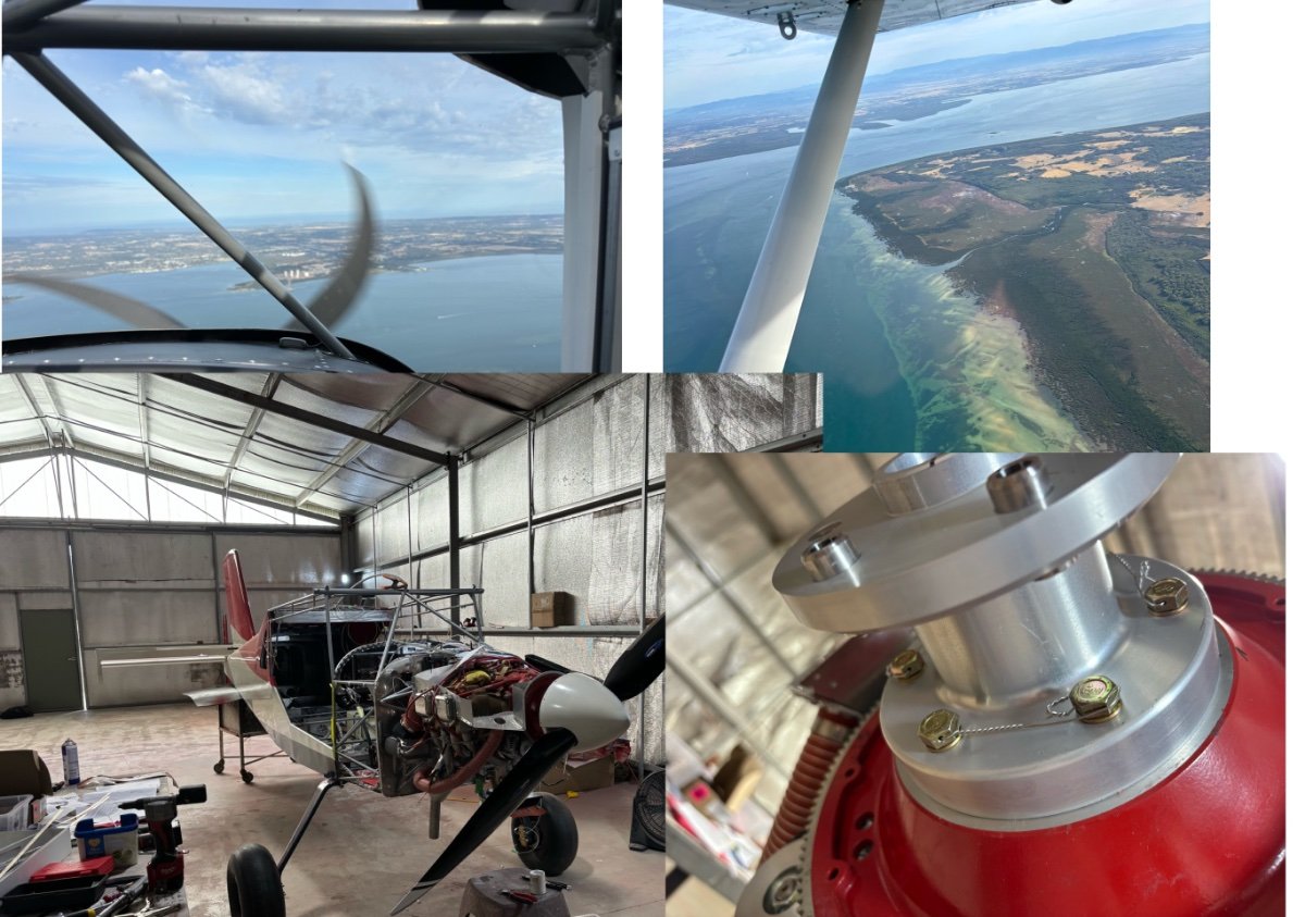

  14. Finally I can report on the S21 with UL520t We have 140kn TAS cruise at 2700rpm 1500ft. We also have stable oil and CHT temps. Game changer was talking to Steve at Sensenich this morning. We moved 2 degrees past the maximum gauge setting of 7. Each gauge is .7 degrees. So, we are at a ten. Static is 2150rpm and as you’ll see in video it’s almost spot on 2700max in the air. About 2300climb out max rpm. So, we’ve gone from a frustrating overrevving overheating 115k aircraft to the aircraft we thought it should be. Up high TAS? Maybe 150kn. Pity the American and Australian UL distributors aren’t more personable. The Australian guy suggested we f&$k off when we first visited. That should have been the red flag we ignored. The American guy is nicer with communication problems. UL Europe and UL Dutch guy in Florida USA are really good so it’s not all difficult people
